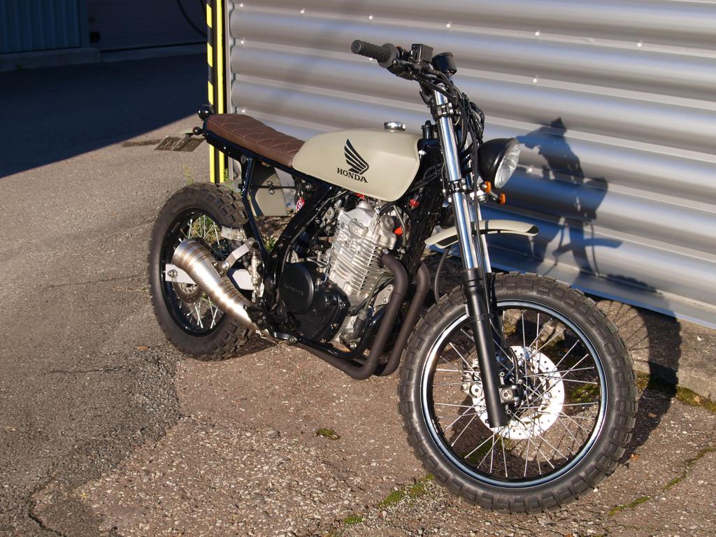

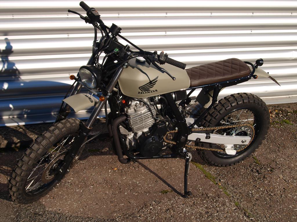

New Shindengen reg/rec installed, works like a charm. Here are some better pics:
Re: Honda NX650 Dominator tracker - DONE!
Well done tort. Love the color, I didn't realize it was a beigey brownish color until the last set of pics. The sun really brings it out. Nice job on the exhaust also!
