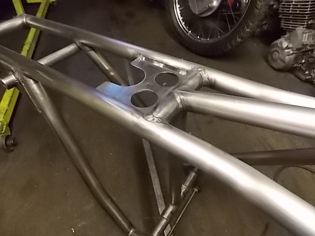

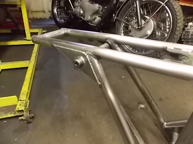

I'd been getting problems with the headstock distorting as it was welded....whichever sequence I tried it always moves a bit one way or the other....and having it pulled straight after isn't the nicest thing to do to a frame! It finally occurred to me (after a year or so!) to do the headstock welding but leave off all the welded gussetts that brace it....then have it motolined....then finish the welds....much nicer.
