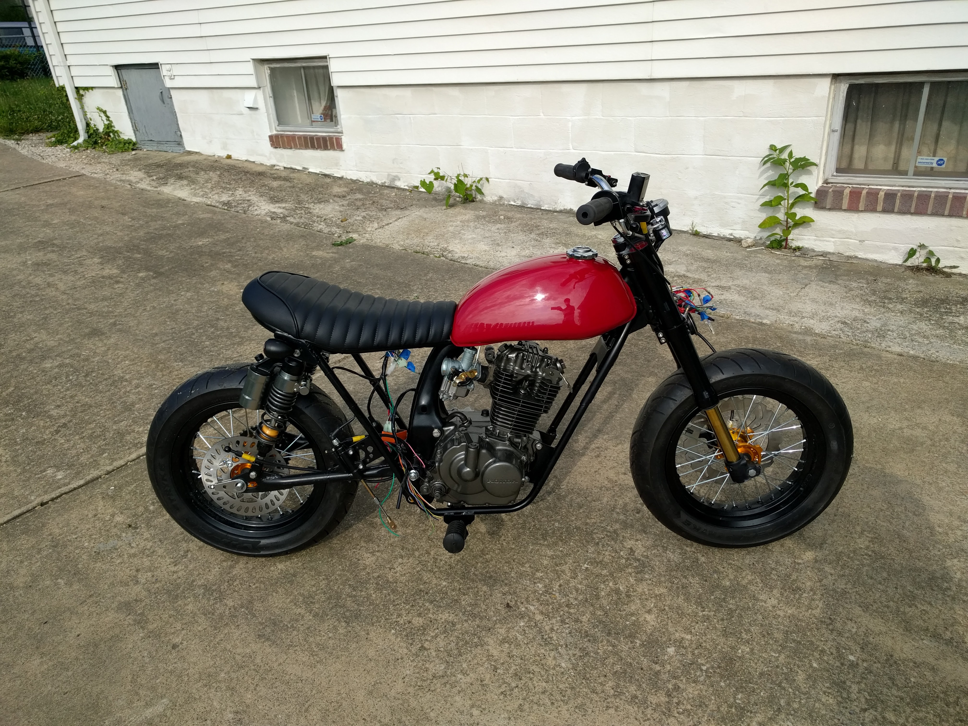

Starting to get down to the last few bits.
Tank is painted, I went with red (pics next time)
Seat is nearing completion (anyone know a good upholsterer in the B'more/DC area?)
Rear wheel aligned and spaced and calipered
Wiring in and mostly hooked up
I am 6'1" so here's a few pics for scale

Re: Honda SL200 Mini
Starting to wrap things up, just a good deal of reassembly and tweaking.
Its really small when you're up close or sitting on it. Yet, feels to be really solid and rigid, not like the shock are oversprung, but that there's no flex in the frame or front end or components.
I hope I can say this with out getting in trouble with Ichibon, but...."Bad Ass" ;D
Looks like it's going to be a blast to ride. Did you do that seat yourself, it looks great.
It is a really fun ride. I haven't done a top speed pull yet, but i've had it to 70 and it seemed like there was more left in the bucket.
I did the pan and foam while GS Upholstery in Millersville, MD did the tuck roll.
