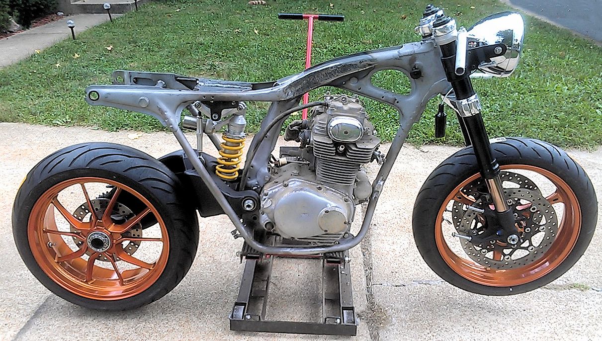

Rolling chassis photos.
I still have to weld on the outer swing arm plates. I wanted to set it up as a roller to fine tune the shock placement before committing to the location of the outer plates. As it sets, I was 0.75 of a degree off on my fork calculations. I can easily remedy this with the Ducati ride height adjustment.
The wheels scream REPSOL for some reason. LOL. Unintentional. Or perhaps KTM.
