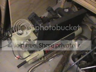

Hey JRK I upgraded my aircompressor I have one of those with two long cylinders and has a two cylinder compressor motor its 8 cfm @ 100 psi. Will that be strong enough for the 20 harbor freight sandblaster? Will google around to find a booth DIY.
ahhh now that i do not think... i have a 35 gallon i use at 150 psi... even that gets weak... i say screw it man! try it! even if you have to let it keep filling it cost you nothing to wait for it to fill... alot cheaper than paying someone to do it... ill be building my blast booth soon as well.. the little one is not cutting it any more and i have a buddy that wants to buy it!

Thanks CCRider that is one slick set up definately gonna use ur idea. So is it the size of the tanks you think is small or the PSI to week JRK? I've always had a hard time understanding compressorS and wether I need high PSI or large tanks. I was real happy when I got this one. Its an ETQ.
PSI is going to be the big issue... the size of the tanks just mean you will get about 3 min of spray time then have to wait for it to fill again. you can always get larger tanks though, just run a line to fill them...
