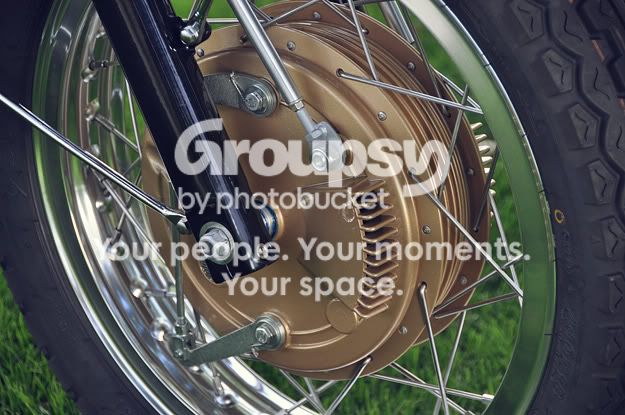

I am wondering If I should do my hubs like this.
I just dont know how to make them look like that, If you can get them dipped, or PCed.
and I am wondering if this would look stupied because I have just a hub in the front, My wheels are going to be chrome spokes brass nimples and gloss black rims. I am painting my tank British Racing Green. I am trying to picture it, and think this would be cool and original.
I would appreciate any feedback and thoughts on this, Thanks

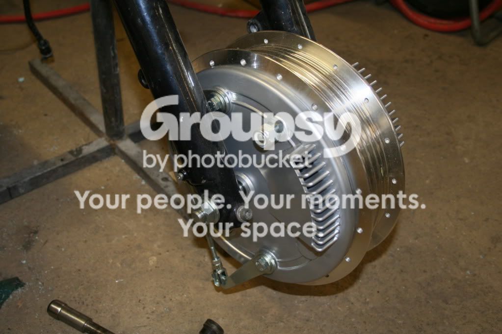

The top one looks to be electroplated. The bottom one looks powdercoated.
Copper plating on aluminum is quite easy, and there are chemicals that can give copper a bronze-like patina.
Yep, the top looks to be the cadmium plating that they used to use on brake parts in the 60s and 70s. A pretty cool reproduction item you can get is a cadmium restore kit from eastwood. Been wanting to try it on something.....
http://www.eastwood.com/new-golden-cad-system-w-diamond-clear.html
It's a 3 step paint process in aerosol that looks awesome to me.
It's a repo of an Italian drum - Fontana or Ceriani I suspect. They were a magnesium alloy known as Elelktron IIRC and they had to be dipped in a chromate solution to prevent corrosion and cracking. That repo is probably a passivated zinc or something similar.

Awesome, I should be getting this done then, hopefully it doesnt costs and ass load but either way I will make them look like that. Thanks for all the responses, so its just cadium plate magnesium? or like the drum is magnesium and wont work with aluminum? This should be a nice touch to my bike thanks again

The lower hub is a Grimeca - readilly available new in the UK [ and elsewhere no doubt ].
That is a factory standard finish - they also came in SIlver [ see attached ] and "raw".
There has been a policy change and now all centres come polished and it's just the brake plates that are powder coated.
When we ordered ours for the TR1 projects, they only had Silver ! Garage Rat sent a pic of an excellent process [ Gold ] which was acid etched [ I think ] and and then the Gold process applied. Damn my memory, I'll go back and check what he said !
ACID ETCH AND ALODINE COAT.
At the time we were looking at the process for the RAM twinshock kits, but here in the UK it was looking skywards with a sucking of the teeth when we enquired.
That said, I think it would be spot on for hubs / brake plates and more practical than powder coating.
BTW - I wonder if the owner of the bike with the Grimeca ever heard of the engineer / mechanics rule of at least 1 1/2 threads showing through a nut? Especially Nylock or similar.
