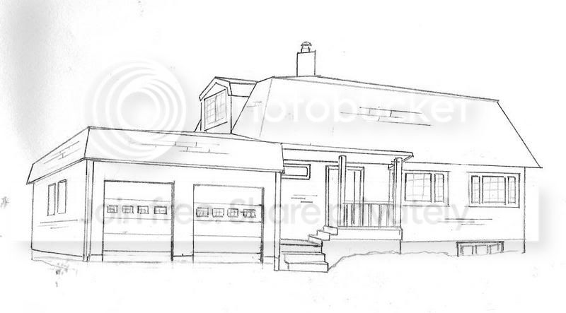

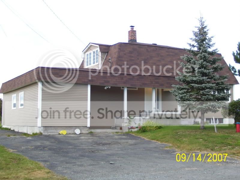

Here's our big project:
And why it's worth it:
Take THAT Toronto! :D ;D
CanadaDan said:
All that land and only ONE garage stall for the bikes? :o
TRIPLE!
Hahah, yeah for now. The truck doesn't live there, it was just in there the night I brought it home. ;D
Plan is to put up another shed in the back with fans for painting. 8) 8)

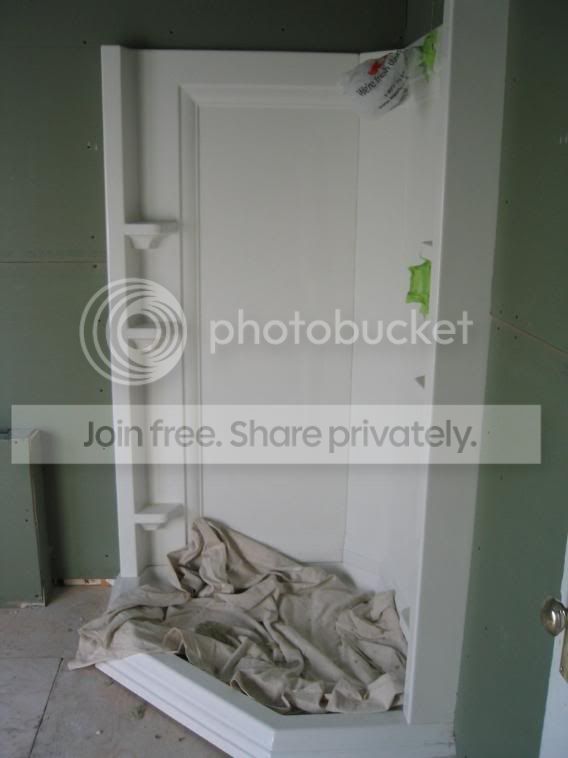

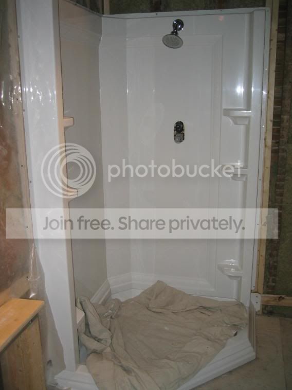

Well, the meds are kicking in and my right arm is beginning to feel a little better. Today while lifting the shower walls into place, a long nagging injury in my right forearm finally went over the brink, and I tore a bunch of muscles in my upper and forearm. I actually heard them rip, which wasn't pleasant. My hand immediately collapsed and thankfully we didn't drop the shower too far. No damage (to the shower).
Drywall is mostly up, and the shower is finally in. Will take pics. Looking good and will finally be able to shower for the first time since last Wednesday (been borrowing friends facilities ;))

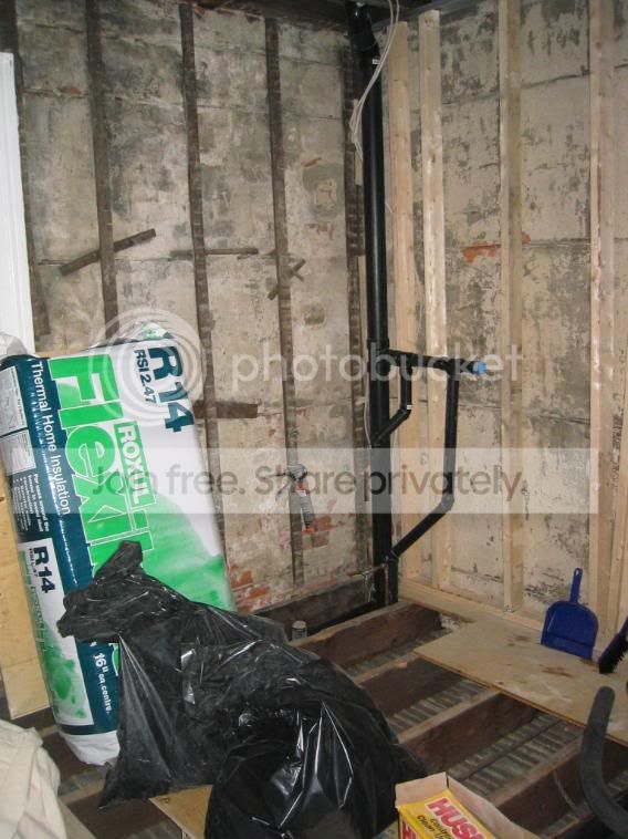

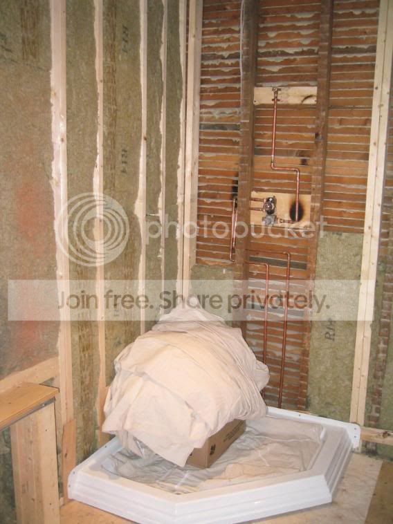

Missed this earlier - the black pipe is ABS plastic. I actually do have two main stacks in the house. The original iron pipe (which is great - it makes no noise) in one corner and the new ABS on the other side. The cast iron stack is still in use for my 2nd floor laundry which is opposite the bath. A utility room in the basement also has a sink connected to it. Handy not having to run drains across the entire house.

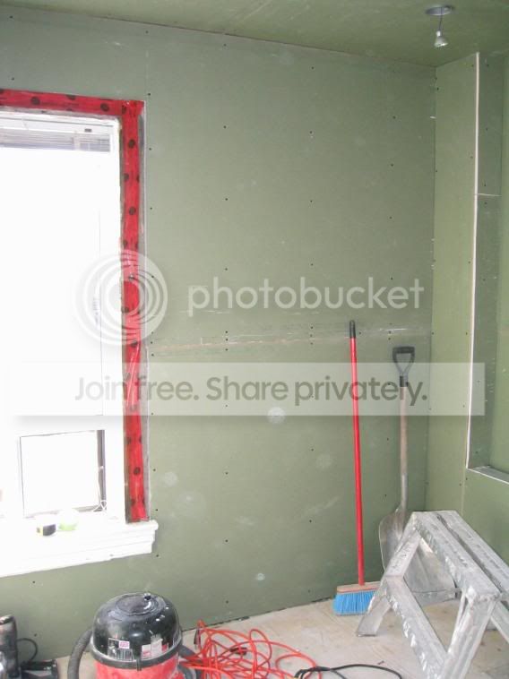

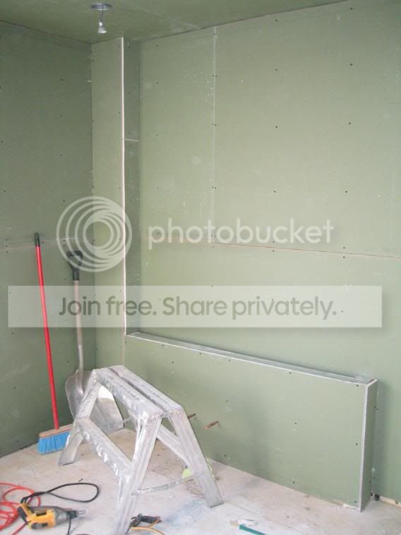

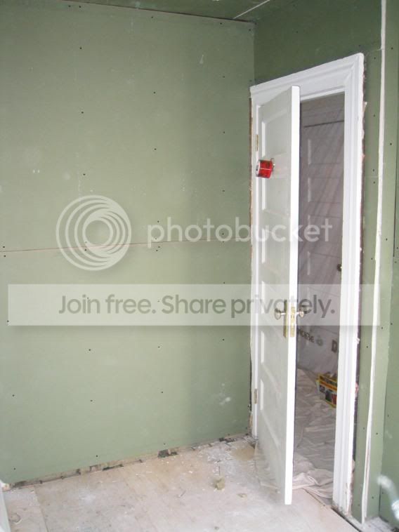

Here are the latest - drywall is all up as of 10AM Wed morning, exactly 1 week into the project. Wish my 650 went this quickly!
The knee wall will serve as a shelf along the edge of the clawfoot tub. There will be a marble slab on top. It's 6 inches deep. I brought the supply lines out the wall to make the tiling job easier. The only holes on the floor are for the tub drain and toilet flange. Not even a heating vent in the room - it wasn't blowing air anyhow (2 floors up and 40 feet back from the furnace) and the radiant floor heating should keep things toasty.

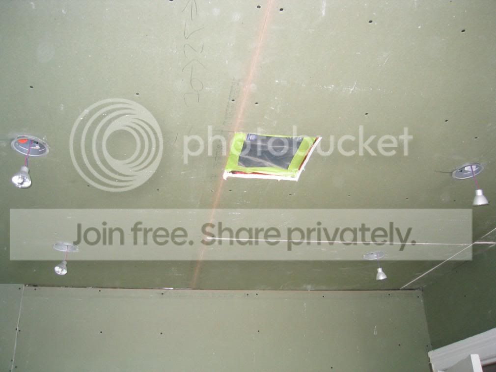

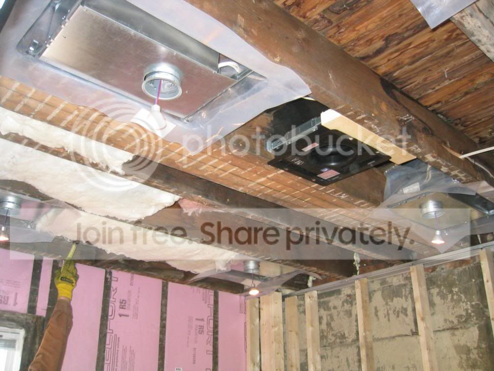

Hey Tintin, don't know what you are using for an extraction fan, but I suggest you don't skimp out on a really good one.
When I renovated my bathroom I went out and got the largest CFM fan that I could get. I also spent the extra $$ for the quietest one I could get.
The old one was noisy and the walls would be soaked and the mirror was completely steamed over. The new one though keeps the walls dry and I have yet to see even a corner of the mirror get any steam on it.
Best investment you can make for a big buck reno.
The other thing to remember is to keep the vent pipe from the unit as short as possible and as horizontal as possible.
I did quite a bit of reading on this topic. The room is 90 sq ft, and calls for a 95 CFM fan. I was going to opt for a 150, but the duct work goes to 5 inches at that volume and I only have room for 4 inches, and there was already a 4 inch duct through my solid 18" thick brick wall.
I went with a Panasonic WhisperCeiling 110CFM - FV-11VQ3
http://www2.panasonic.com/consumer-electronics/shop/Building-Products/Ventilation-Systems/Ceiling-Insert-Fans/model.FV-11VQ3_11002_7000000000000005702
It's near as I can tell one of the best fans out there. Runs at 0.8 sones vs. the 4+ sones my crappy old Nutone fan was running at. I also splurged on a Lutron step-down timer for it.
The duct work was a bit of a compromise. The previous owner actually used the crappy white vinyl flexible 'duct' that came with the Nutone fan I guess, or with the duct running to the outside. It has been replaced with 4" rigid duct, screwed and taped. It does have 2 elbows in it, to take it up and over the recessed light fixture between the fan and the outside wall. But it only runs about 5 feet in total length, so it's fine, and there are no low spots in the ducting for moisture to accumulate.
The fan cost me $140 which was a good deal compared to the quiet ones at Home Depot. I've learned to shop there as little as possible. In Toronto, I'd highly recommend BOZ Electric up in Richmond Hill. I drive 30 minutes each way from my house, but it's worth every minute. I got my recessed low-voltage IC fixtures up there for $44 each. Super high quality fixtures (Contrast Lighting) and all made in Canada, including the 3.5" trim rings. The fixture over the shower is getting a shower-trim plate, which looks almost exactly the same as the other 5.

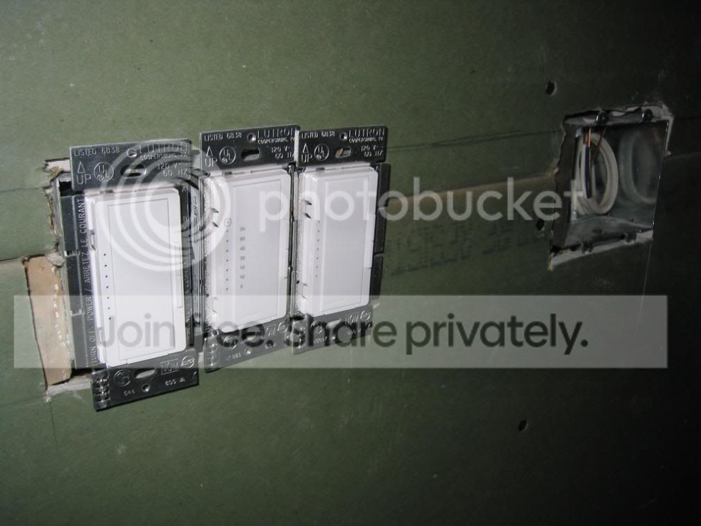

The Lutron switches were pricey, especially the dimmer for the low-voltage lights. It was $50, the timer was $40 and the regular dimmer was $30. But they're wicked cool :) There's a dual-gang Nuheat thermostat going in the box just over from the switches.

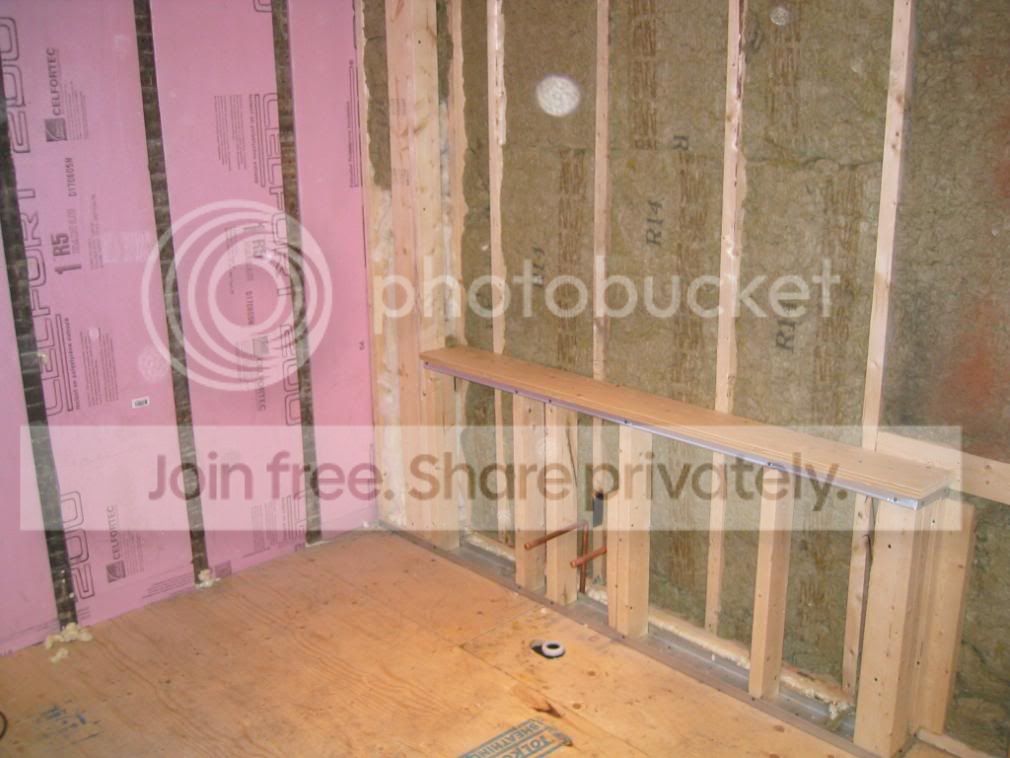

Those 1/2 inch copper lines... Those for a sink or Bidet? Seem a bit low for a sink... must be a bidet?
They're actually for a clawfoot tub. Dual ended cast acrylic clawfoot. Deckmount (Porcher) faucet with 7 inch spread. I had the supplies brought out the wall to a) make fewer holes in the marble tiles and b) keep them above the baseboard.
We're putting beadboard around the perimeter, up to about 42" off the floor, with a pretty good sized baseboard.
I got these nice shutoff valves that actually slide over the 1/2" copper with a nice looking chrome pipe and decorative cover (eschteuon?). These ones will be hidden behind the clawfoot, but figured they might as well look nice anyhow.
