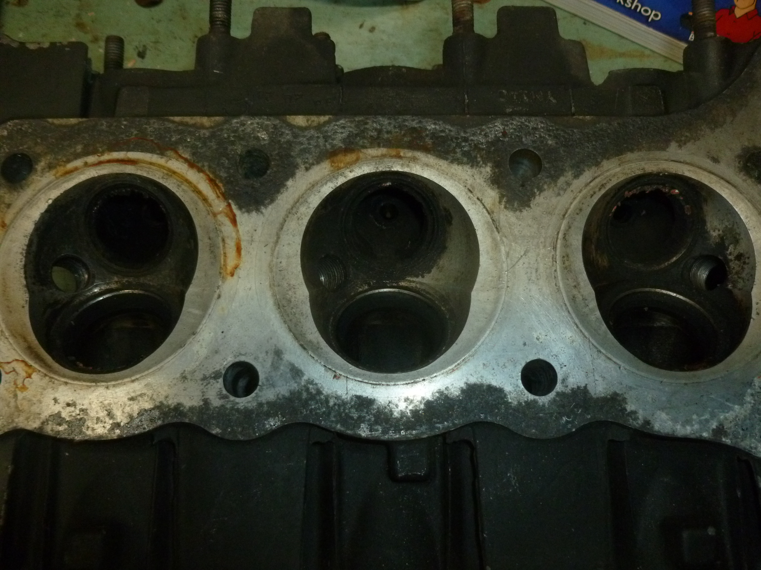

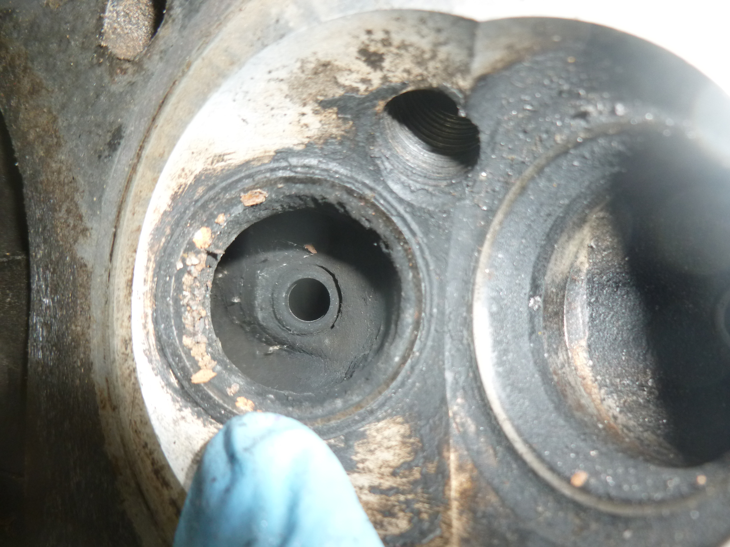

So I removed the valves from 2 sets of heads that I have. I noticed that on my black colored head, the exhaust valves had a bit of play in them as I removed them from the guides. The intake valves had no discernible play at all. On my silver colored heads the exhaust valves had less play in them than the black heads but one of the intake valves had the slightest bit of slop. I am thinking new guides are in order no matter which head I use. How hard is it to replace valve guides?
I was thinking of smoothing out the intake and exhaust runners but after looking at them I cannot see and real opportunities. Both runners are real smooth and clean. Any advice on what I should do here?
Also, what should I look for on the valve and seats when it comes to damage or problem areas? What are some things I should consider now that the heads are apart - re-machine or polish the seats, polish the back sides of the valves, clean everything, etc.?
Thanks,
Tom
First pic = black head
Second pic = silver head
third pic = intake runner
Fourth pic = crud on exhaust seat
Fifth pic = valve tool on bench

Both inlet valves need a bit of play in their guides or otherwise they will seize up, once used under normal running conditions. If you pull out the inlet valves and have them 5-10mm off their seats you should have a forward and aft play of about 1mm. If you're not sure, whether the guides are worn, try moving them left and right. If you have (about) the same play in that direction as well, then the guides and valves are still good. If not then your should have a closer look. Usually the guides will have gone towards and oval shape, if worn. This can be seen very well if you put a light under the head, so it shines through the guides.
With regards to touching up the ports, as the pictures show, there's quite a bit, that can be done to these, but I have the nagging suspicion, that this would be your first go at porting? (no problem, just asking)
Hi Nanno - yup, this would be my first time. But luckily I have two heads in case I screw one up so I would like to try some king of porting although I am not seeing what you see as far as opportunity goes. These ports look pretty clean to me but then again, I am no expert.
Tom
No problem.
There's basically two schools of thought on how to port an engine.
1) increase port speed
2) increase amount of flow through the port (volume basically)
Unfortunately 1 and 2 contradict each other. Because the bigger the port gets, the lower the speed. Which incidentially is also the reason why installing a HUGE carb on a small port won't work. (Because the vacuum created in the jet's orifice will be weaker...)
Luckily the above only partially applies to your problem, as you don't plan to go berserk on the poor port, but just improve what's there. In this case this means, to knife-edge the bosses around the valve guides, so the air flows nicer around them (increasing speed and decreasing turbulence in the port. The second part will be clear up the area BEHIND the valve stem as you want to slow down the air-fuel mixture, but leave a knife-edge separator to help aim the gasflow towards the combustion chamber. What you want to end up with is a teardrop-shaped boss around the valve stem, with a small knife-edged ridge going to the back. (on the inlet) The walls on the inlet-port can do with a gentle touch up with a mini-flap-wheel on a dremel, but DON'T polish it as that will actually be counter productive.
On the outlet all you want to do is to knife-edge the boss and blend it in towards the valve guide. The exhaust port can be polished, but it's more to give you that warm-fuzzy feeling of having done something to the exhaust port as well.
