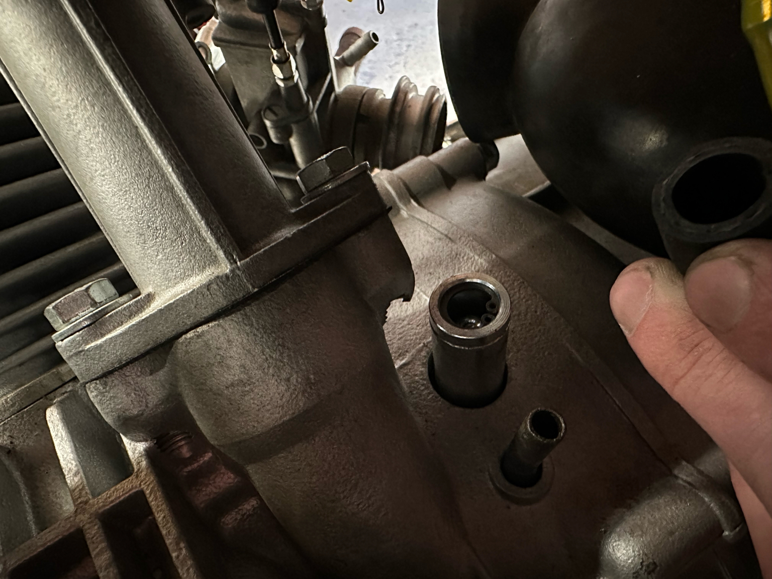

Time to address the breather box. This is apparently a known issue with the reproduction parts and the fix is to gut the spring loaded flap from inside the box and use a ball valve style breather valve from later model Guzzis.
I cut her open and pulled out the flapper, spring and mounting bracket.
Welded her back up and went ahead and sandblasted the exterior so I could powder coat it.
Used black texture since it was already in the gun
And with a quick freeze and a few taps the breather valve is installed.
I need to do another oil change just to 100% eliminate the chance that I overfilled it with oil.
