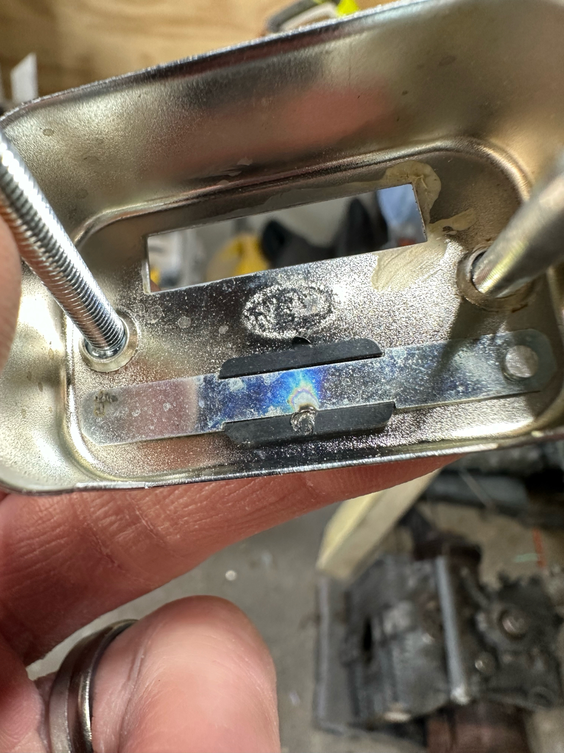

My main lighting fuse kept blowing. The handlebar switches are not the greatest design, and I suspected that was the culprit. Sure enough the horn button was grounding out on the pivot post for the headlight on/off/park switch, which has power.
I superglued some heat shrink wrap to the metal strip for the horn and filed the pivot down a bit to allow for some more clearance. Good to go.

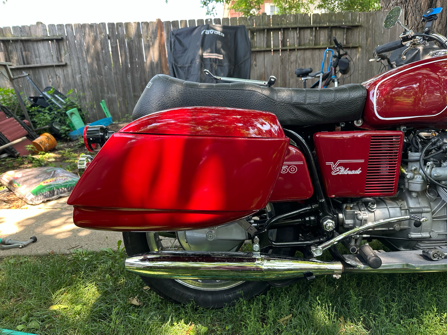

It took me all damn day un-hacking the cheap wixom mounting brackets I bought last year. Was not worth the $100 I saved. But I got the brackets riveted back on the saddlebags and got em mounted up.
Had to make all new posts, and adjust the rear mount bracket on the left side (cut and weld), and fill in a bunch of holes that someone drilled. Paint tomorrow.

Thanks, but I have a rack specifically made for this bike! Should be getting that mounted up tomorrow.
I was about to put my wixoms and brackets from the R90/6 in the "Mid-O Swap Pile", but I think I'll hang onto them. I suspect that I'll once again want to go somewhere on that bike, and since I didn't mod the subframe, they'll still bolt right up. I'll put them in the attic instead, thanks to this post! Looks great, and man I'm excited to finally see this thing in person "again".
