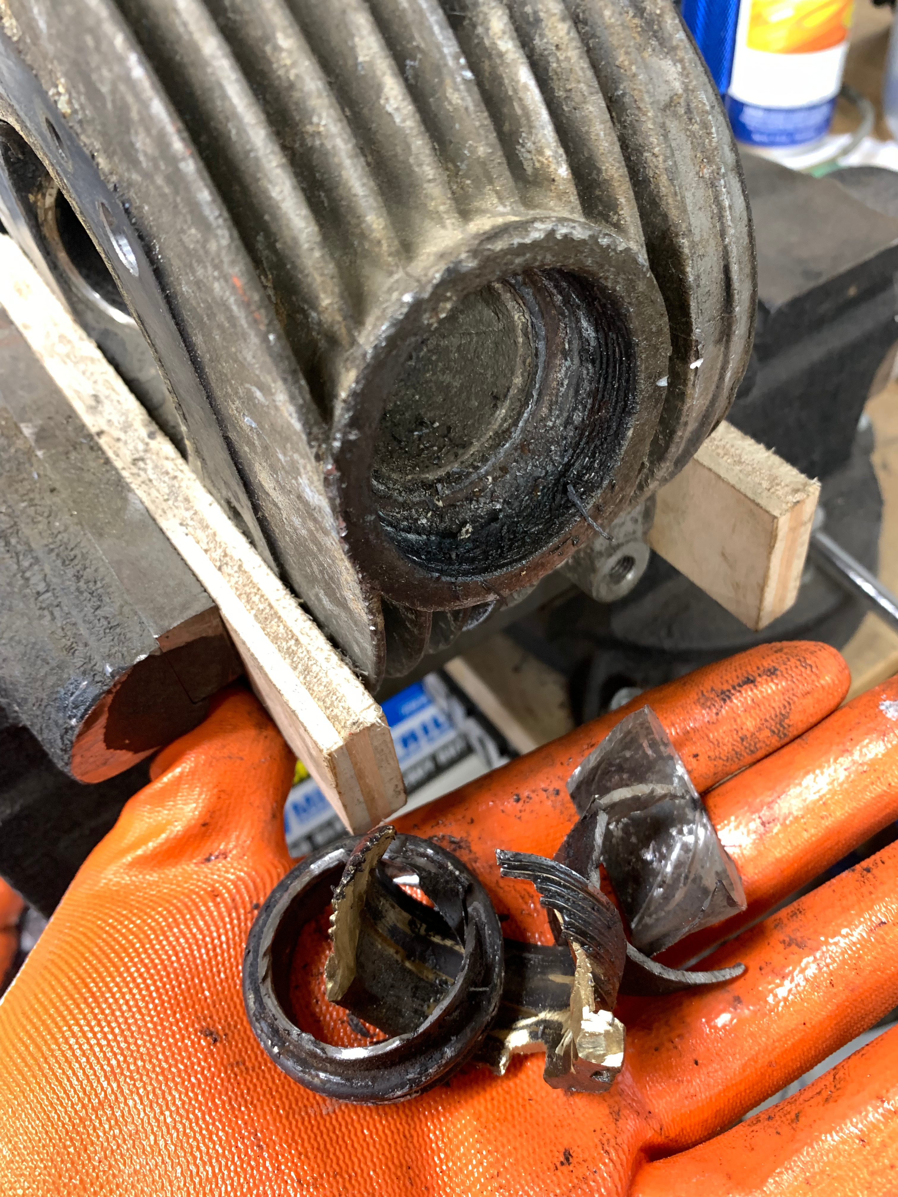

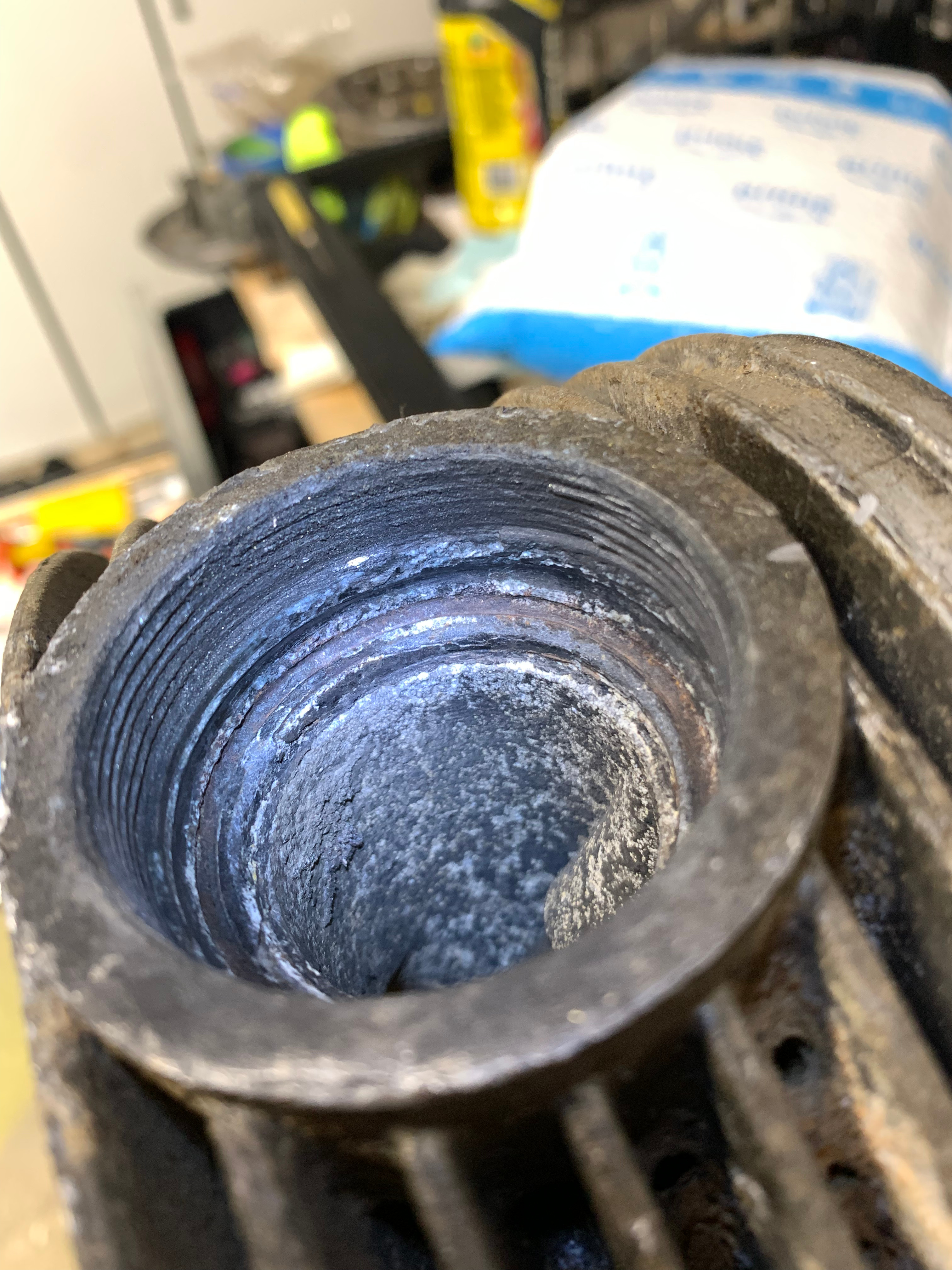

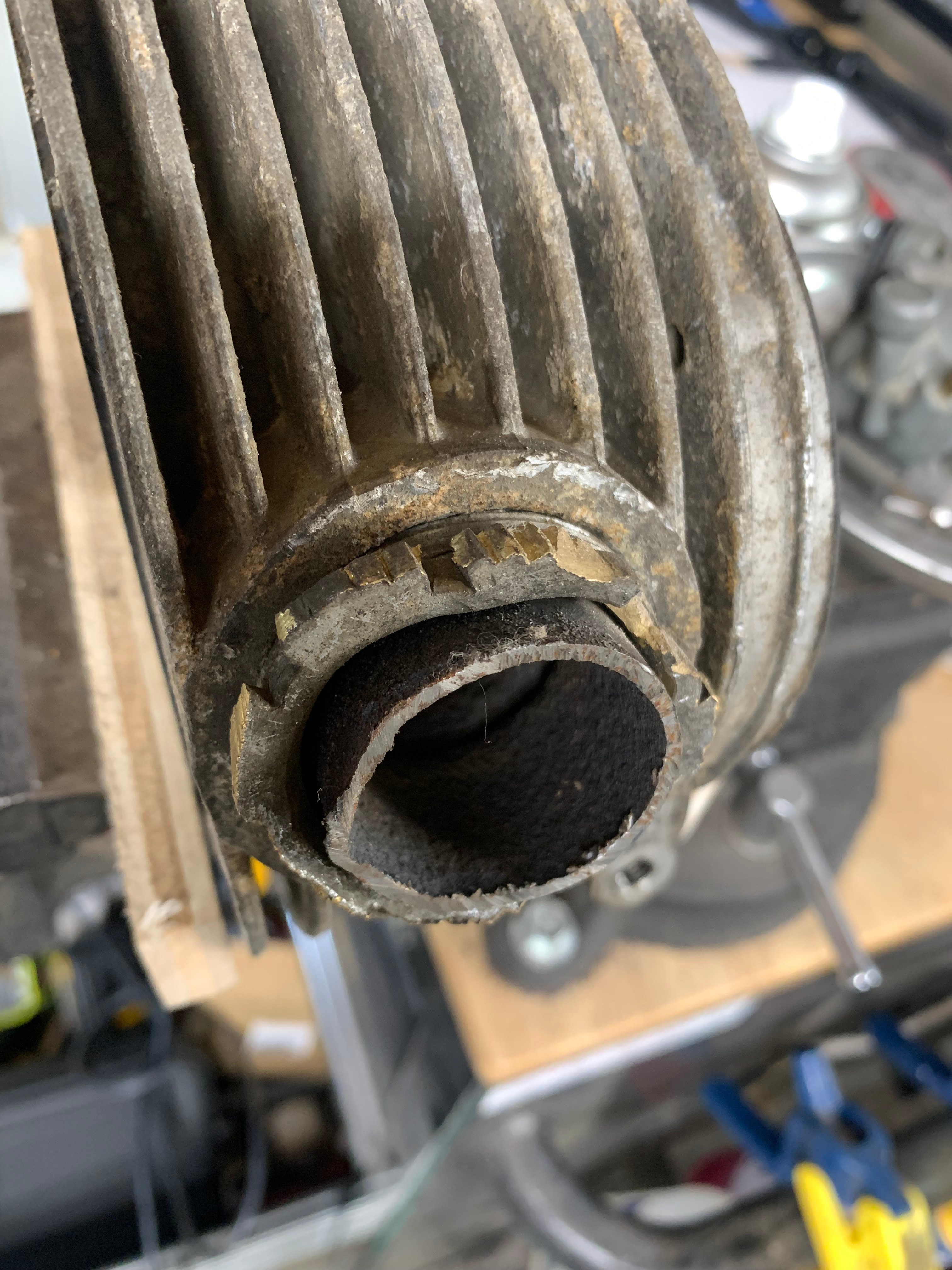

When I disassembled the engine, the exhaust collars were a special PITA. The heads have internal threads and the exhaust collar, originally made of chromed brass, thread into the heads. Enter galvanic corrosion. These things were so stuck, it took rounds and rounds of soaking, heating, and beating on them with the spanner wrench and a BFH to finally get one side loose. The right side, however, was not so friendly. I ended up cutting the header pipe off (the exhaust was rotten to shit so will be replaced anyways) just to get the motor out of the frame, with the plan to go in with a dremel and carefully extract the collar and header. Dreading this job but one day I grabbed the head and chocked it up in the vice and started cutting.
I cut just about all the way through in multiple places, tapped it with a hammer to free it up, and finally was able to put a big ol' pipe wrench on the collar and get it to turn. A small victory, but once I got the collar all the way off, the threads unfortunately came with it. Currently waiting to hear back from a machinist who has the tooling to repair these heads specifically to see if we can repair the threads on the right side head or whether we'll use a replacement from his stash, luckily we've sourced a suitable replacement head as a backup if this one can't be repaired.

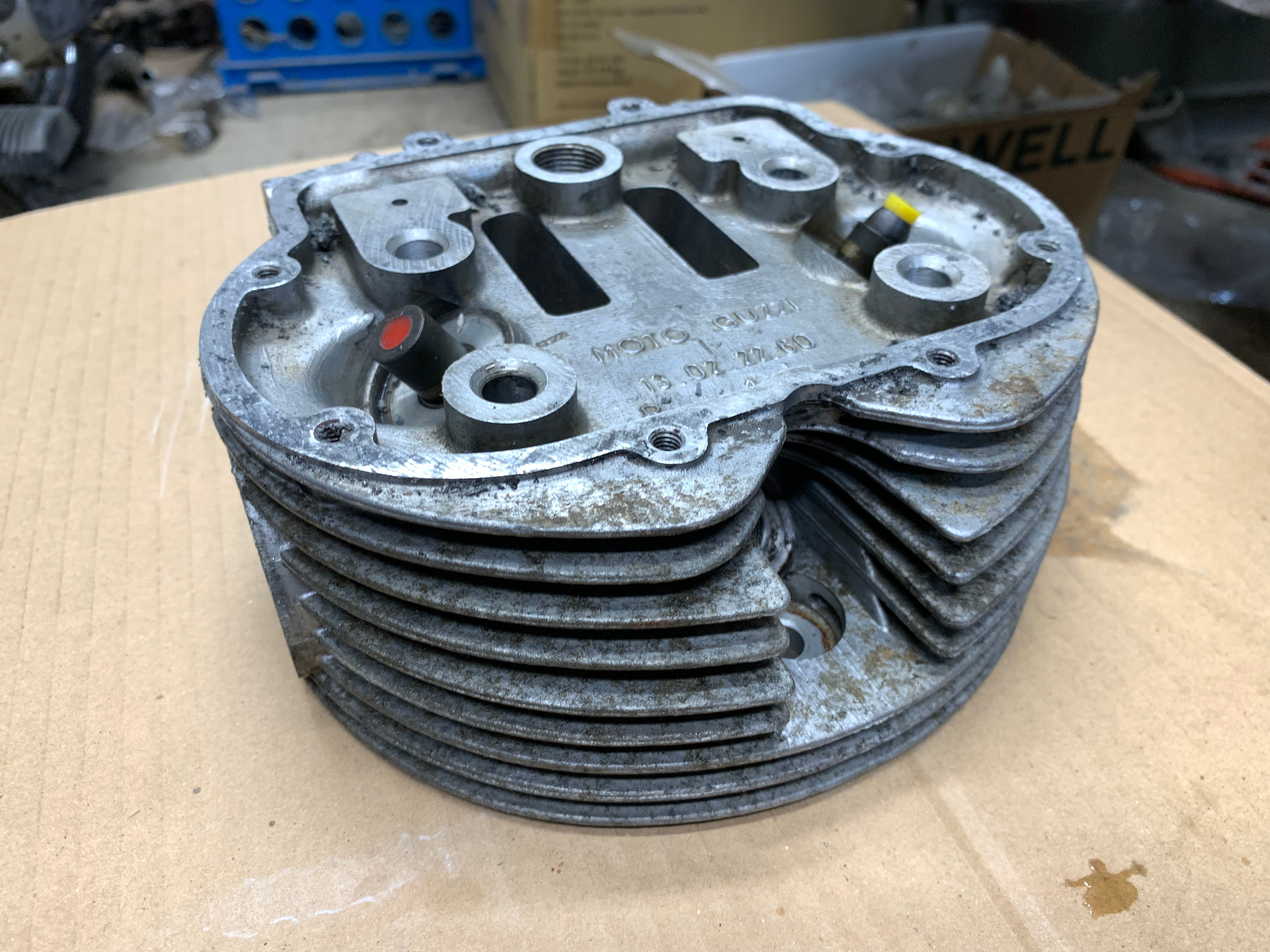

With the right side head on hold for the moment, I wanted to get the valves and left side cleaned up so we could determine whether we'd be doing new guides on that side. I degreased it and did my best to remove the hundreds of mud dauber nests between all the fins, threw it in the blast cabinet.
Once the head was done, I cleaned it and made sure to get all the media out of the nooks and crannies, blasted the valves lightly, and applied the Sharkhide. Mostly using a cloth and a Q-Tip, pretty tedious work but I've heard only great things about how this stuff holds up on bare metal.

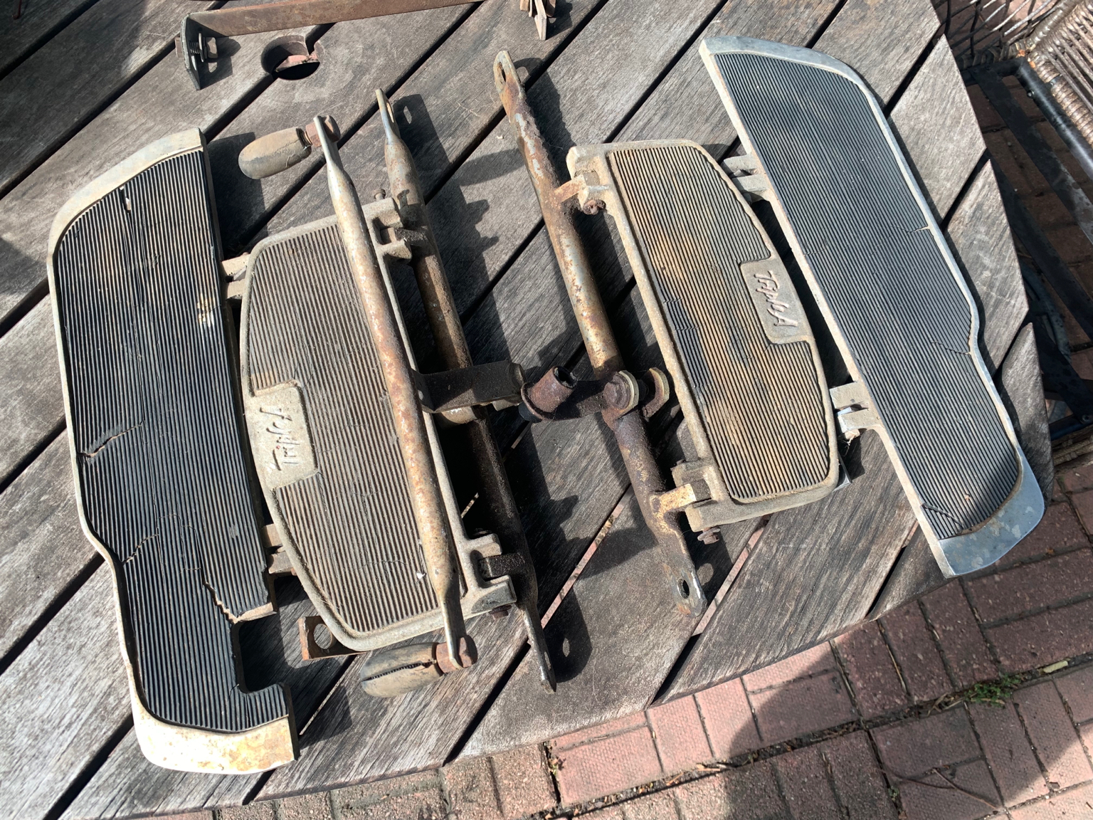

I picked up a set of DB floorboards to replace the little Triple A set that came with the bike. DB boards on the outside. They need a little love but should be much better. Will need to figure out a shifter that works with them.

I've never owned a bike with boards or heel/toe shifter, but I plan to refurbish the Triple A boards, as the DG boards need some work and if I can't find or fabricate a shifter that works with 'em, not sure if I'll be able to run them.

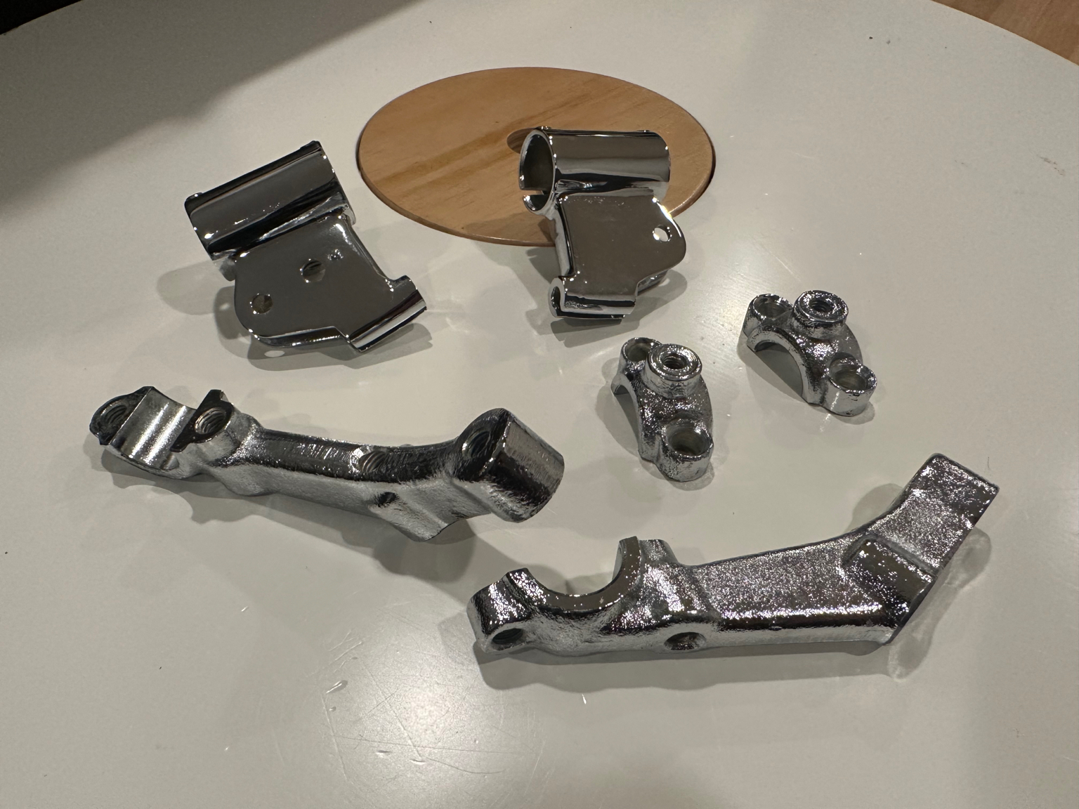

A couple weeks ago I rode out to the chrome place and picked up some parts I had rechromed, and dropped off some others. Handlebar to triple tree mounts and clutch/brake perches. Super happy with the quality and decent pricing too.

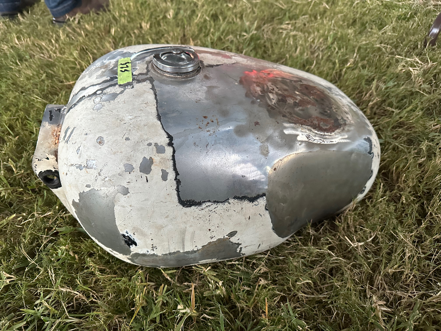

Found a couple scores for the Guzzi at Barber. A $25 tank that was attempted to be fixed at some point (poorly), but has much better shape sheet metal/chrome on the knee dents. This may be what ends up on the bike. If not it will look cool on the shelf, and the gas cap is easily worth the purchase price.

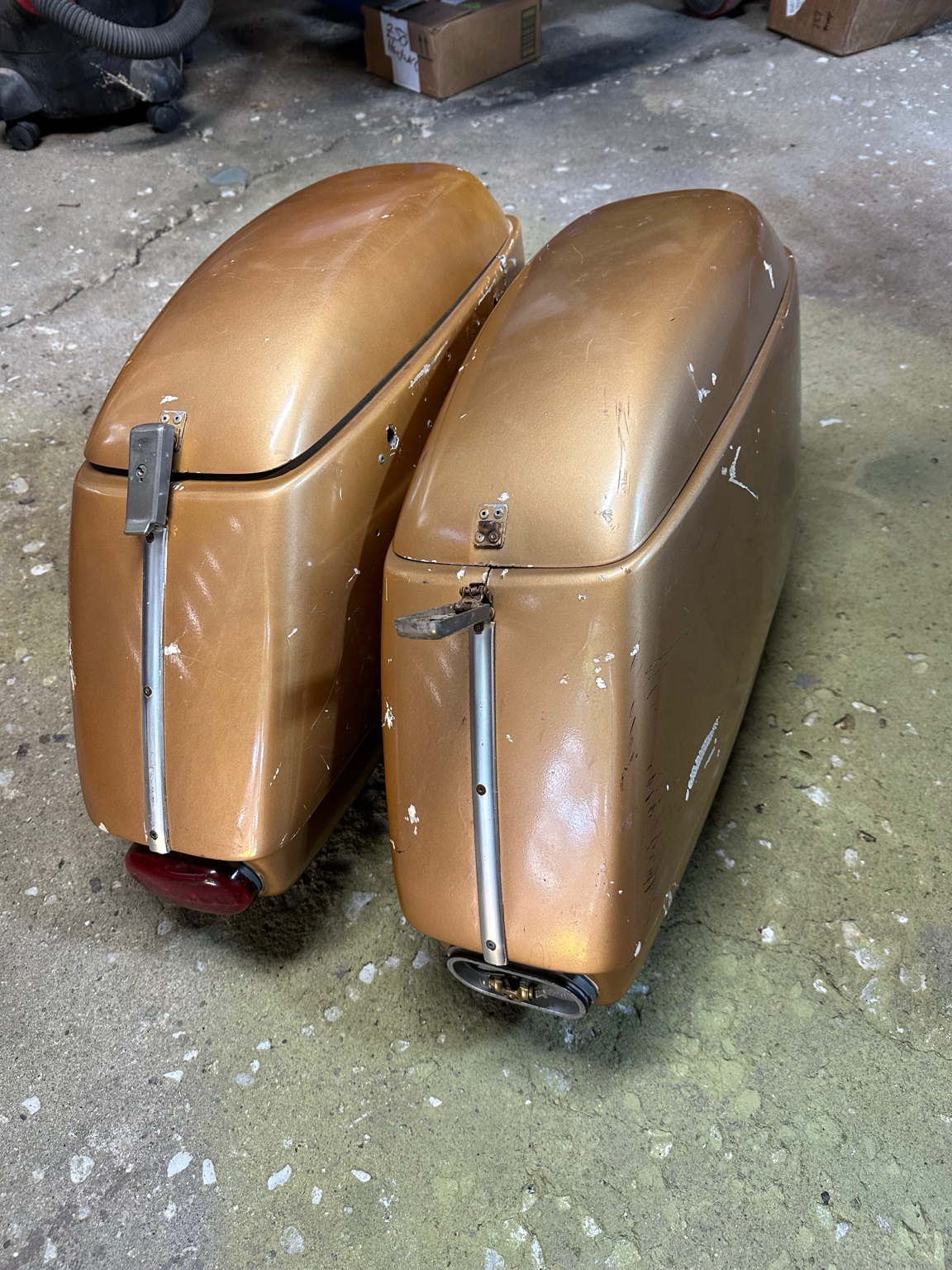

I also got a great deal on some Wixom Ranger saddlebags, and since I was on the F650 we had to get creative to get them back to IL. Luckily Irk had some ratchet straps for me and we got ‘em lashed up on top of the Givi bags. They made it all 700 miles back home and will get restored later in the build.
IMO these are the best looking period correct saddlebags for the Eldorado.
