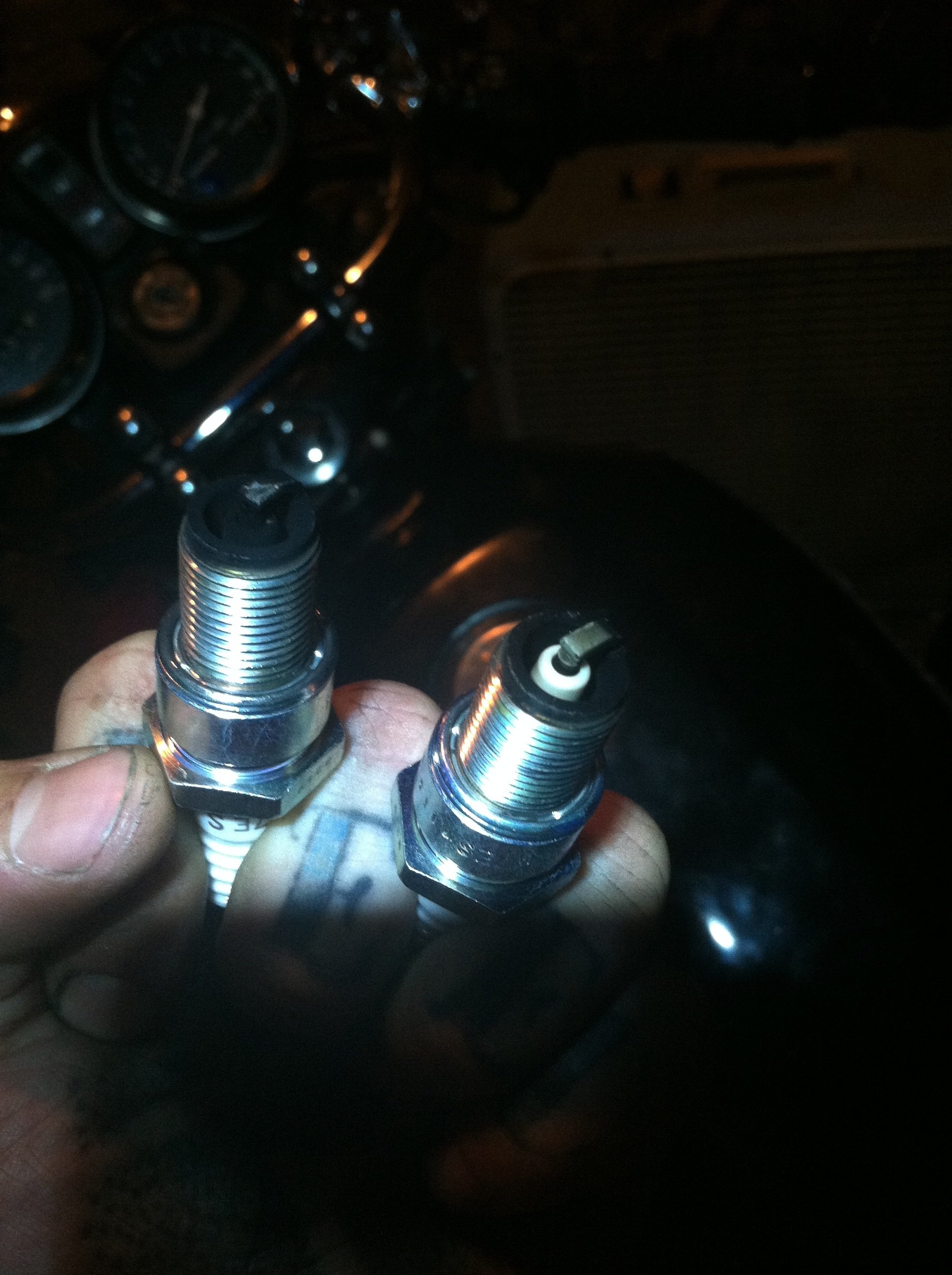

Alright. So I checked te timing and points gap. All is well there. Float levels are good. Clean carbs. Put brand new plugs in. The left is black as sin. The right is white. I did get it to idle for about 5 minutes at about 1000 rpm. But that was with idle adjustment screw turned all the way in. Also, after riding it for a bit, I did notice my oil light come on any time it dropped under 2500 rpm. I think it's normal to come on under 1500. My oil levels are not low. I made sure to check it while it was on a center stand for a few days.

Is the black on the left plug oil or unburnt fuel deposit?

Umm... Honestly I don't wouldn't know how to tell you.
Rich condition is usually a powdery black. Oil deposits a wet black.

Here's a picture of the plugs...

Looks like carbon (fuel), but can sometimes be hard to tell by picture.
Lots of things can cause that.
You are sure all the jets are stock? The carbs are 100% clean, emulsion tubes, air jets, etc?

So I figured it out. The other night I decided to double check my compression and my gage wouldnt even give me a reading for the left side. I couldnt figure it out why. So with a phone call to my brother, he suggested a leak down. Not having the equipment, I put her together and fired her up and rode her for a minute. I looked down and noticed that out of my left carb, what looked like gas, was being blown back out (I was lazy and didn't put the filters back on). So it got me thinking that a leak down usually tells you where a leak would be as far as compression and air and that if my motor is blowing air out where it should be sucking in, there might be a leak with my intake valves. So I adjusted my valves to spec and sure as shit, that was my problem. Now both cylinders are reading at 180 psi on a compression test. Took her around for a bit with not a hiccup and she idled perfect at every red light. Got her home, check the plugs and they were perfect. I am beyond relieved. Thanks for everyone's input and help. I am more appreciative than you know.
