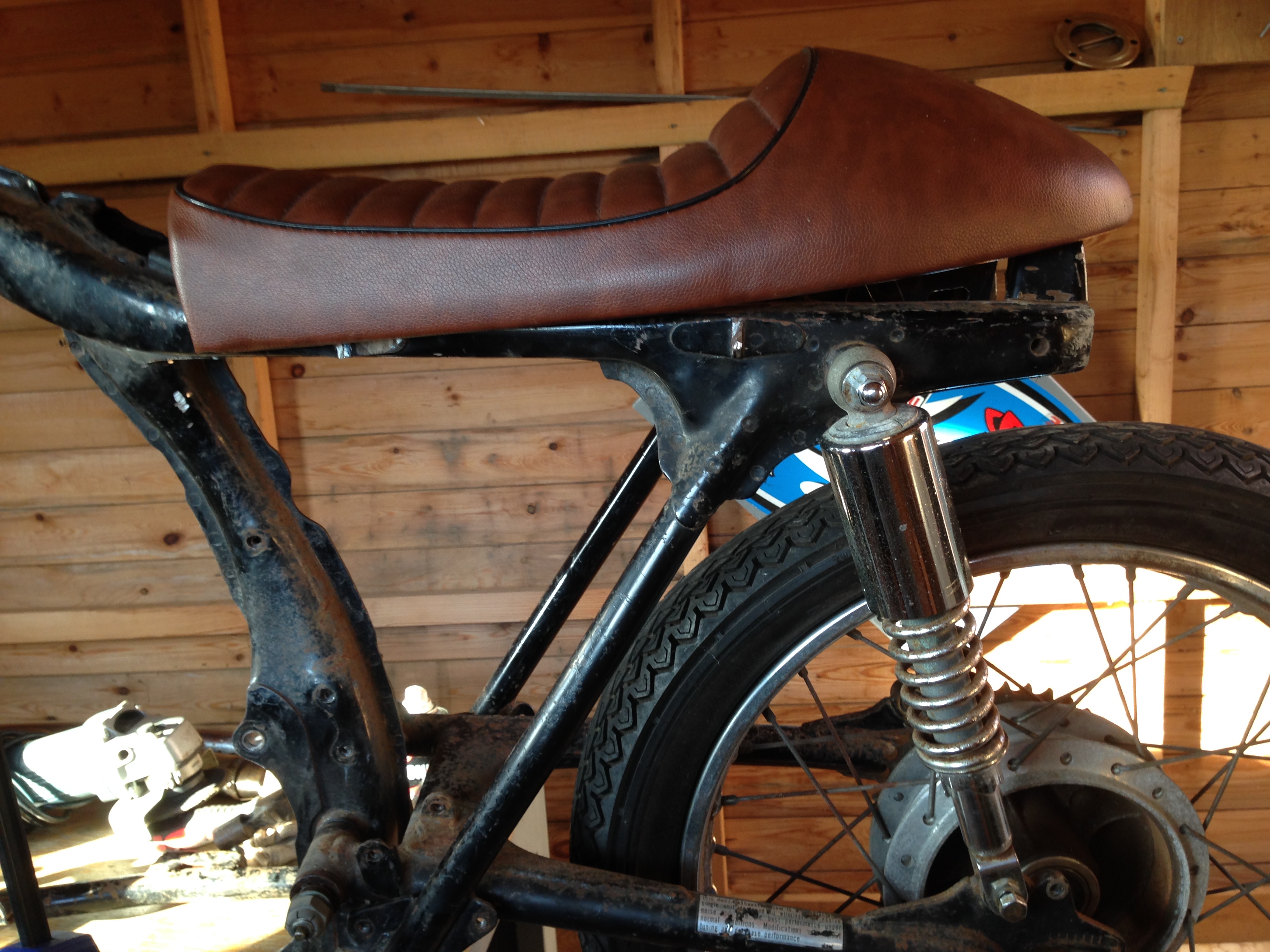

I'm just trying to work out how to mount the seat to ensure the back wheel doesn't hit when fully compressed.

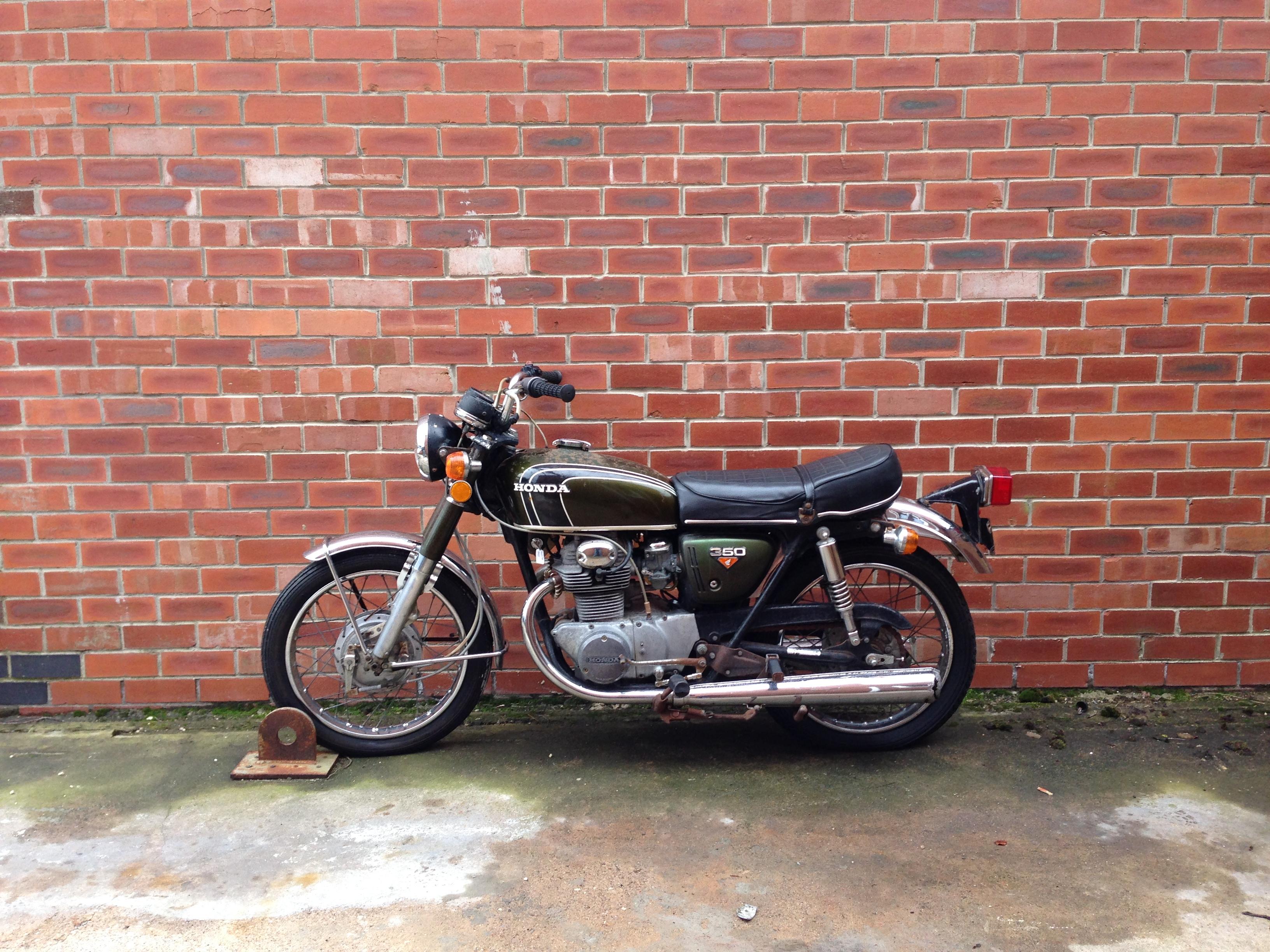

Post an "as bought" pic - warts and all ................. after all that's how it started out in your hands.
Good to have you here.
To be honest the pics don't look too bad. Hence I wouldn't of bought it. Only on closer inspection reality hit.

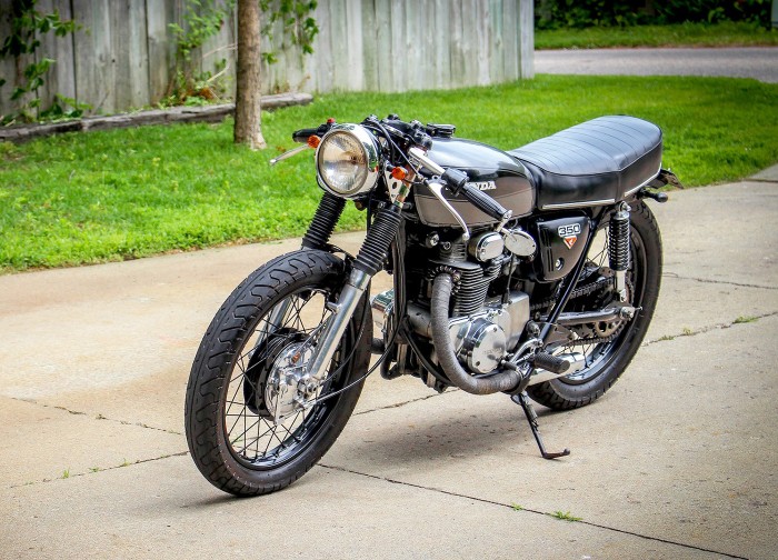

This is the easiest forum I have ever posted photos in.
I've already got grinders regret after finding this build and noting it's simple nature.

I've been on with fitting my eBay seat. The origional was rusted through and I thought this was the way forward.

Before you mount the seat, don't forget to get bars and a tank (and maybe footpegs) in place to make sure it feels Ok. You'd hate to build it all and find it sits you too far forward/back!
