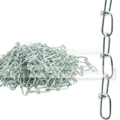

That's the first time I've heard of tying the nuts together so fishing them out is easy. I use lengths of small link chain, does the job and easy to fish out when you done. If the inside of the tank doesn't look like anything more than surface rust and it isn't leaking, I would not coat it.

I wish I would have read this last weekend! I spent over an hour trying to fish the last screw out of my tank. Chain and stringed together washers is ingenious.
