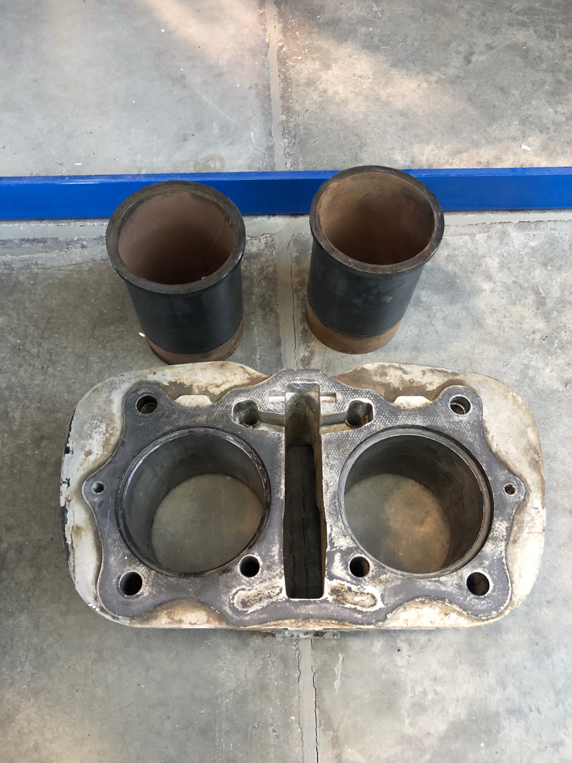

Thanks for the help everyone! Good cylinders are in the good (but very dirty) jugs. Second pic shows my setup, we don’t have any bricks so unistrut had to do. All of them dropped right out, except one of the good cylinders which took a few light taps to get out.

Back again... building the engine and realized the tops of the sleeves don’t sit flush with the cylinders. Assuming this isn’t right, do I need to drop them out again and do a better job of cleaning the space between them or is this something where I just need to take it to a machine shop and have them flatten everything?
When you install the sleeves you need a light press on the top of them to ensure that they don't pop back out while cooling, looks like that's what happened to yours. Alternatively you can fabricate a jig that holds them in place, but don't put too much weight on it.
We’ve got a bunch of steel blocks/spacers etc. for test fixtures, think I could get away with just putting a couple blocks on top of the sleeves to hold them down while heating/cooling?
Exactly. Without pressure, the sleeves creep up and if you machine the tops, they fall back down in use and the head gasket leaks.
You can also just press them into place in a hydraulic press. Don't go mad though.
Good to know. Don't have access to a hydraulic press so I'll just plan on using the same setup as before but put some blocks on top of the sleeves to seat them down.

Here’s the new setup. Let the furnace get up to about 350 with the cylinder in there, then put the steel block on top. Gonna let it sit at temp for an hour or so, then turn it off and furnace cool. Hopefully it works!
