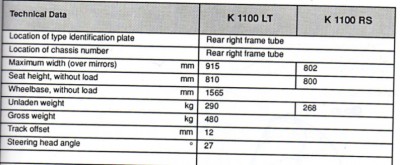

Here's the relevant "proof" from the BMW OEM workshop manual - you will see from the diagrams and accompanying text that BMW give acceptable offsets of front to rear wheel centres.
Not "he said, she said, but it might have been her brother's auntie" - but as specified by BMW and of course their teams of qualified engineers and designers. BMW have been practicing this "off-center" design for years - starting with the Airheads back in the late 50's. BMW are not the only manufacturers to do this. Oh yes, there hasn't been one BMW that has failed a design or roadworthy test because of that.

That is very interesting. Thanks for sharing that. Any idea for the reasoning behind that? It seems the offset is only 1.5mm (in this case) but it is obviously intentional, yet the reason is unclear.
Very cool find. Thanks!!
The reason is very simple ........... BMW in their design philosophy [ or the bean counters ] use the same frame / engine combo with a variety of uses in mind from simple touring - to sports. A good example of form following function. In my 55+ years of automotive / motorcycle design and development [ and manufacturing ] career I have penned many designs where the front / rear track is not centred and although the dynamics are different - the same applies to cars / 4 wheel vehicles.
In this example [ BMW ] that means that everything from the gearbox / swingarm pivot forward is in the same relative position [ exactly ]. However, that same design accommodates rear wheels from 3.5" to 5.5" [ Kay series ]. Given that the rear drive [ shaft ] cannot be moved [ dictated by the gearbox output ] and the front wheel / forks are in a fixed position the ONLY solution is to run the rear wheel track off centre. The measurement of 1.2mm is relevant to the stock 3.5" - 4" rear wheels ..... now increase that by another 1" or 1.5" [ 5" and 5.5" wheels ] and that differential grows substantially - ie 10mm and 12mm respec. My bikes ram 15mm offset for the past 10 years. One "expert" suggested that one side of the tyre would wear more than the other .... whatever.
This debate has raged for years in the BMW Kay [ K1000 series ] road and race forums and the above indisputable facts have been now accepted - reluctantly by some of the "experts".

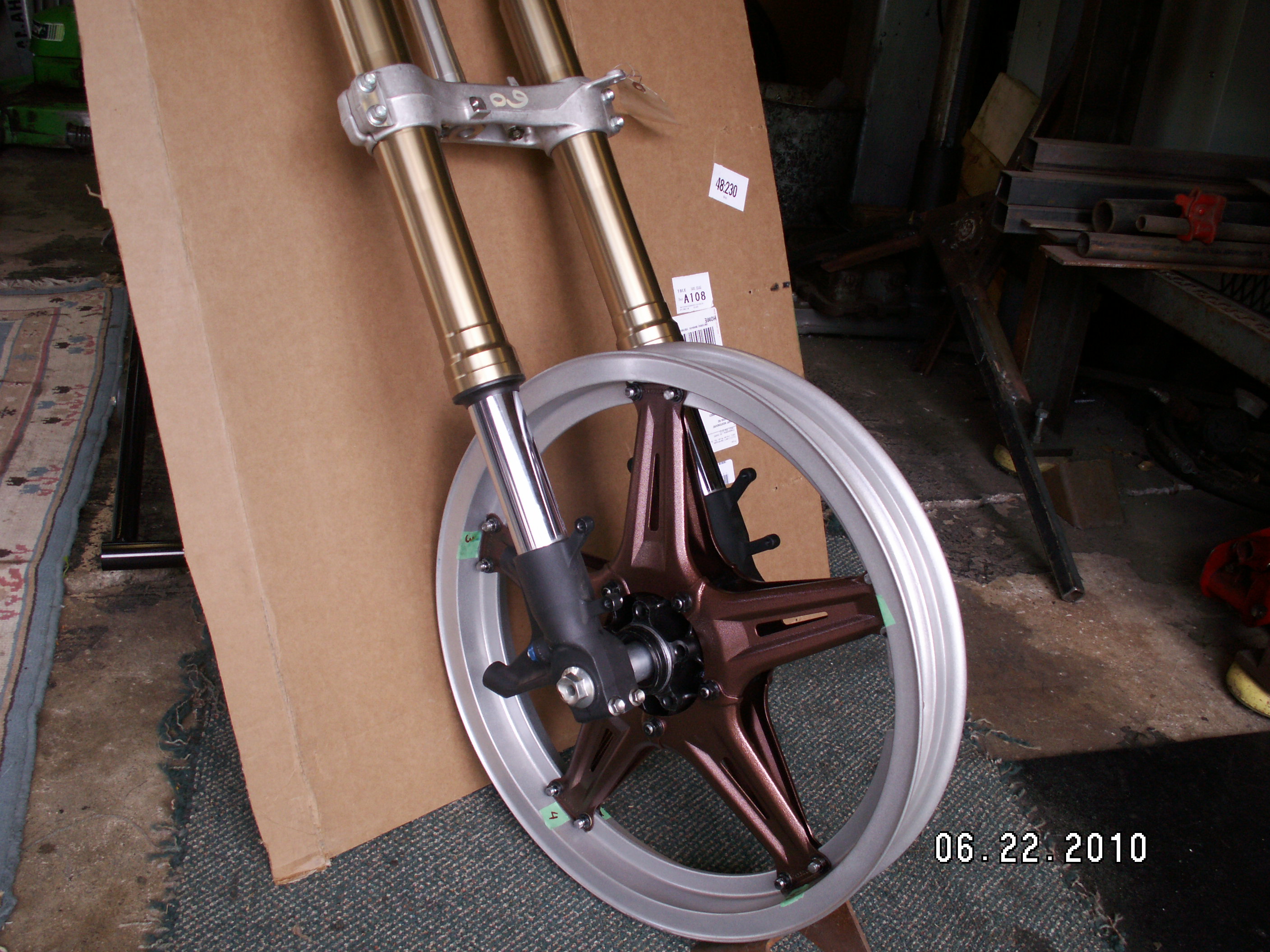

This is my Comstar wheel, the front as pictured is built from three different Comstars. The rim is a rear 2.15" x 18" with a CB900 hub machined to accept larger bearings for the modern larger axle and the plate spokes are original pattern Comstar from a 1.85" x 18" I used real aircraft hardware and it trued up very well. The Rotors (GSX-R) required some adaptors for correct offset. Worked out very well, the bike is cafe CX500 that I did back in 2010.
