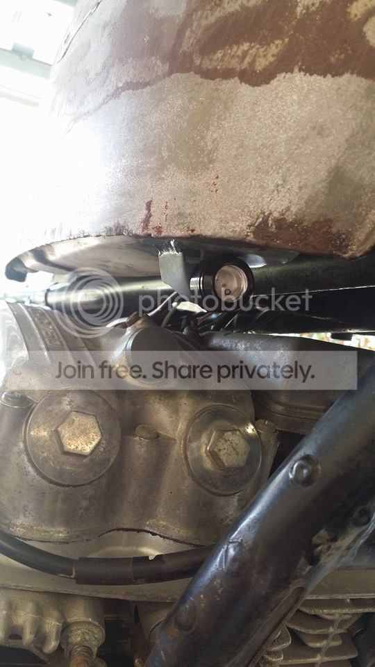

And because I can not leave well enough alone... I made up some mounting tabs and welded them to the tank for turn signal mounts.
