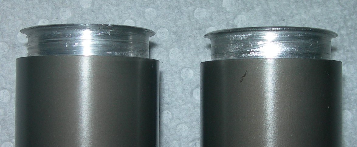

One diaphragm started splitting a few days after fitting, from the top and bottom inside edge. (see pics)
If both diaphragms (and the one I've had sitting in drawer since ~2016?) were bad I would think it was age related. As it's only one of three, I know it's a faulty part.
He totally refuses to deal with the problem?
I cannot recommend any part where seller is so cavalier when there is a genuine issue it just isn't worth the gamble of wondering when it's going to fail. It would have been far easier to fess up and say he knew about a 'bad batch' or even couple of bad ? (I have no idea how they are made but if I have to find out I'll start making better quality ones)
If you have a CB360, the carb slide isn't parallel where diaphragm fits but has a 'step' where diameter changes from 0.~980" to 1.044~45"
I machine step away to a nominal 1" so diapragm won't be 'twisted' (stressed) when fitted.
He advertises as OEM spec or better, pretty sure they will not last 20~30+ yrs when they can't last 4~5 days in some cases
