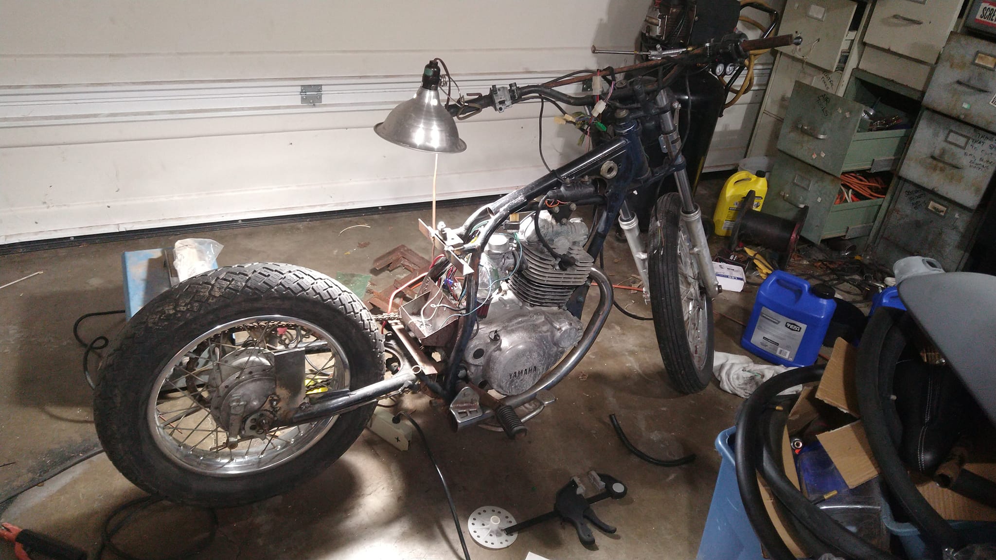

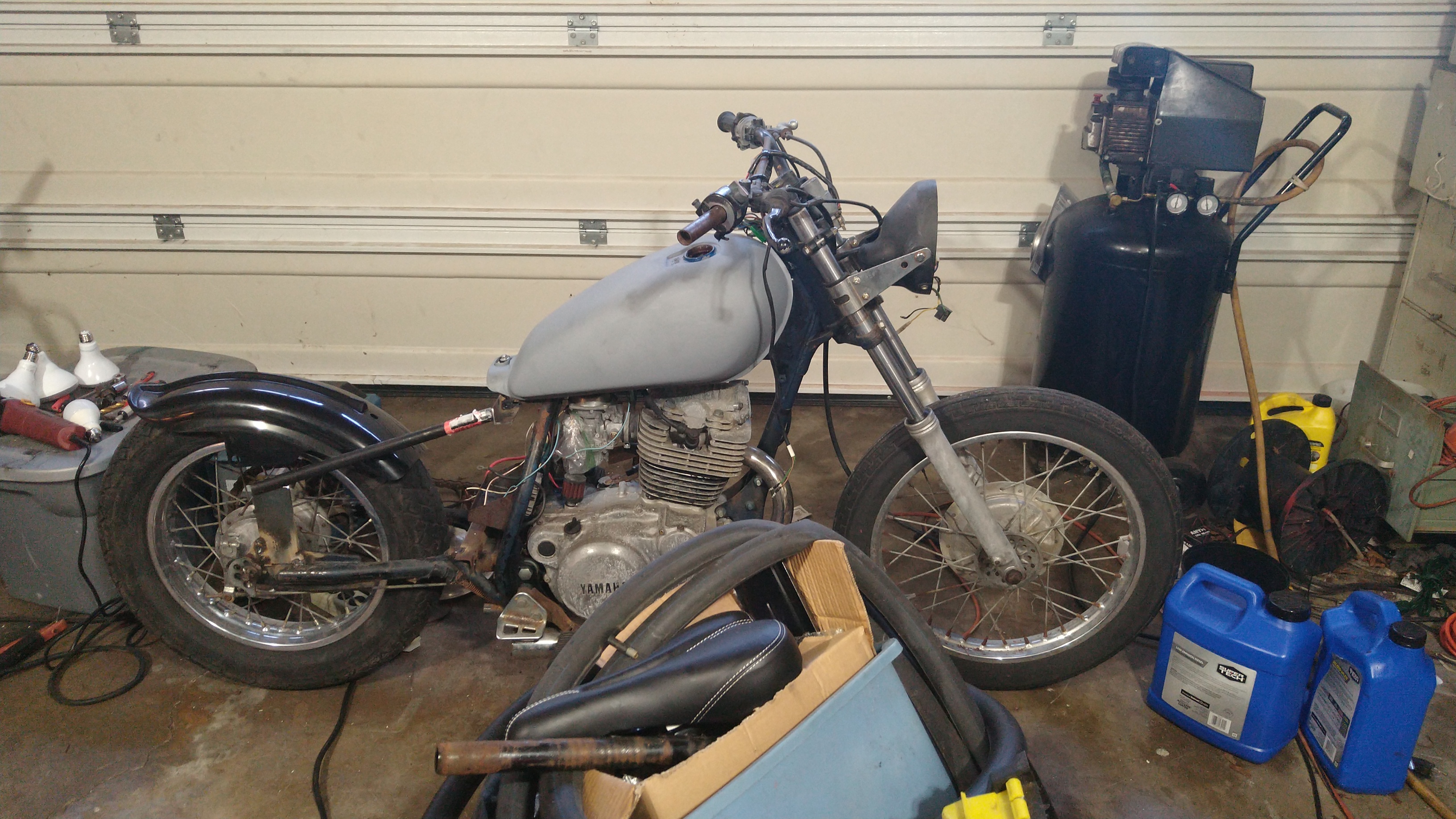

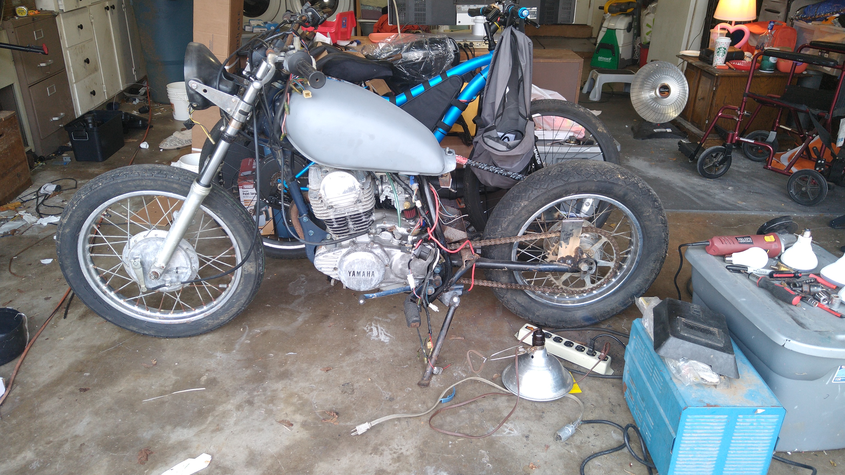

Small footsteps. Started blocking together the rear end. I tacked the swing-arm in place where I wanted it before I hacked off the shocks and rear frame. Now I'm going to carefully tack it together and then yank the rear wheel and finish it off....hopefully.
My wife wants me to take out a larger insurance policy on myself...

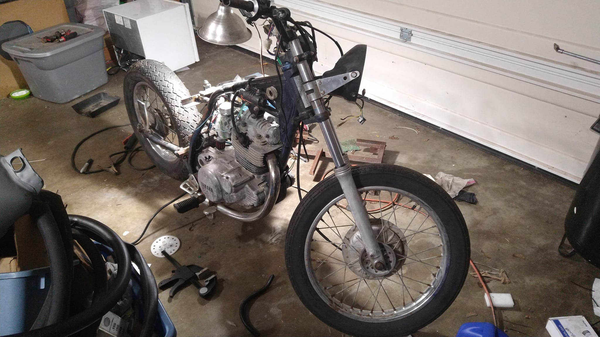

Little tiny baby steps. Once blocked in, I'm thinking on pulling motor and wheels off so I can flip the frame over and really weld the heck out of it.

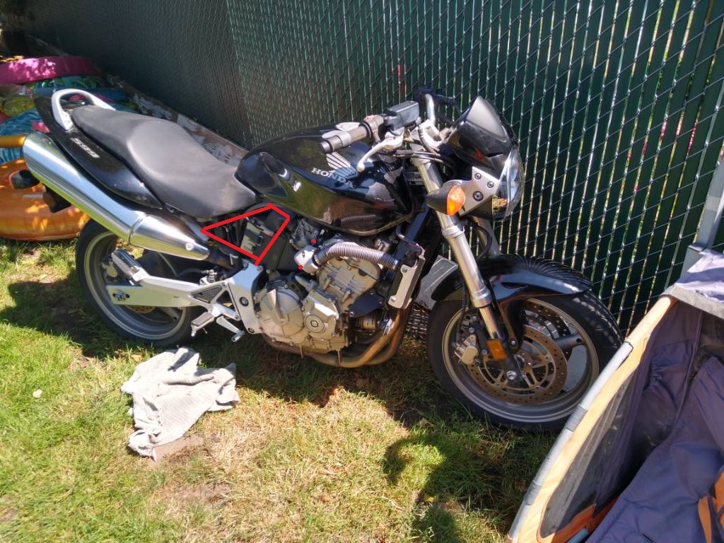

I apologize for the silence/absence - Life is really steering me away from touching any projects. I'm not sure if this would be a good place to ask, but is it just me or the Battery Cover Right Side Thing on the 2006 Honda 599 ridiculously impossible to find?
ANY battery cover us hard to find. Battery dead, need a jump, get if started, don't pay attention to making sure the cover is well attached. Thinking America's ditch lines are close to lined with them.
Hilarious, but true! Plus Honda 599's didn't exactly sell here by the tons- so dang.
APOLOGIES, FIRST. I have been a real Butthead, since I managed to get the Hornet "running*" and haven't lurked on the forum too much lately. I guess I'm just too happy to have a two-wheeler that isn't a wheezing motorized bicycle! But, as an update, the friend I bought the Hornet from, contacted me later and gave me the missing battery cover after he found it in his garage. Awesome Thing!
