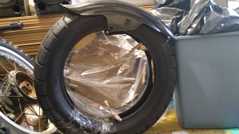

Hey, Jerry, I was wondering if you could post the outside diameter on the frame mounting tabs for that fender, I really like it but don't want to order one up until I have an idea of how it would fit my bikes frame.. I really appreciate it man, sry to be a pain in the ass lol
like, how wide the fender is at the mount tabs/holes? I'll check and post when I get home. If it helps at all, it's set up as a traditional Harley Fender, which on the old bikes were 130mm section width tires. This picture is from the ad...
...it pains me to know that I have to mess it up, trying to paint it red. I tend to make things worse, not better!
So... my idea for this fender is to try and butcher an original SR250 front fender for it's mounting tabs and use that to match up to this fender.
I bought two of them, so that if I really had to, I could attempt to use it as a rear fender also, if the bobtail one doesn't wok right.

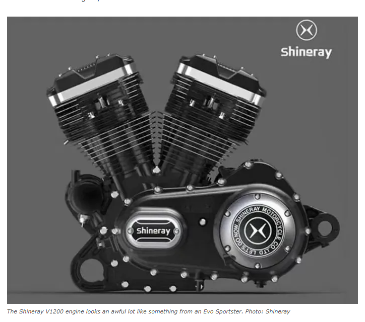

So, for the "Ground-Up-Reimagining" builds that many in and outside of D.T.T, clones of popular motorcycle engines have been a Godsend. But so far, they've been mainly clones/adaptations of the Honda horizontal single, the Honda CG125 mid-cam, or the Suzuki TUX 250 motor, the Virago 250... I haven't seen any clones of the Suzuki SV650 motor for sale, but I'm pretty sure they exist. All decent motors, and available through Ebay, etc.
My main lament was that none of the Classics, like the XS650, the CB350s, (insert your favorite orphan motor here) have been available, for whatever reason. And then THIS pops up! This will pretty much enable ANYone to play as Eric Buell or whoever was behind the XR750, etc.
No clue as to when or how much, but these would be excellent bases for our projects. (I'm still holding out for my Fave, the Suzuki LS650), but at this point, we shouldn't be choosy.
...for the record, I have been a Sportster Fan, but not generally an H-D Fan. I bought a brand-new 883 Sporty because none of the Japanese dealers would finance me, but H-D did. The bike served as my daily, AZ-CO car, and ran with NO hiccups until I sold it (5 years, 44000 miles, 3rd set of tires), later.
This is good news, and I anxiously await my LS650 Clone, Shineray! :)
