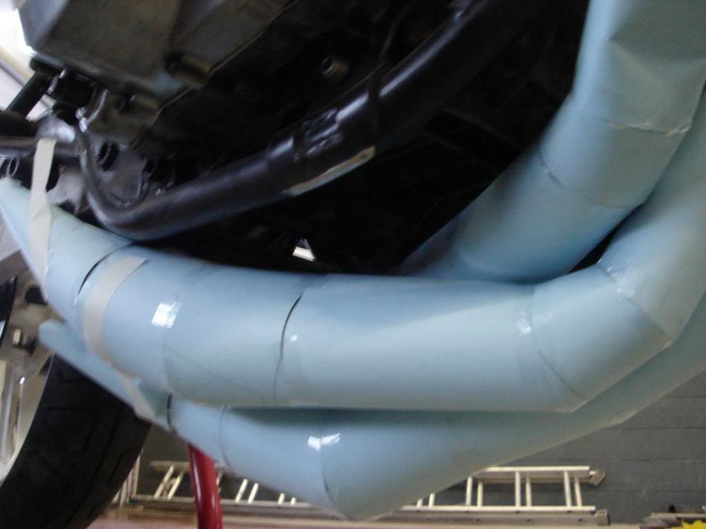

We mocked up a set of chambers out of cardboard for it. They look really good! The pieces are now cut out of steel and winging there way to the welder for assembly.
I'll post some pics shortly! :D
Re: Kawasaki H2/FZ Cafe Back from the Dead?!
Here are the exhaust pics.
I REALLY like the 'baby blue'!! :D :D They'll be a natural steel finish. 8)
I'm liking like the short ,stubby look of the pipes! The stingers and silencers have to be added, but you get the idea.
They fit tight to the engine and frame yielding terrific ground clearance. The side stand has to be moved forward and the centre stand is "long gone" of course!! :o 8)

That--my friend--is impressive! I've built exhaust from scratch before and the spatial ability required to do a basic exhaust, much less chambers (and three!), is increadible.
So are you just making them out of mild steel? Did you ahve a sheetmetal guy roll the cones or did you do that yourself?

Ya, it's quite a job to fab these things up! I wish I had the skills to do it myself! ;D We have a group of Kawi Triple guys here in our area and 2 of them decided to join their skills together to create some chambers for the guys. One is a computer design guy and the other is a metal fab/welder. The results have been encouraging so far!! They've created around 6 sets of pipes for 400, 500 and now 750 Triples. The "seat of the pants dyno" tells us we're on the right track! :D We're gonna get some real dyno time this spring so we'll have some actual #'s!!
Our sheetmetal guy just cuts out the steel and sends the bits to the welder. He rolls them, fits and welds the whole shebang on the bike.
I do know a young fella who made up his own set for his project this past winter. He's very talented. He said afterward that he wouldn't do it again!! Too much! :D
