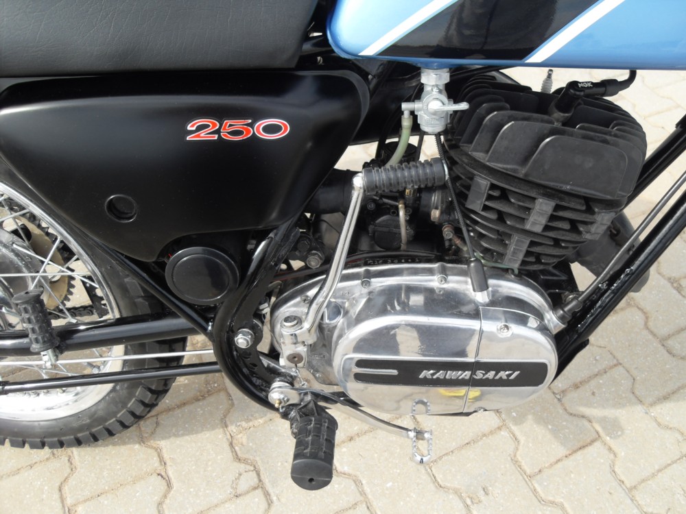

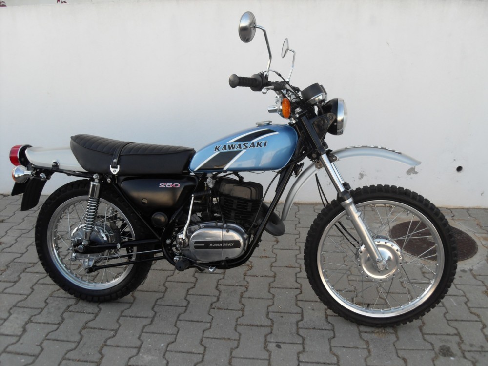

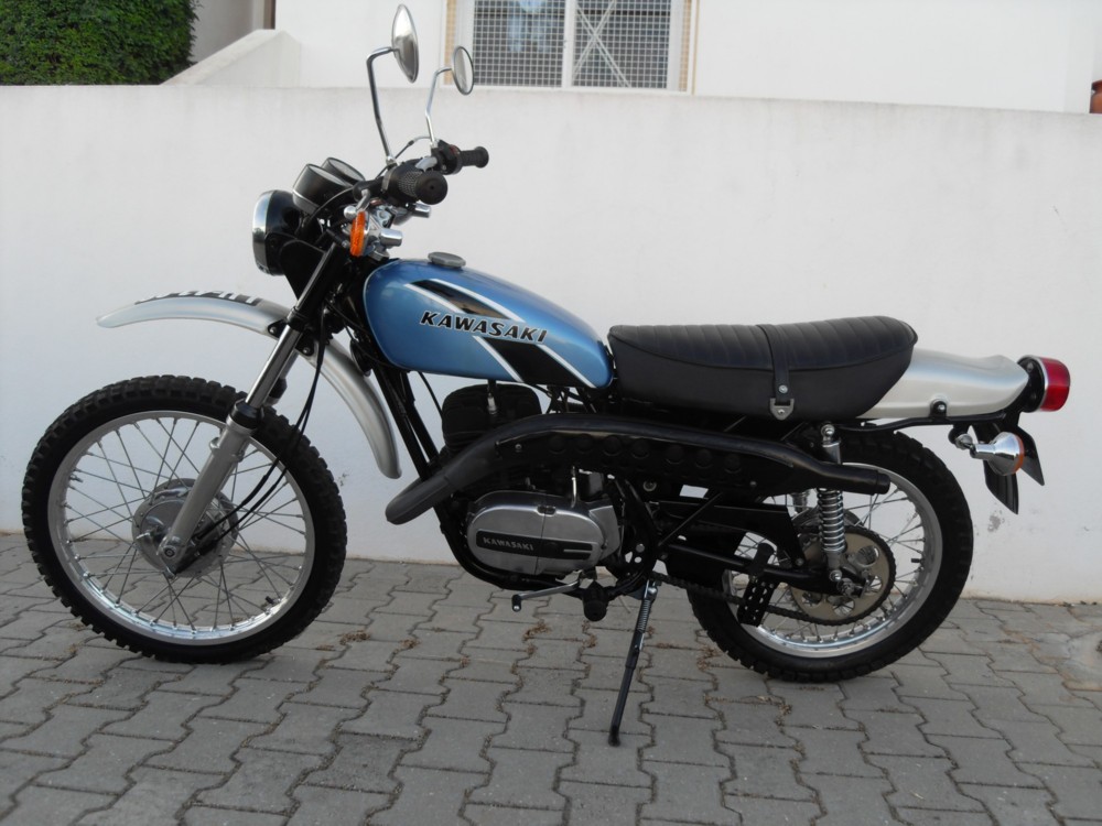

Hi.
Excelent topic, and excelent restore project, with your "personal touch".
I'm Ivo, from Portugal, and i restored my F11-B european model, 2 or 3 years ago, up to it's original condition.
Here are some pics.
Best regards, and good luck with your F11-B.

That looks brilliant mate, nice work looks like you did an A1 resto :)
