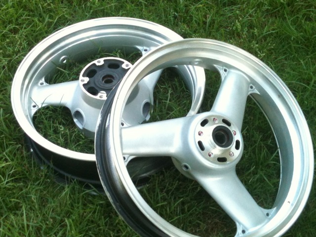

Finally got some pictures of the swing arm today, as well as the wheels and seat. For te wheels, we did painted spokes and hub and polished lip. The seat has had some fiberglass and Bondo work on it to bring the back of it down to the seat hoop.
