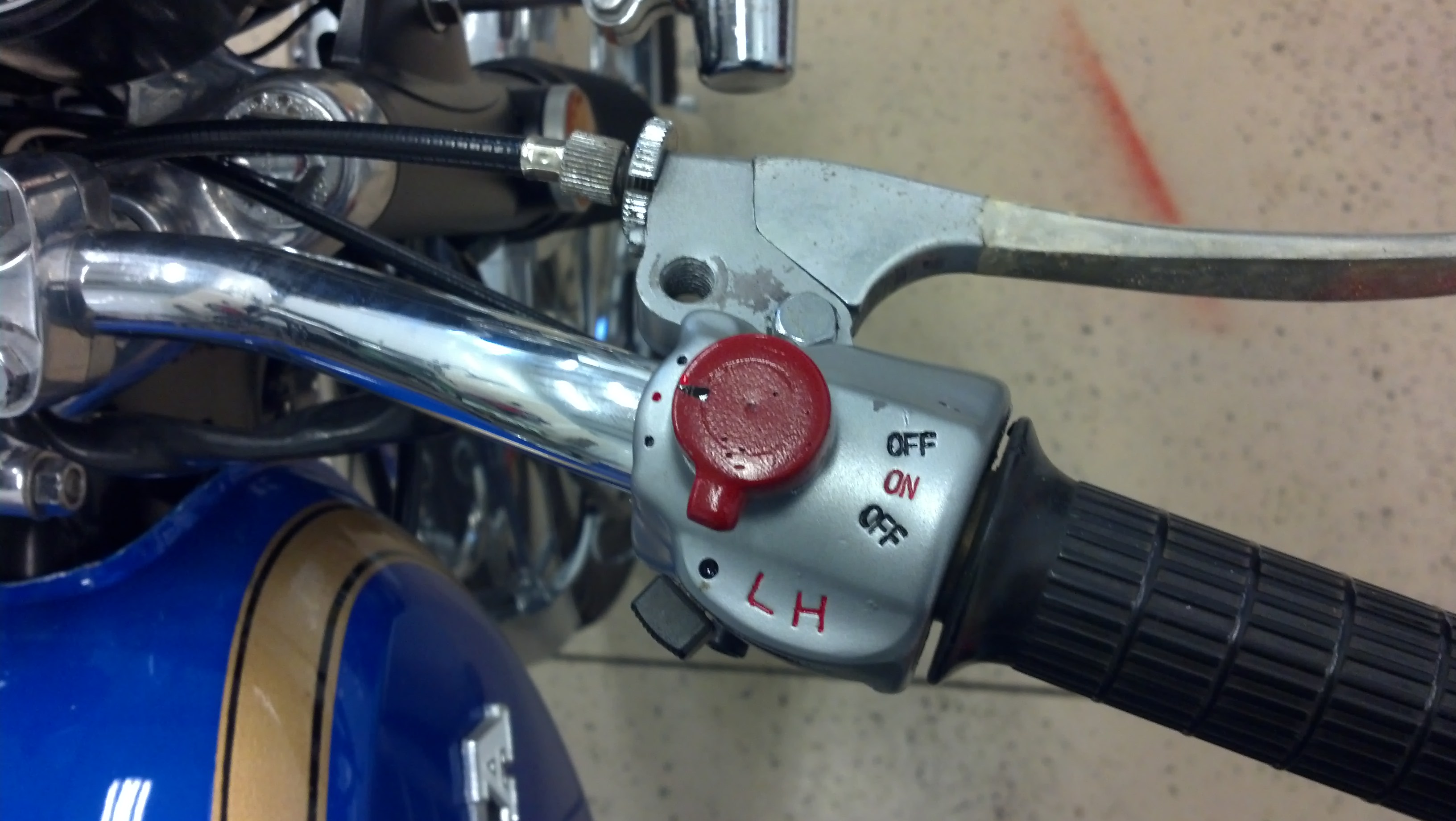

To close the loop, I want to report out the rest of what I did to finish this kill switch knob restoration.
I drilled/tapped a radial hole for a 2-56 set screw. Then I added a few more layers of JB Weld to create a lever for the thumb to cycle through the switch detentes. I figured this was a must have in case I ever need to kill the engine in an emergency.
I did some filing and sanding to shape things, then a coat of paint, and then I finally touched up all of the recessed lettering in the top of the controls.
The picture makes the top look 1000x worse than what it really is. If this was a trailer queen show bike, a final skim coat of bondo and some sanding would have made the top look 100%.
