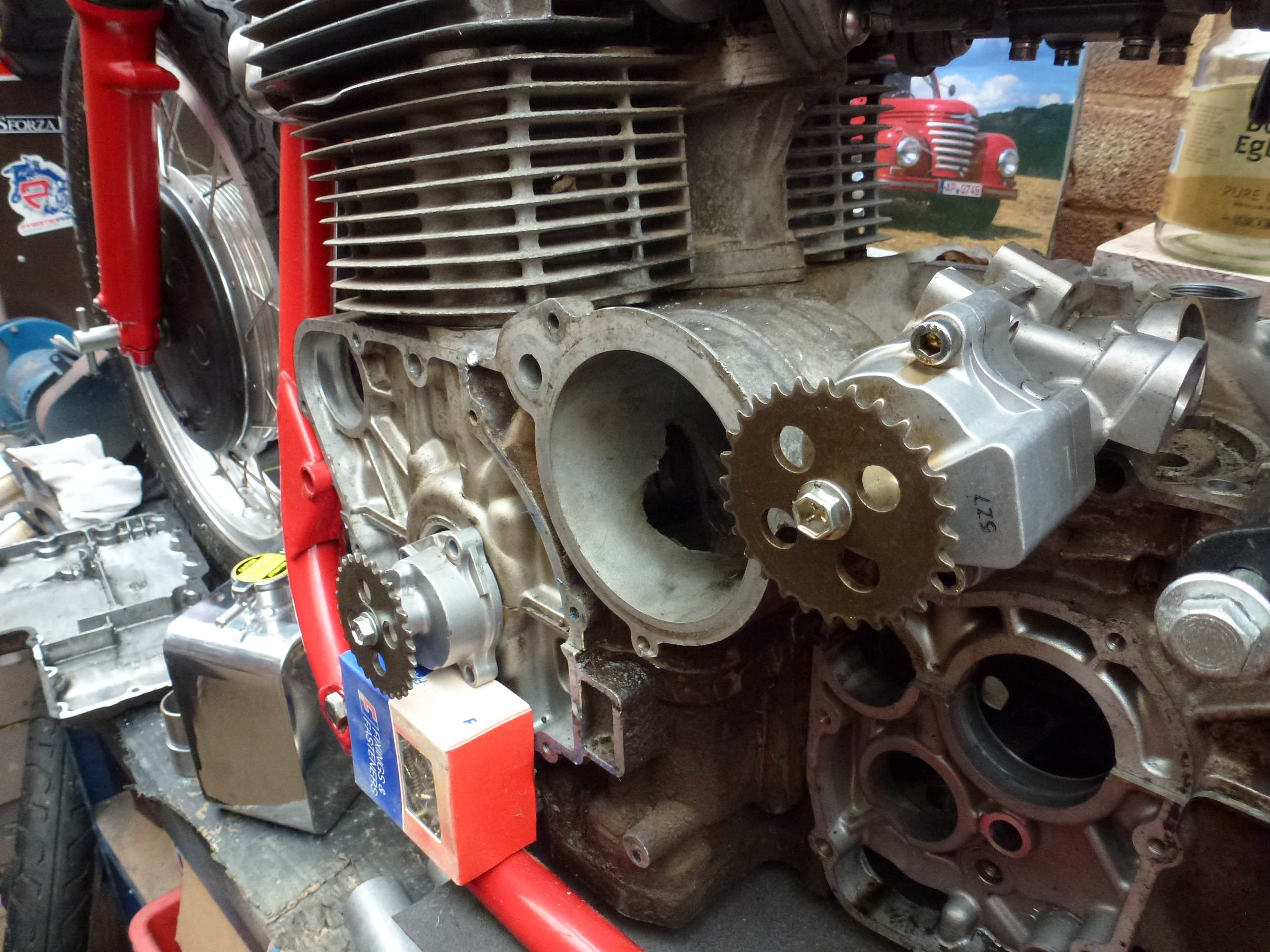

A favour please - could you give me a measurement from the vertical oblong boss on the gearbox [ viewed above sprocket ] to the centreline of the primary drive sprocket ? I want to roughly 'ish set up the rear wheel for sprocket alignment. My dummy engine has no guts in it. And I don't want to handball the complete lump around if I can help it. Ta
Many thanx for the pix / measurements. One final - if I may be a PITA. ::)
Here's the point I need the drive sprocket to rear sprocket alignment measurement from. IOW - I need to know how far out from the casing the sprocket c/l is. That's just so I can roughly position the rear wheel and sprocket to get spacers made. I'll allow for shimming for true alignment once the "real" engine is in the chassis. Your second pic down showing the drive sprocket from above is virtually it, but you can see on my dummy engine - I don't have that outer case where the drive sprocket is !

I replied over in your thread as well. I'll get you that next measurement this evening.
This is a pic of the measurement I PM'd you on a few minutes ago Beach. I think it's what you need. 1.5 inches from the main engine case edge to the outboard side of the drive sprocket.
