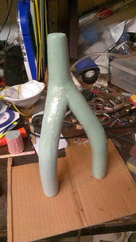

I put a coat of epoxy over my intake mold to protect it from the poly resin I'll be putting on with the layer of fiberglass.

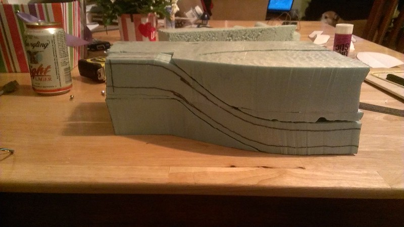

The foam mold started as a block of foam that I rough cut to shape with a hot wire foam cutter. The foam cutter is a homemade unit I made from a transformer, dimmer switch, and a guitar string. This was a much more controllable method for cutting than the first draft I carved out with a steak knife.
Final shaping to make it the proper diameter was done with foam sanding block.
In my first try a few weeks back I tried to add too much material at once so it got out of shape. I also learned that the polyester dissolves the polystyrene. (like dissolves like)
Less than stellar first attempt but a good learning experience....

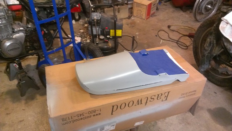

With nice weather Sunday I also finished the prep for the casting of the rear fender mold....
and laid down the first layer of glass...fingers crossed hat it releases as well as my test pieces...

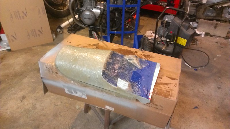

I popped the fender off of the...fender.... :o
I used a bunch of layers of wax as mold release but it was still stuck pretty good so it actually pulled some primer off with it. Glad I didn't add any more glass yet because the first layer is strong enough to hold shape but was thin enough to flex and come off.
With a bit of trimming it is starting to look like something.

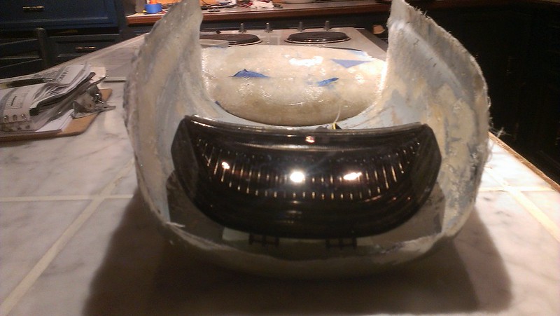

The LED CBR tail light came in the mail last week.
Looks like it will be spot on once the fender is narrowed to fit the frame.

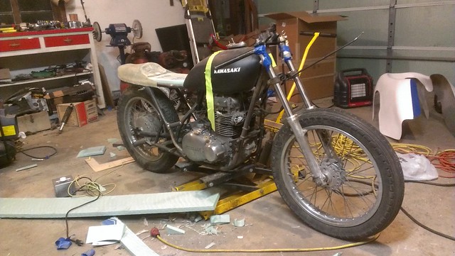

From the looks of it my original mock-up position of the fairing was too low to allow for clip-on bars but the lower part of it curves in and couldn't be raised any further without lots of cut-outs. I dug out some clip-ons that were a made for bigger fork tubes but I shimmed them to hold still for a mock-up. I slapped the exhaust on too for good measure....yep...even more fitment issues.
So I have to start hacking up the fine piece of art that is the Airtech Cheveroli fairing or start gluing some foam together to glass up my own fairing to fit.....
Any thoughts from the peanut gallery? Anybody need a used but never painted Airtech fairing?
Maybe I overlooked the explanation, but where is the carb going to site with that long of a intake manifold? A much longer intake than the 2-1 I have on my KZ400... but I guess you don't have a battery box in their, so you have a lot of space.
I don't think I gave much explanation for that plan. I wanted to design something that gives a straight run to the head but Y in the frame is sort of in the way back there so I am going to run it back under the Y in the frame. I made the two runs to the boots a bit long because I wanted to be able to trim the ends in case the composite wasn't great. I will use the stock boots at the head and some 1.5" ID fuel line at the rear.
It will be shortened to fit here. The carb is 34mm keihin D slide knockoff. I'll be fabricating an inner fender to minimize road spray/grime getting sucked in the intake in this location.
The carb is 34mm OKO (Keihin PWK D-slide knockoff) that comes with a few jet sizes for about $40 new on ebay. We'll see how it pans out but the build quality is pretty amazing for the price. I should have the intake done this week so I can try it to get it started.
