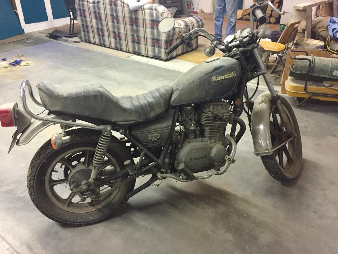

I'm going to fix this bike up to flip. The person I got it from owes me more than what it is worth, but that's another story.
This going to be a quick turn around I hope. It will be a little different than most of the other KZ440s. The engine does have
good compression at 155/160. Here are some pics from before I picked it up.

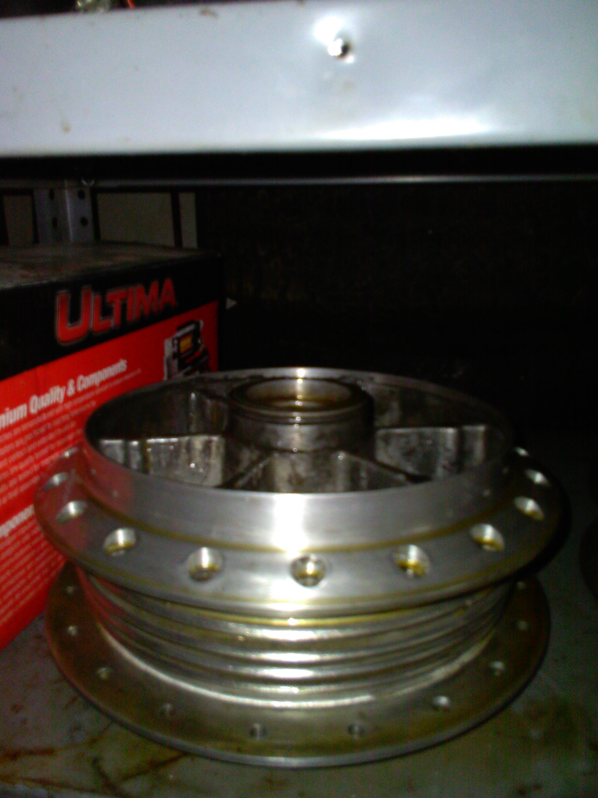

But I have cleaned up the hubs for the KZ440. Just a little hint to where I'm taking this project.

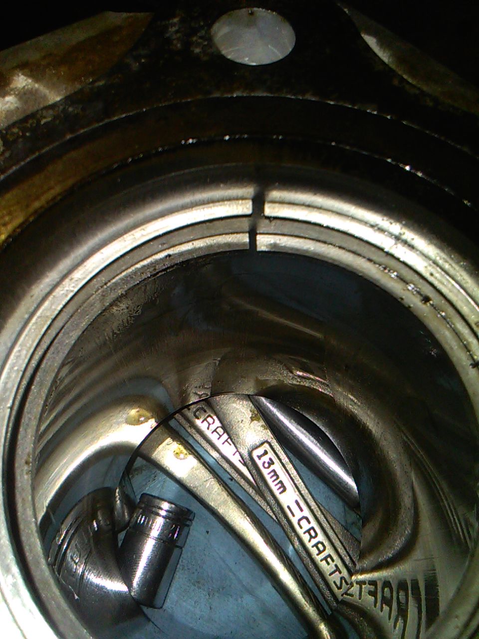

Engine had good compression but burnt oil even after it was warmed up.
Cylinders had some lite surface rust from sitting. Oil scrappers had almost no tension
and the compression rings were worn down enough to have way excessive end gap.
And while digging thru my hoard of parts I found this gasket for a late KZ400 big bore kit.

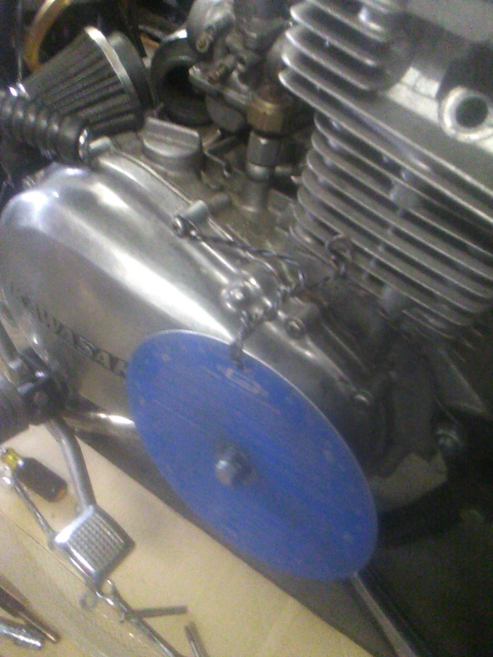

How many KZ440 LTDs have had thier cam degreed?
Swapped the reground cam out of Dr. Jekyll.

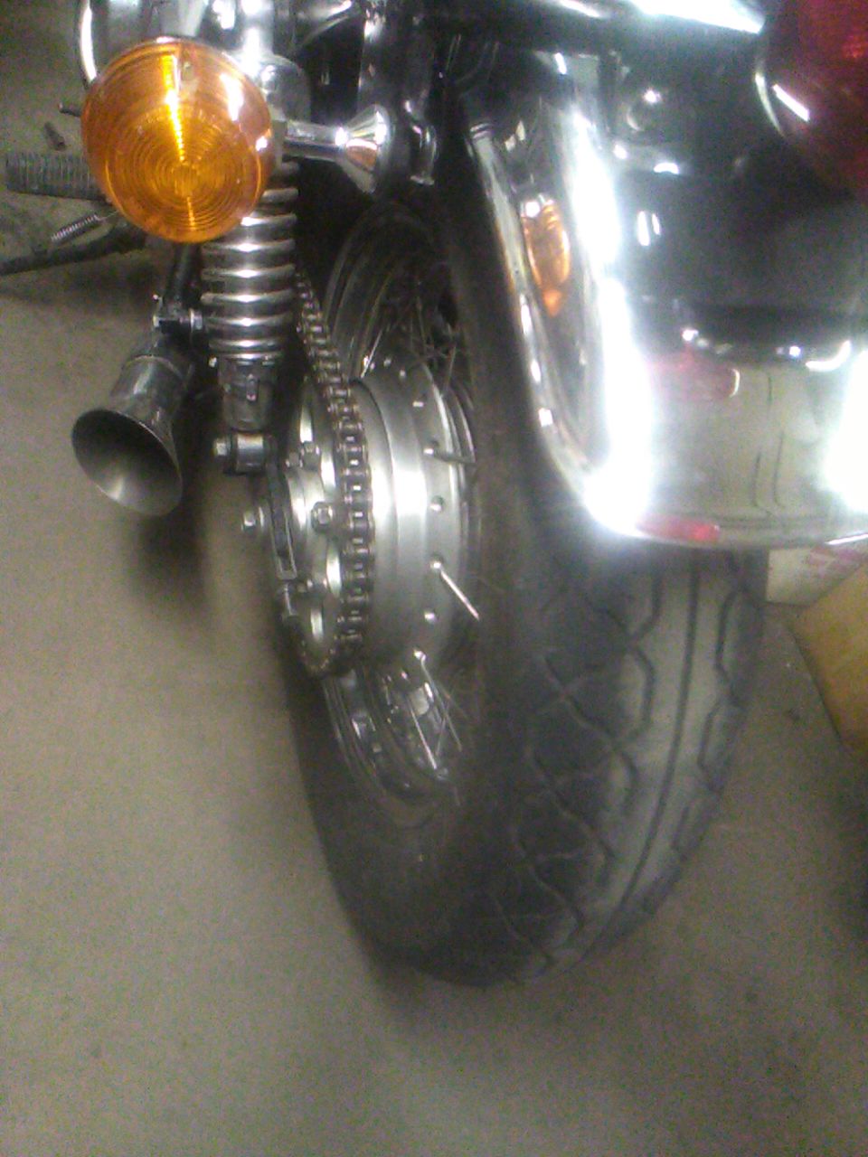

Been an interesting couple of years, working on the bike off and on.
I'll post some pics and details within a couple of days.
Looking nice and clean man! Did you recover that seat yourself?- it looks really well done
