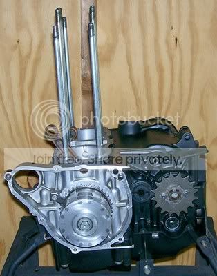

Yesterday I worked on getting the internals of the bottom end back togethor. I installed the new shift forks, the transmission, and the crankshaft back into the upper case and was able to seal and bolt the cases back togethor late last night.
Here is a photo of the cases back togethor.
Re: "La Pastinaca" CB450 New photos! Cases back togethor
I replaced all of the seals behind the sprocket cover including the shift drum seal, the transmission/clutch rod seal, the shifter seal, and the transmission/sprocket seal.
After all of the seals were in I installed this new 16 tooth sprocket.
I thank you very much for your comments!!!!!
Much appreciated Glenn.
When I asked Joey to take on this project, thru ought our conversations, it was obvious to me, that he is an indisputable subject matter expert.
I have such faith in his knowledge that I have subscribed to all of his recommendations. To top it all, he is gentleman and a top notch human being!!!!!!
As I have stated, and you have reiterated, this thread if for the purpose of sharing with all this build you all and to be enjoyed by all!
I have no doubt that Joey is doing an outstanding job and I am greatful to him and all of the other that have chimed in support.
