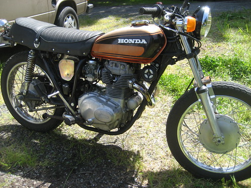

and here's a pic of the bike, it's got the CB tank on there because it doesn't have a crossover cable and makes working with it a lot easier than the other one.
the black tank does look good though, even though the PO did a really crummy rattlecan job on it.

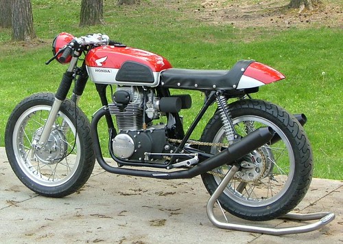

someday i'd like to paint the frame and have it end up looking something like this:

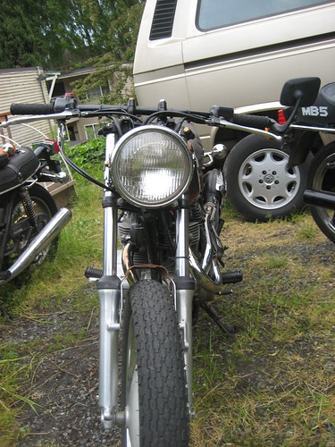

did a little work and the bike looks a lot different. super light weight.
actually i just bought a honda mb-5.
i did pull the guages off but it looks a little goofy with the headlight's current location.
i've got clamps to move the headlight down though, so that's the next step.
