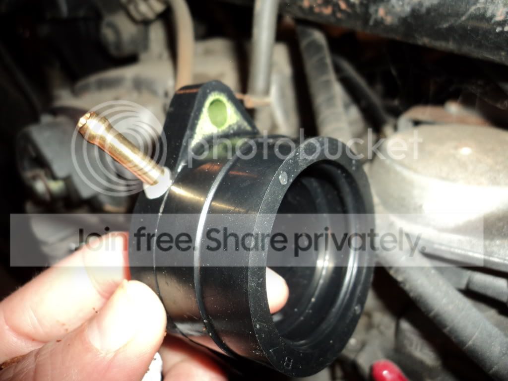

El' macho Borracho ran a single out let petcock. I dont believe a dual is needed. I would remove the putty and braze the hole closed, Or tap it and put a small bolt in it with a brass washer. Hard to tell though with out seeing what you are actually working with.
Von knows his shit, but I would have to disagree that the carbs are going to be starved. Remember, this bike gets around 50mpg. I'll bet if you were to unhook the fuel line from your carbs and open the petcock, it would put a gallon of gas on the ground in a couple minutes. Which is just an example to show it flows plenty.

swapmeet is correct. One line on the petcock is more than enough to deliver fuel to both carbs as long as there is no crud inside the petcock to slow it down. i've opened mine up (1 line with the other closed off) to drain the tank and it filled a gallon very fast. In fact the bike ran fine on just 1 line.

Yeah the gas cap is vented. The gas actually poured a pretty heavy stream with only one line. Anyhow, road the bike for about a year with that petcock until crud in the tank clogged the line and cut the flow down. I ended up lining the tank and purchasing a new petcock.

What? Look... You take the combined i.d. of the two needle and seats in two 360 carbs, and then tell me it's larger than 5/16.
