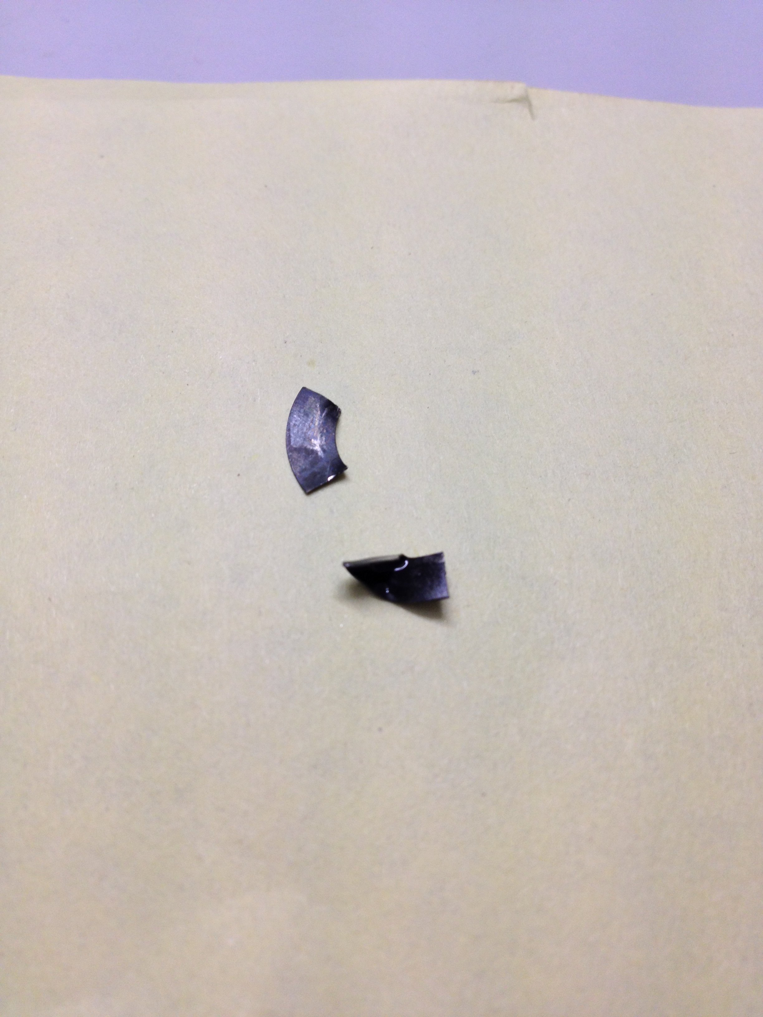

Update..... this afternoon I removed the head and cylinder to rectify the incorrectly placed thrust washer. When I turned the cylinder over to drift the locating pin out I couldn't see the washer. All sorts of thoughts ran through my mind like did it fall out of my hands when i was putting it back together? Did I put it in then take it off because I wasn't sure where it should go, then leave it out all together by mistake? It all became clear when I drained and strained the oil...... Feeling a bit sick at the moment with the thought of my extreme incompetence.

Sunrise4567 said:
Does everthing need to come apart now?
Drain the oil and see if anything else falls out; but I would think that a tear-down is advisable.
Fortunately it is about as simple as a four-stroke motor can get.
Crazy
I'd try just pouring some more oil in through the crankcase mouth and see if you can flush the rest out .
If that doesn't work might be worth 5 minutes with one of those telescopic magnets poking around - just a chance.
If you cannot account for it all it will need a motor strip as you don't want bits like that floating around - good luck with it .
