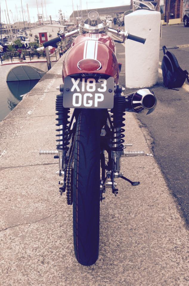

Colin chose his paint scheme, and wanted to keep the standard tank....we welded a plate at the back of the tank to create a smoother mating surface with the seat unit. We filled over the plate, which covered the unsightly seam around the back edge of the tank. We then cut off the ugly stock filler cap in favour of a Monza filler.

We had seen a lot of so called 125 cafe builds that weren't fitted with rearsets, and still had the stock pipe.....but that approach wasn't for us. We worked out that a high rise silencer wouldn't interfere with the rider's right leg, so we built our own header from stainless sections readily available, and routed it high, into a reverse cone mega. At the head end, we had a lovely little polished knurled collar made, to hold the header on.
We junked all of that crap that bolts under the motor to provide footpegs and both stands, and welded our own hangers to the frame for our rearsets. This created a problem, as we now had no stand....the new stand had to go on the right side, as the only place to mount it on the left, interfered with the chain run.
