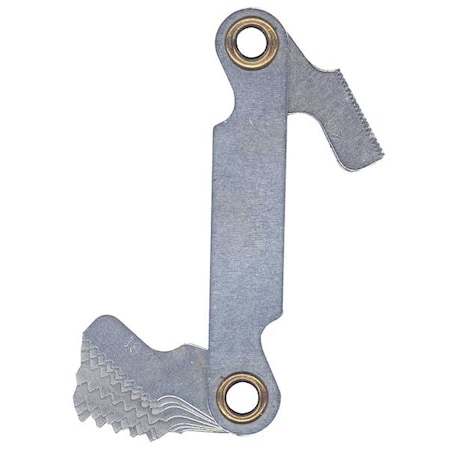

I have a metric tap and die set that I bought. It includes a thread gauge set that looks like a bunch of combs. You can use this to figure out the threads you have.

this is what I have -
https://www.zoro.com/vermont-american-screw-pitch-gauge-us-thread-counts-21939/i/G1957541/?gclid=CjwKEAjw_LG8BRDb1JTxm8uP_UwSJADu_8pWaciwX7iWqRoJUWHnPE5eTMLaaPGSKy83acyqzw1DLhoChYfw_wcB&gclsrc=aw.ds

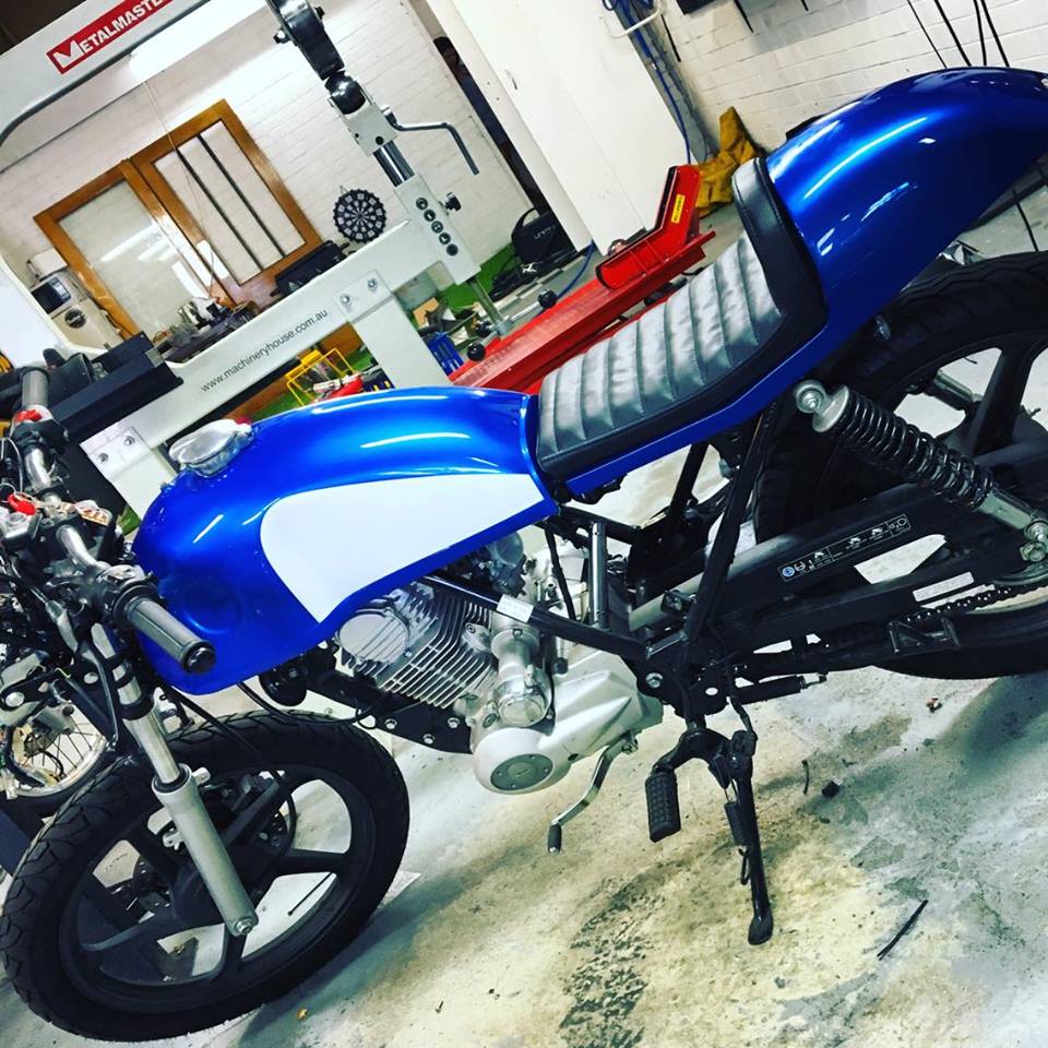

I am in the same position Mr Vroom, did you find something that worked? I too have bought the same tank from India and the taps (that leak fuel and have no reserve).

I bought a die ( or is that a tap?) and cleaned my threads. I used the petcocks off of a moped that have reserve, I was worried that they would be too small to feed a 850cc motor, but no issues there.
My only beef is that the one petcock hit the Cyl head on my Moto Guzzi and I need to use something like a screwdriver to turn it off when the motor is hot.
