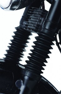

On any trip, costs need to be kept in check. But if you are having trouble justifying the expense of upgraded suspension for a long trip, just think about your average ride and how much you’d pay per day- per bump to smooth them out. It adds up really fast. In the end, if you’re more comfortable, you’ll be less tired. And that helps make you safer not on just those long days, but everyday. *Not really a performance part, but I installed fork gaiters to help keep the fork seals in better shape. -And they look good.

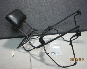

This was a real quagmire because Adell was adamant about having a backrest and we needed a rear rack for the custom tail bag she was sewing. But a product that had both a backrest and rack was universally extinct. Fruitless weeks were spent searching and emailing until by chance I found a unit that had it all on Ebay. A complete backrest, rack and saddle bag bar combo. Suffice to say, even though it was used and it was Ebay, it was not cheap. But we absolutely needed it. We planned to camp about half the time and stay in “No tell motels” to shower and whatnot. So we needed space for all the gear and tools and camping equipment. We couldn’t find what we needed, so we made it.
Sometimes you have to do that. To Adell’s credit, when she was finished, we had a bag big enough and complex enough to do everything we asked it to. -And it was bright orange with “hi-viz” reflective stripes to help make our two-wheeled RV even more noticeable. Again, safety is key when you’re over 2,000 miles from home.

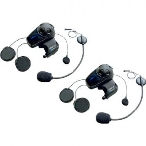

We used a pair of http://www.sena.com/product/intercoms/smh10/ units to share music and talk. It was one of, if not the most essential part of our gear for the trip. I cannot stress how important it was/is to be able to effortlessly communicate.
The miles rolled by so much more easily while sharing music and managing navigation and talking about the environments. She could research stops and detours on the fly with her iPhone. She pointed out exits and hazards like a true co-pilot. I know the pleasure of isolation and zen a motorcycle can bring, and I still had moments of that on the trip, but it was so fulfilling to share the experience of the trip with someone else just by talking to them.
