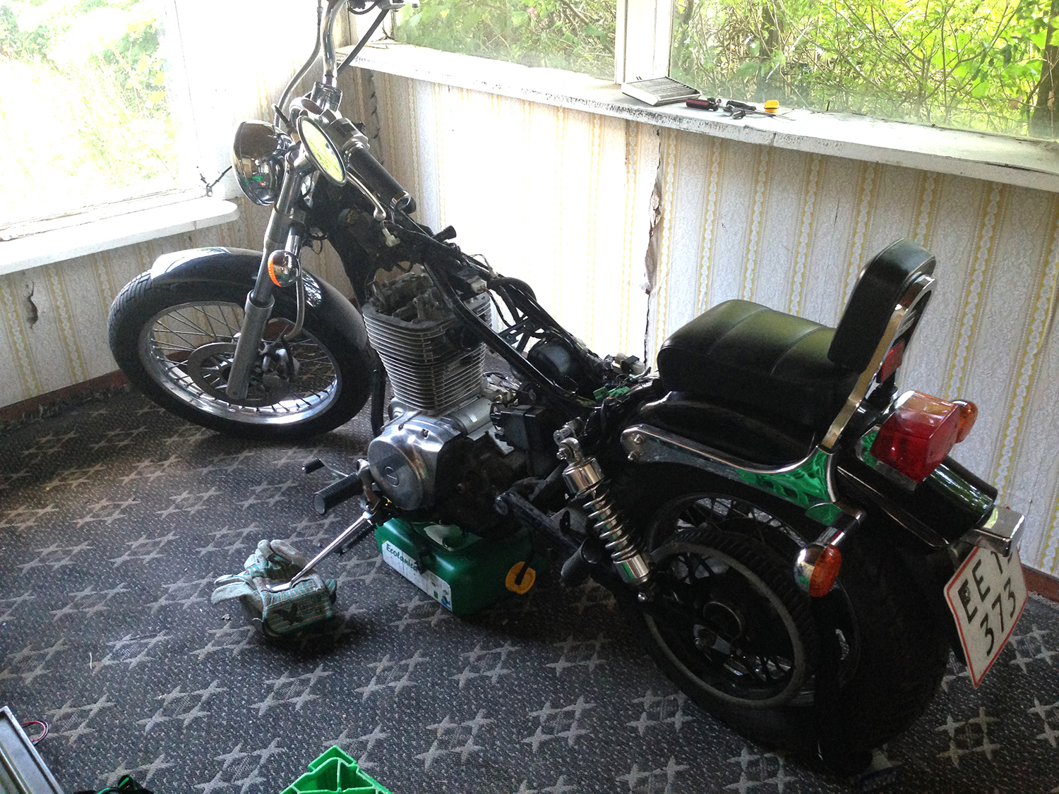

At the building where I live we have an old gardening shed out back, so set up shop there this afternoon and got in a few hours work on the bike. Figure I do the shed a favor cleaning it out and using it for a while, rather than letting it fall into disrepair.
Got the tank, carb, exhaust, belt and battery box off, and am more or less ready to lay the bike on its side tomorrow to get the motor out. Love working on simple bikes like this! ;D

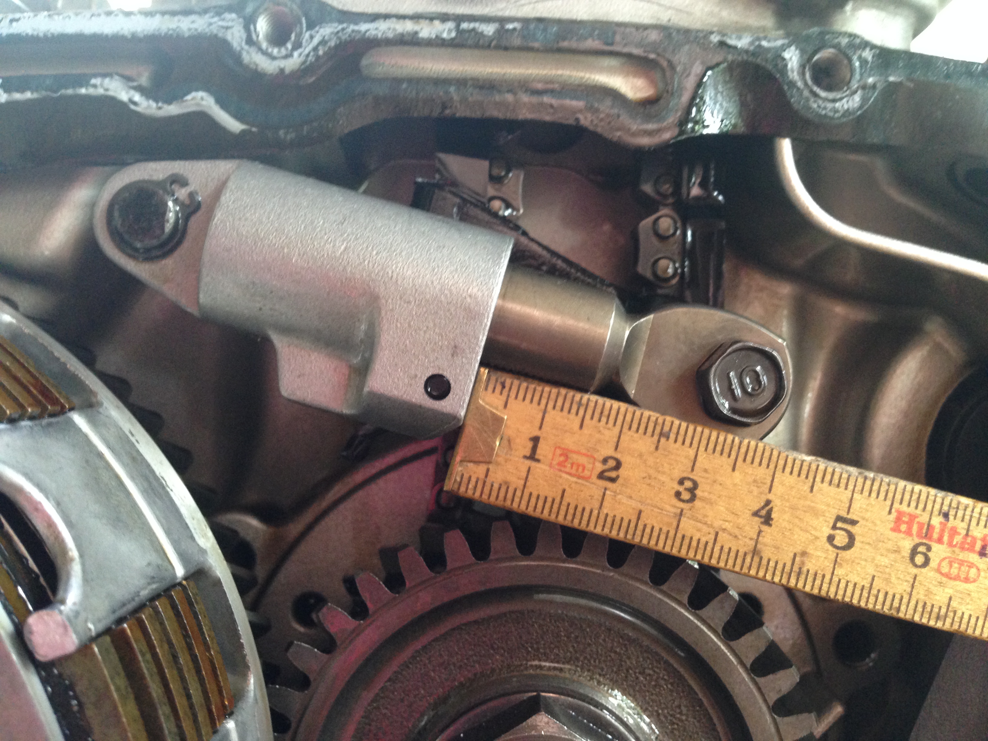

Got the motor out today and opened it up to get the cam off to be re-profiled and the barrel off to get bored out. It's clear that although run intermittently it was well cared for. No major signs of friction modifiers used in the oil inside the casing. The rocker faces still have their original machining clearly visible and so does the cam bearing surfaces. The barrel still has clear honing marks and the piston has only minor signs of rocking. While the piston has some carbon buildup it's to be expected from a bike which has been run with older gasoline.
The cam chain adjuster was out to a smidge under 15mm, with very slight ovalling of the housing which is a sign that it is overextending, why Suzuki would willingly install adjusters like these on their engines are beyond me. ???
Does anyone know how to clean of that carbon so I can use this honking piston as a candy bowl? ;)
