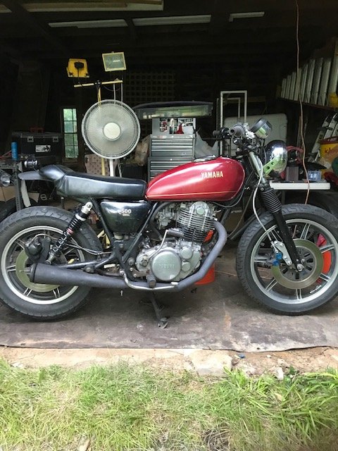

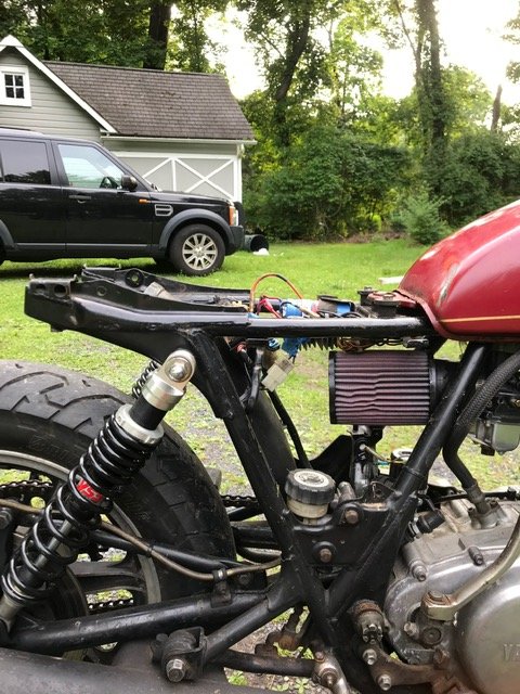

I’ve had this bike for a little but just getting it going.
Stator is good.
It’s getting a nice spark, hard to start, idles, and then dies.
Re cleaning the VM36 tomorrow. I’m hoping the float needle/jet is the issue. Only thing I didn’t change out.
3.0 slide this should be a 2.5 according to cxman.
25 pilot
2.0 air jet
220 main
6DH3 clip two up from bottom.
The bike won’t start with the mix screw turned out 1.75 but I’m thinking the carb needs a going over again. K&N RU1760 filter and a kerker w/4 discs
I do have a stock vm34ss with all new diaphragms but it’s a pain in the ass to to deal with. I’ll probably sell it for new seat money.
I checked the valve clearances, stator (results available if anyone cares)and spark is there it does start and idle every four or five thousand kicks.
