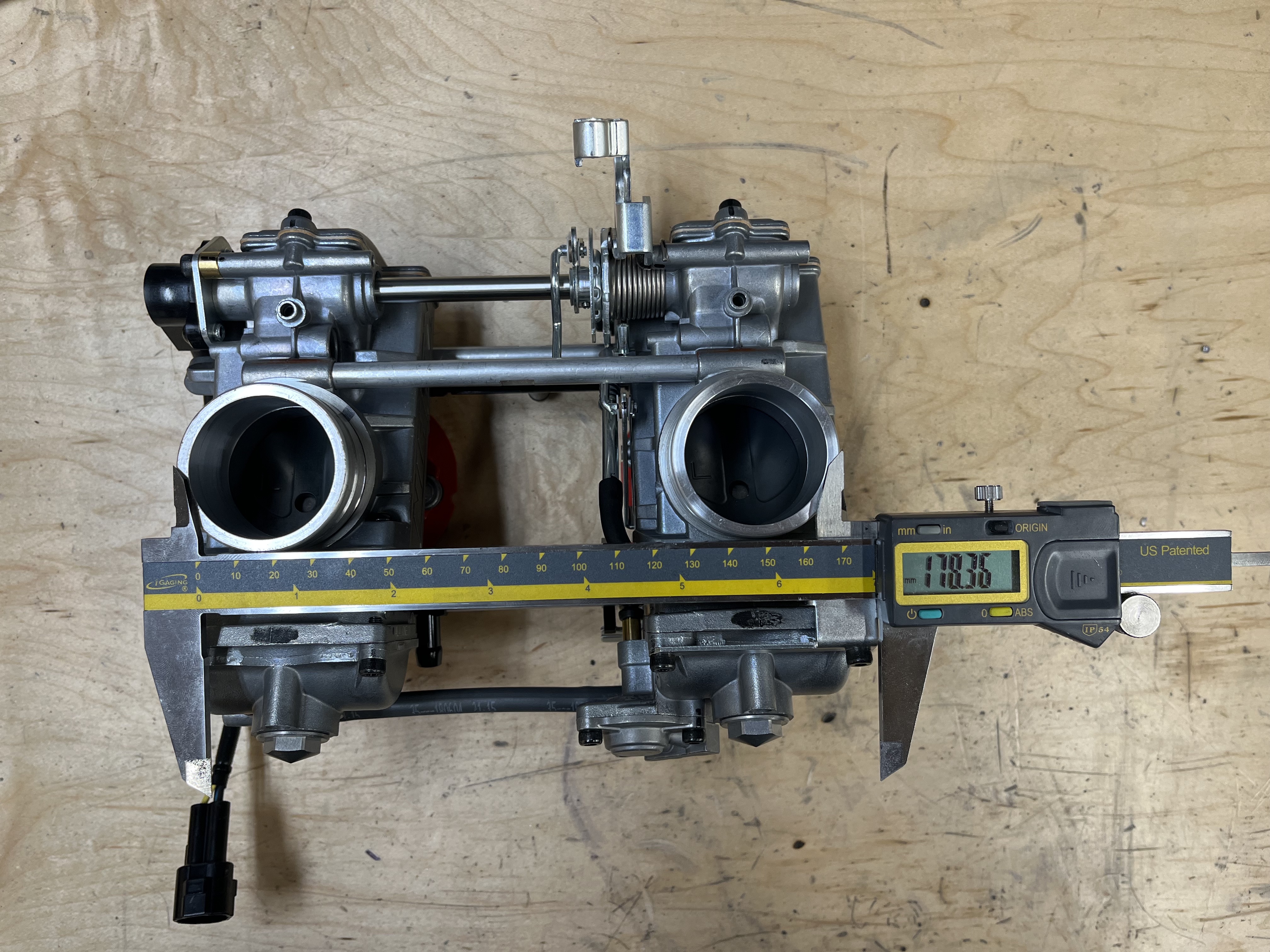

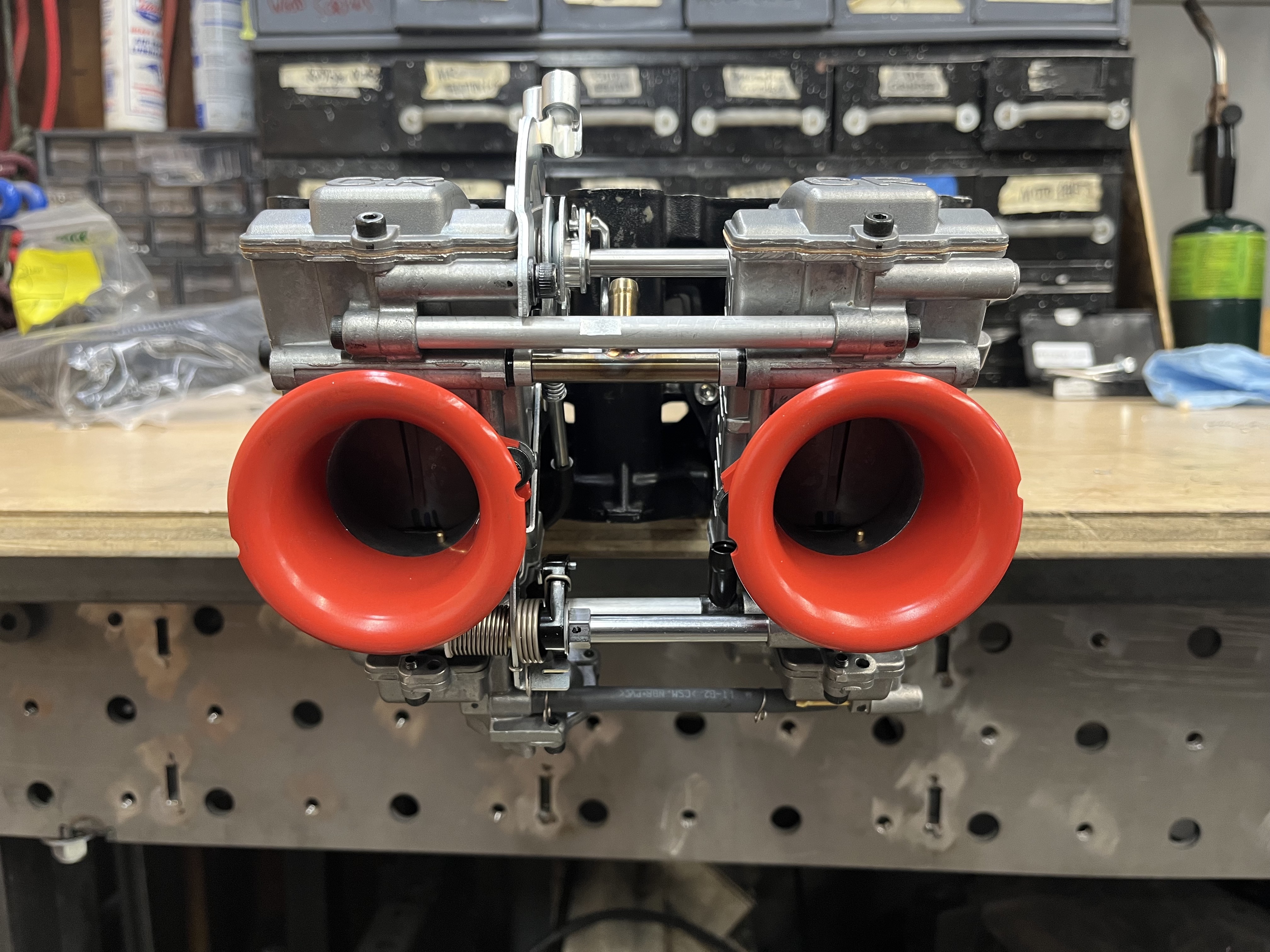

carbs for Bonneville 900, reduced the spacing by about a 1/2" to fit port spacing of KZ750. I also turned new spigots to fit in the stock carb boots, blocked off TPS, etc... lots of fiddly little bits. I still need to port match the carb boots to my ported head.

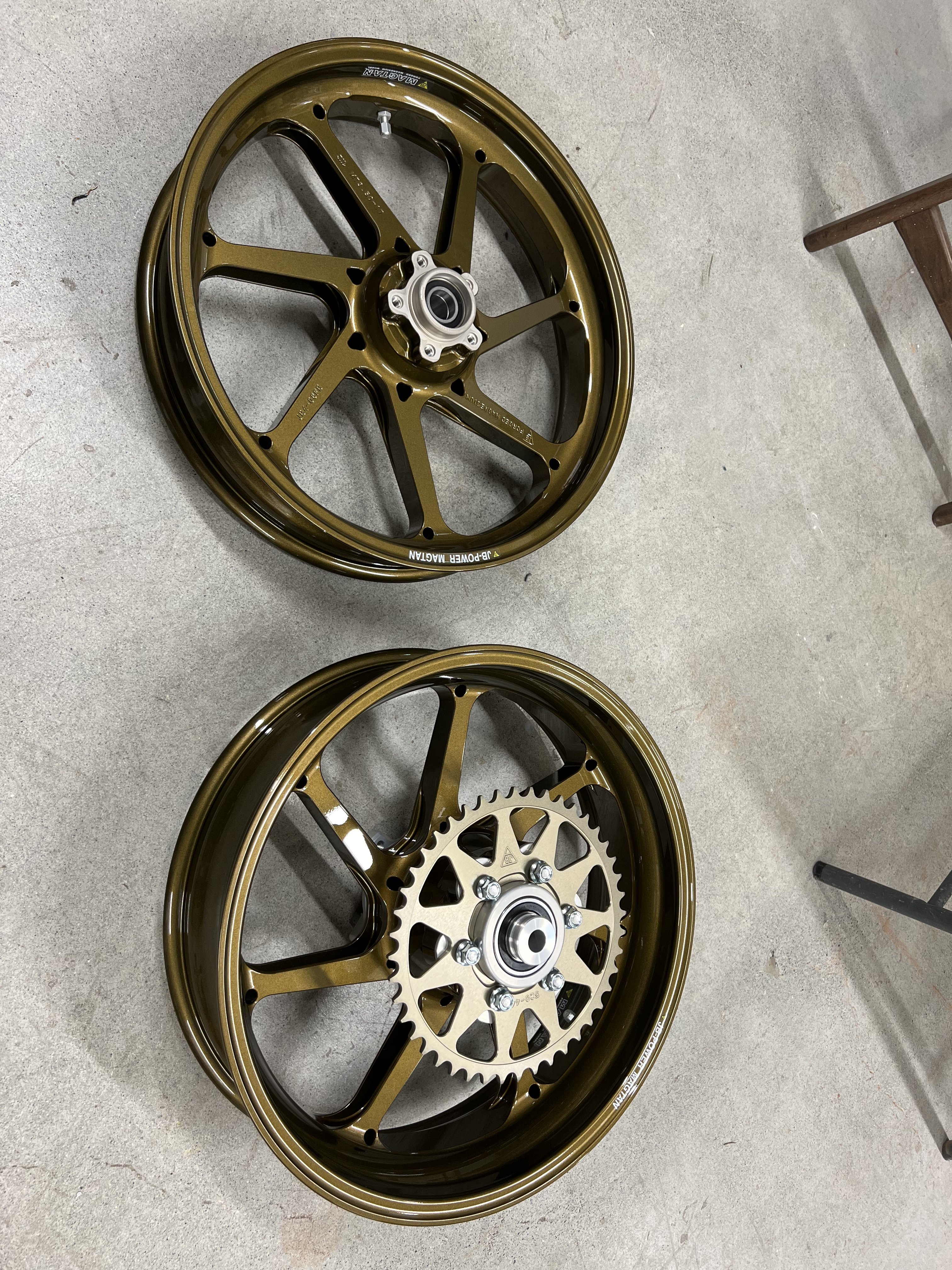

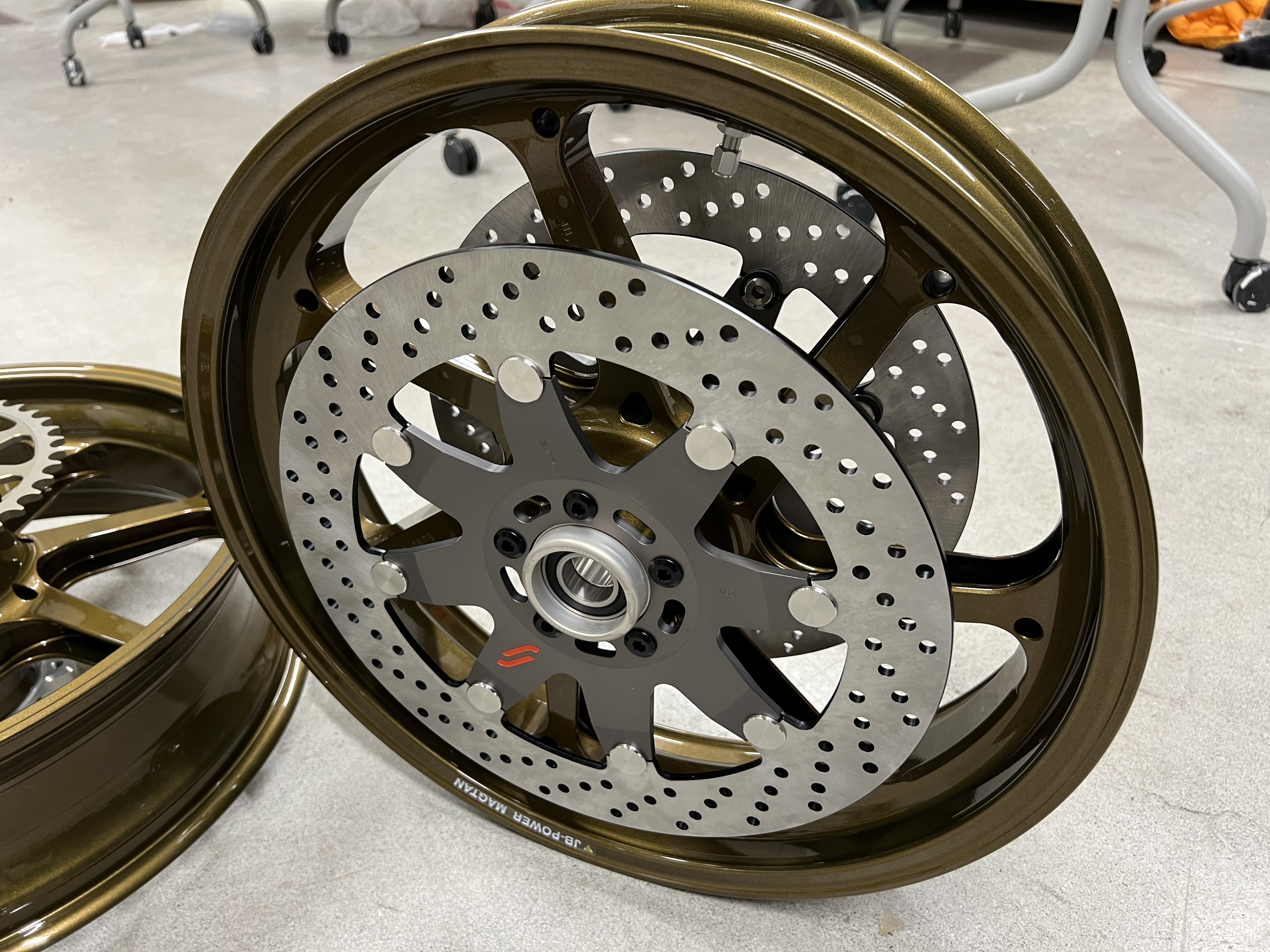

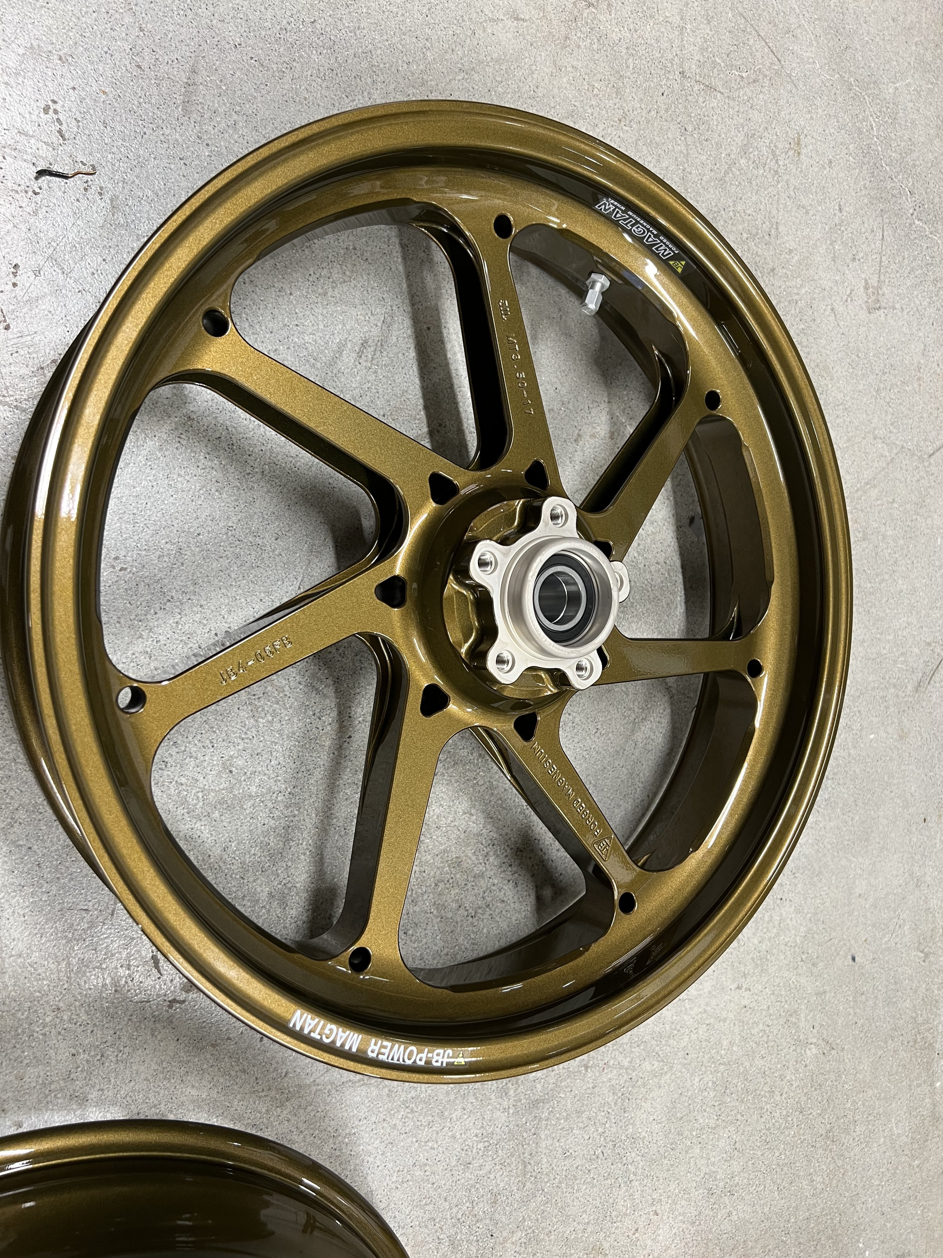

This is where the “poor financial decisions” portion of this build comes in to play. Custom color on the wheels.
20403ABA-FF6E-48F1-8AB8-2C2A6D04832A.jpeg659D31BB-4B23-4C0C-A0BE-C28204E48F3A.jpeg7BF98DBC-076B-48E2-B46B-8471EDAB76F7.jpegAE111082-69FE-4005-87FA-464E1F0155DE.jpeg7A688DD1-E770-4528-A4EB-DFDC7110734C.jpegD28883E0-8013-4268-B077-A4AE10F56B88.jpeg
