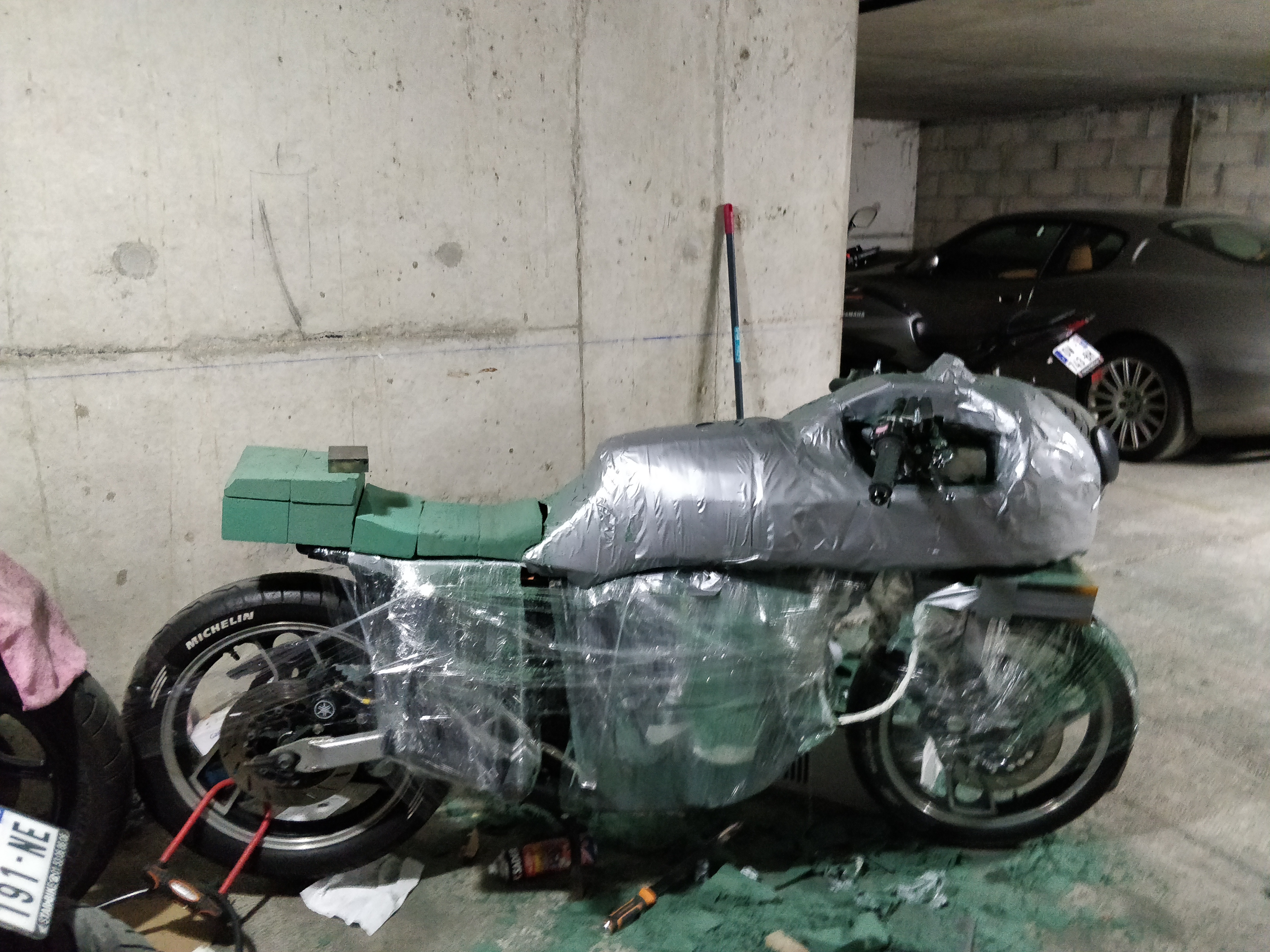

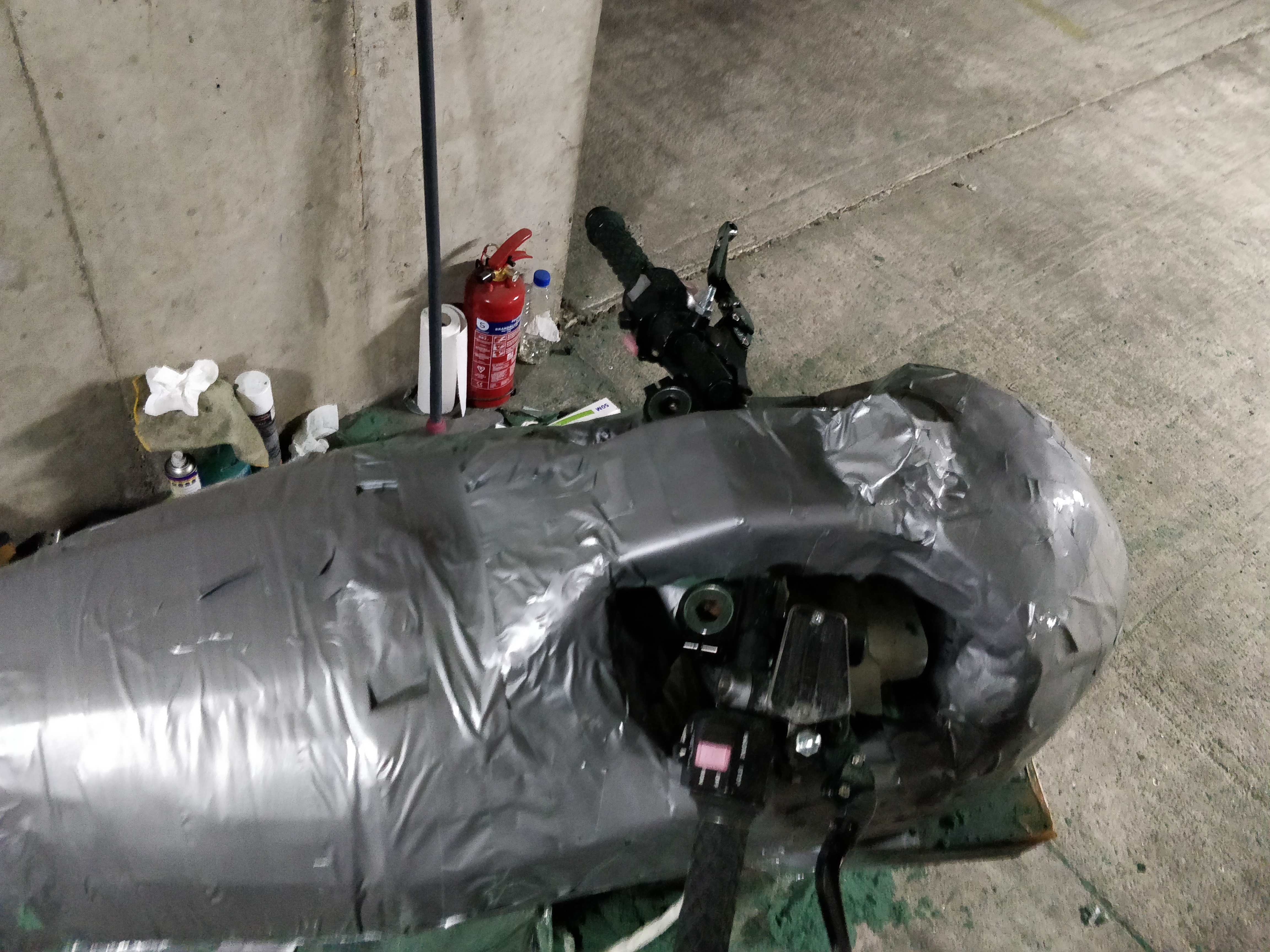

But I'm having real trouble with the foam over the tank, and its very difficult to do the exact same shape on both sides... So I guess I will have to to some filling and sanding job After the Glass.
Here is my current progress

Maybe it is time to take a step back, get a beer and think through how you want to proceed. If I recall correctly, advCo has classical skills and consequently good advice doing all sorts of fiberglass and mold making. I hate making molds and consequently have a less conventional approach. I think with what you have so far you will have a great deal of trouble removing your work from the bike and then removing your new part(s) from your mold. When I do work like this, I have no ambition of ever being able to "remove" the foam form or mold from the project, at least not as a single piece. I remove the "mold" by simply carving and grinding and sanding it away and basically reducing it to chips and dust. Messy, but fast and easy. You may be able to achieve a similar result using packing tape as a finish surface before the glass work (pretty much nothing sticks to packing tape except, well, more packing tape!), but all that duct tape and then the packing tape will make even a very finely crafted "mold" become pretty crude. Keep in mind that laying laminates of glass over anything will make it lass precise, so starting with anything than absolutely the best you can do is very counter productive.
It is true that pretty much any degree of bad result can be ground down, sanded, reshaped, filled and reshaped, refilled etc, etc until satisfactory. If you started again, and again, and yet again from scratch, you would still be doing far, far less work than I have seen guys do to remedy a starting with a initial form done poorly. The notion of "It will be fine, I'll fix it later" is a dreadful path and invariably results in a barbaric and monstrously heavy part.
It is obvious that you have a lot of time and effort to get where you are, but in my opinion you will be very well served indeed to give it another shot and start again from scratch. You will be able to re-use most of your foam, and now that you have a scheme to get things started and attached to the bike, as well as a fair bit of practice, starting again will be vastly easier. Easier as in only 1% of the effort it will take to massage glass work over what you have now into what I am sure you have in your head. I think it matters not at all whether you do your glass work directly on the foam, or wrap it in packing tape barrier first - either way you will be well served to start with a much better form on which all the rest of your efforts will be based. Keep this in mind - the best composite fabricator on earth will still make garbage from a rubbish form, and even the most inept novice will look good starting with a flawless form. It is an unhappy fact that 95 % of the work in composite fabrication is in the mold making. Whether it is in creating a one off foam form like you are doing, or building negative molds for making multiple pieces, the vast majority of the expense and effort is in the molds. Making the part itself is hardly worth mentioning in comparison, as that is the gravy work!
Im not an expert but if done some glasswork... If I were you I would simply use a good car wax and wax the heck out of that duct tape and start laying up... Yea you will have more work getting the farring smooth but laying up thick and an random orbital sander will get most of it done...bondo to finish.. If you were making a mold so you could make mulitiple farrings then I would agree with the previous posters .. Its a one off and your just learning... If it dosent turn out the way you wanted you can adjust your method..
I say it wont matter much .. If you dont use a mold and gel coat your looking at alot of finish work anyways.

Well, it will sure be a pain to re do all this job... but hey, I'm here to learn anyway.
So even if this took me a lot of time, I can start again, however, I'm not sure how I could do better, beside not using packing tape?
Could you point me (on my pictures for example) the bad parts I've done and needs to be improved?
I am pretty happy with the front part, the foam under the duck tape is actually very smooth, I used duck tape only to protect it. The very messy part is all the area over the tank and where the front part connects to the tank. This was extremely difficult to do because it is a ton of tiny foam pieces (sometimes as thin as 5mm), and I don't think I could do better than this with the skills I have :(
So I have no problem replacing all the duck tape with packing tape, but I don't really see how I could improve the tank part.
Oh and the tank itself is also part of the mold, all the top of the tank is part of the mold, I will just glass over the tank to just have one huge piece that goes over the tank and make the fairing.
I don't really mind if my mold gets damaged when removing the glass, well execpt for the gas tank part of course lol, but won't I be able to remove it by carving the foam out and using a lot of packing tape and release wax on the tank?

I'm not sure how you're planning on installing/removing the fairing because of the way it wraps around your handlebars. From the looks of it you will have to remove the handlebars to slide the fairing off? You could split it down the middle and glass in a flange and have your fairing be two halves.
I'm glad you are mentonning this, the goal of my design is also to leave people wondering "how did he put this on??"
In fact, the bars are clip ons bars an I can literally unmount them in 30sec, without loosing any settings. So I just have to remove the bars, slide them through the fairing and remove or install the fairing :)
