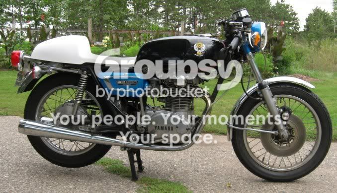

I am looking for opinions. Will a Manx style of seat look alright with this style of tank?
I was intending on running the fiberglass tail section in that picture, but am not coming up with a goo way to mount it and make it look like is is supposed to be there. The XS frame is too wide towards the front to fit the tailpiece over the framerails. I could cut the fiberglass, but started thinking maybe the Manx style seat that Clubman Racing offers might look better. Looks like they offer it in a longer version w/o the oil cutout. Just having a hardtime picturing it. I've already removed the rear fender and do not intend on putting it back on. Open for other opinions also...just trying to keep things on the cheaper side and really cannot afford an alloy tank.
What year frame is it? I have the exact seat you have pictured (Manx) and it's a perfect fit on my 1972 XS650 frame.

Your bike and the way that seat fits it perfectly is the whole reason I am considering it! LOL My bike is a '73. The fiberglass tail piece has the look I wanted, but I am afraid it won't look right on my TX. The frame rails are too wide for it. I was thinking the wide, longer manx w/o the cutout might fit better. But figured I would see what others thought of that seat/tank combo...

The price actually isn't bad on this one, so I would probably just get the complete seat. Looking at the picture you posted, I think mine would be very similar...minus the rear fender. Wasn't sure how it would look w/o the alloy tank, but I'm likin it!
Measure your frame carefully and call Frank at Clubman's, he'll hook you up.
Thanks....I will do that.  I know the frame is 10" wide up to the last little bit by the tank.  It angles in there.  Basically looks identical to  Tim's

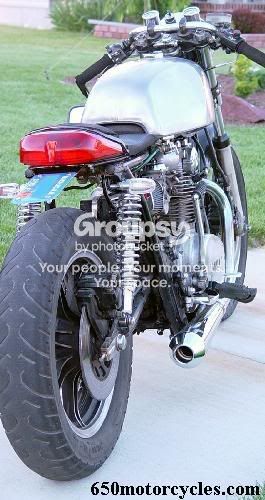

Does the seat wiggle and move a lot mounted on foam like that? I am hoping to mount the seat low on the frame, but my 750 tank has a cutout on the back I am going to need to address. You can see part of it in this pic of another XS with the same tank...could always just block the hole off like this guy did:
