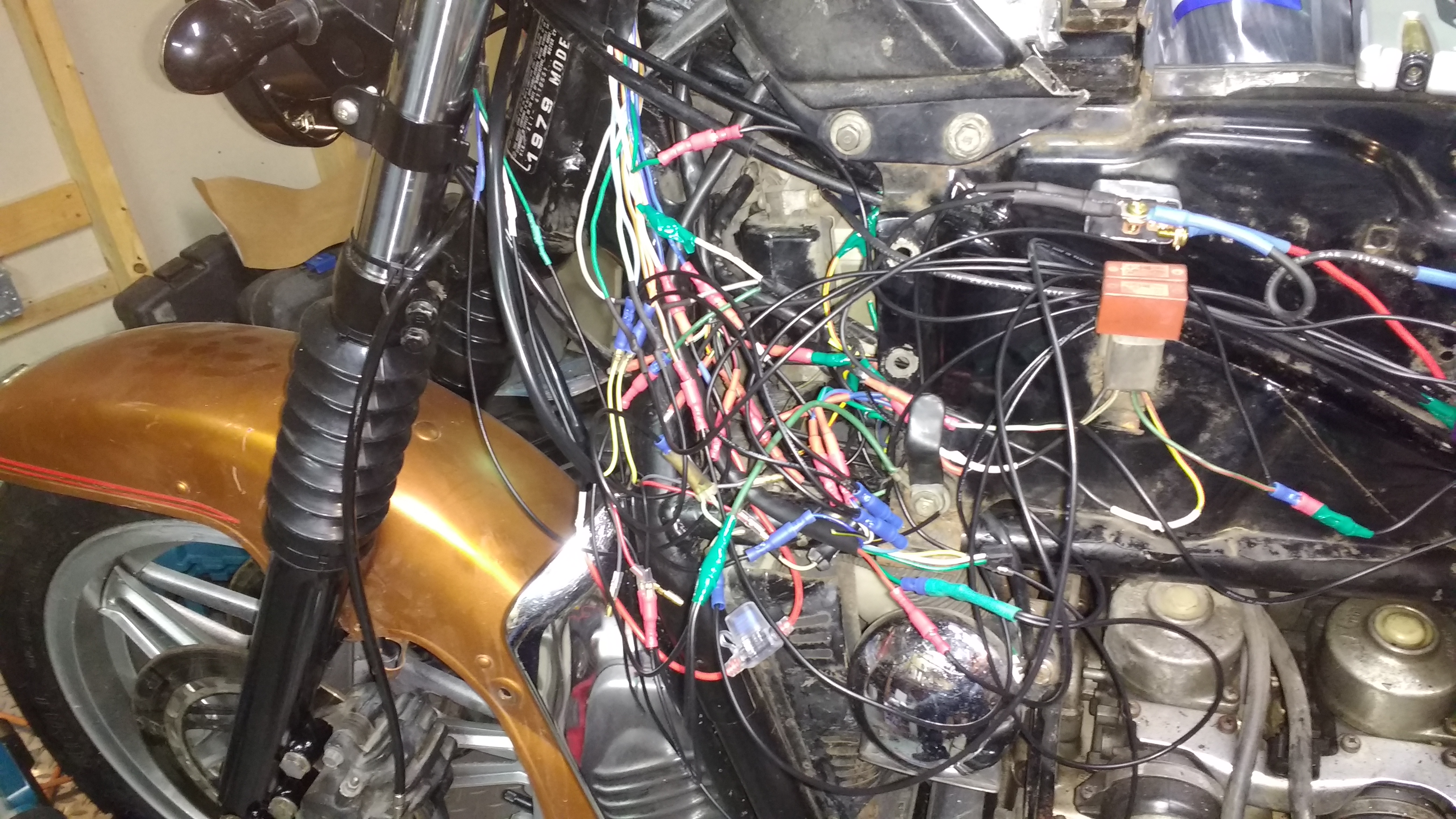

I got some more wires done. Nothing pic worthy yet. Got interrupted a bunch so stopped for the night. Once I run some grounds I can power up the circuits I have and see how they look.
Look at this mess. Man I need to get this shit wrapped and tucked away. Left to do is the speed sensor, tach, and rear lights, tail, stop and turns. Used 3 circuits out of he fb11 so far and it is really straight forward. Like it so far.

None of my indicator lights work on the gauge. It powers up fine but when I hit high beam or signals they don't light and they are hooked up correctly and power is there. Anyone else ever use one of these? Instructions are shit that came with it. I need to hit Google.

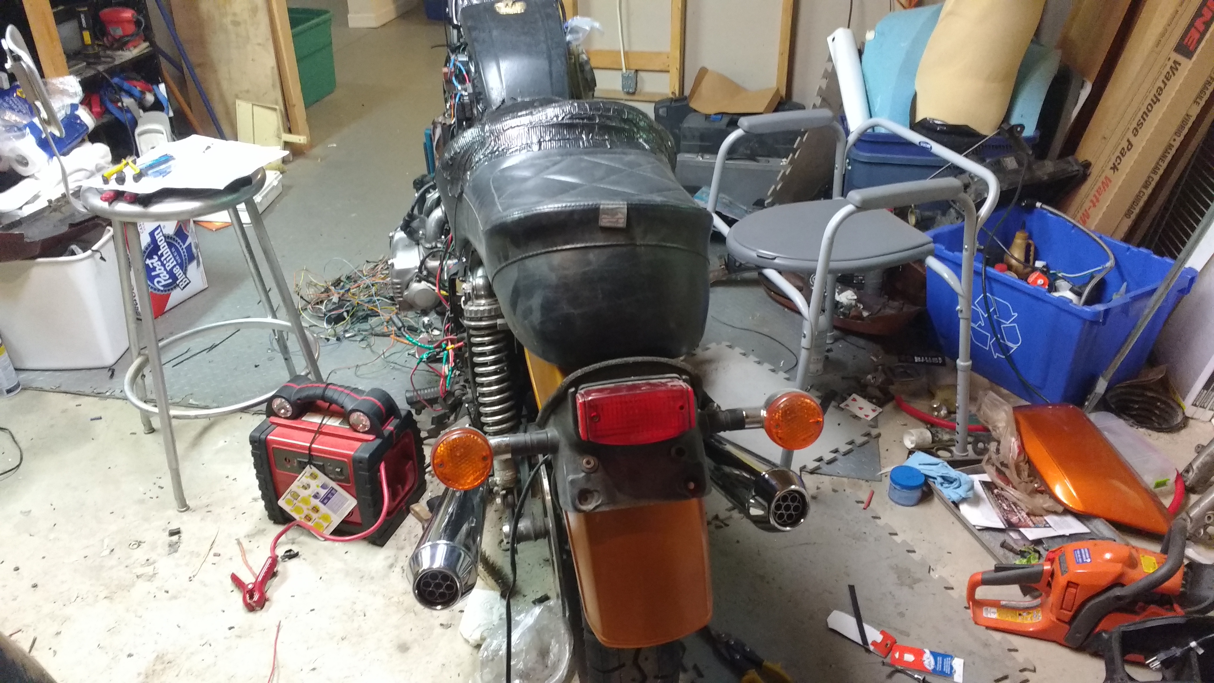

Ok permanently fit fender seat on and donated lights. Not exactly what final will be but will get me riding.
So the 35$ headlight had some issues the plug came wired with low as high and high as ground so it lit all funny and made the high beam indicator always on. I decided to compare it to mother Hondas and found the problems cut China connector, put Honda, boom proper headlights. Also sorted the gauge indicator issue. They don't tell you but one power wire is 12 v always on and one is ignition. So thanks to Matt's (Spark moto) fancy board I ran the 12v always on out to the gauge and connected the ignition switch power and it now works. Need to figure out where to put speed sensor and magnet, then which wire for the tach, wire in tails and it's ready for brake bleed fluids and a test ride! Fuck yeah!
