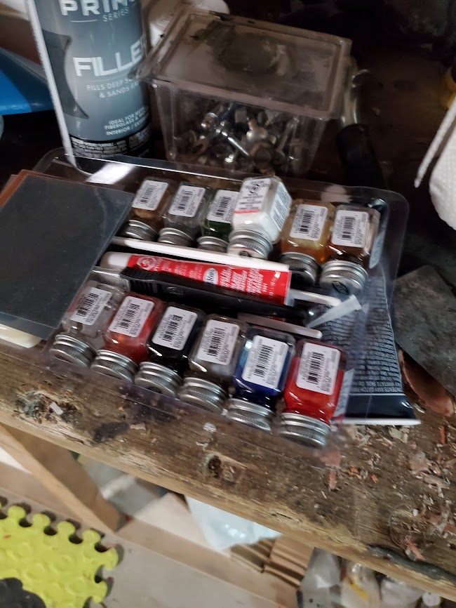

Seat Attempt 1 was a bust. I need to get more vinyl and borrow a better machine. Mine did one good row then would all go to hell. while I wait for some piping and a chance to go buy more vinyl I had scored a testers paint set and am enameling the GL1000 badges we printed. Nice little kit for $6.99

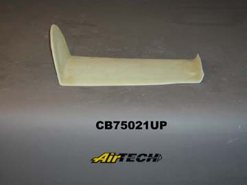

The emblems look great. Are you attaching the foam directly to the seat? In the 80's I was a partner in a fiberglass company. We made seats and a bunch of other parts. The race only seats were most often foam glued or are attached by velcro to the seat. The street bikes normally had a separate fiberglass seat pan which was upholstered and then attached to the seat. Airtech calls these seat bases "upholstery pans". It makes creating a street seat a lot easier. Here's a picture of an Airtech CB750 upholstery pan to give you an idea.

I Thought about that but the seat was already covered and has the holes. Also the old foam and some riv nits would have made doing the pan a pain.
