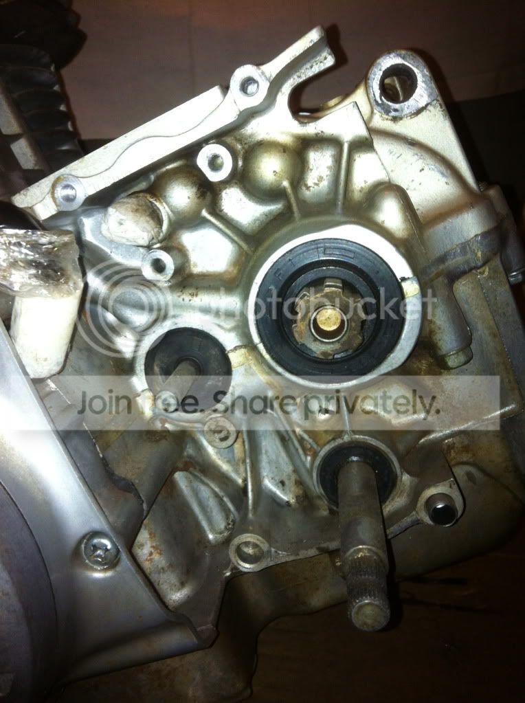

Here's a few shots to give you an idea of where I'm at.
Fox - Swan:
I'll keep these thing in mind. the places i have taped are places that are not going to be blasted, the tape is there just to help me from getting too much glass in there. so i hope it will be good enough.
This is my first try at mediablasting, and i'm a bit scared :D
And fox: your engine looks more or less like mine does. We're in the same boat here.

Got the engine blasted today, BUT when i took the damn thing apart i didn't get the one gear drum out due to sucky bolts. so i blasted the engine case with this thing still inside... the masking i did was good enough but some got inside anyway. i used about twice the time to clean it than blasting.
The result was beautiful!! :-*
Tomorrow i will take another hour to get all the glass out with brake cleaner and compressed air.
Pictures will come then..
peace out from the glass blasting conquer :)
