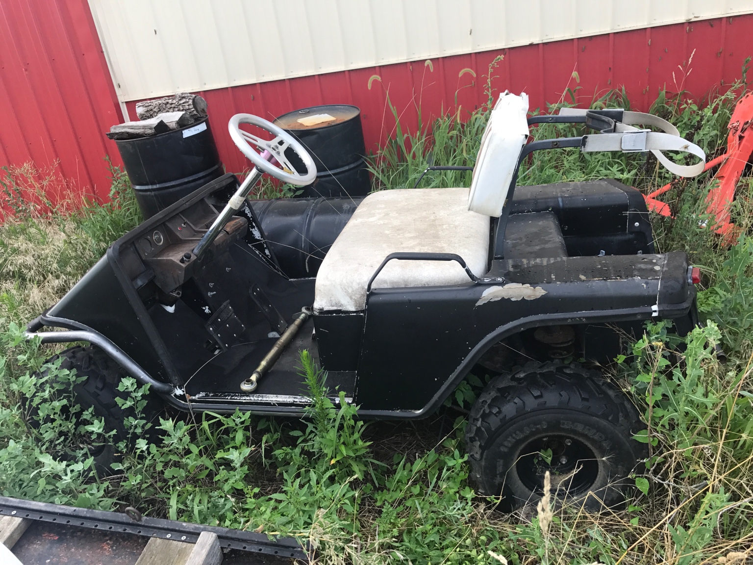

irk miller said:Hey Dock, looky here. A complete Fiser front end offset with spindles. It happened to be on eBay for $95. All this costs about $350 off the shelf. Looks like we're mounting this beast on the right side.

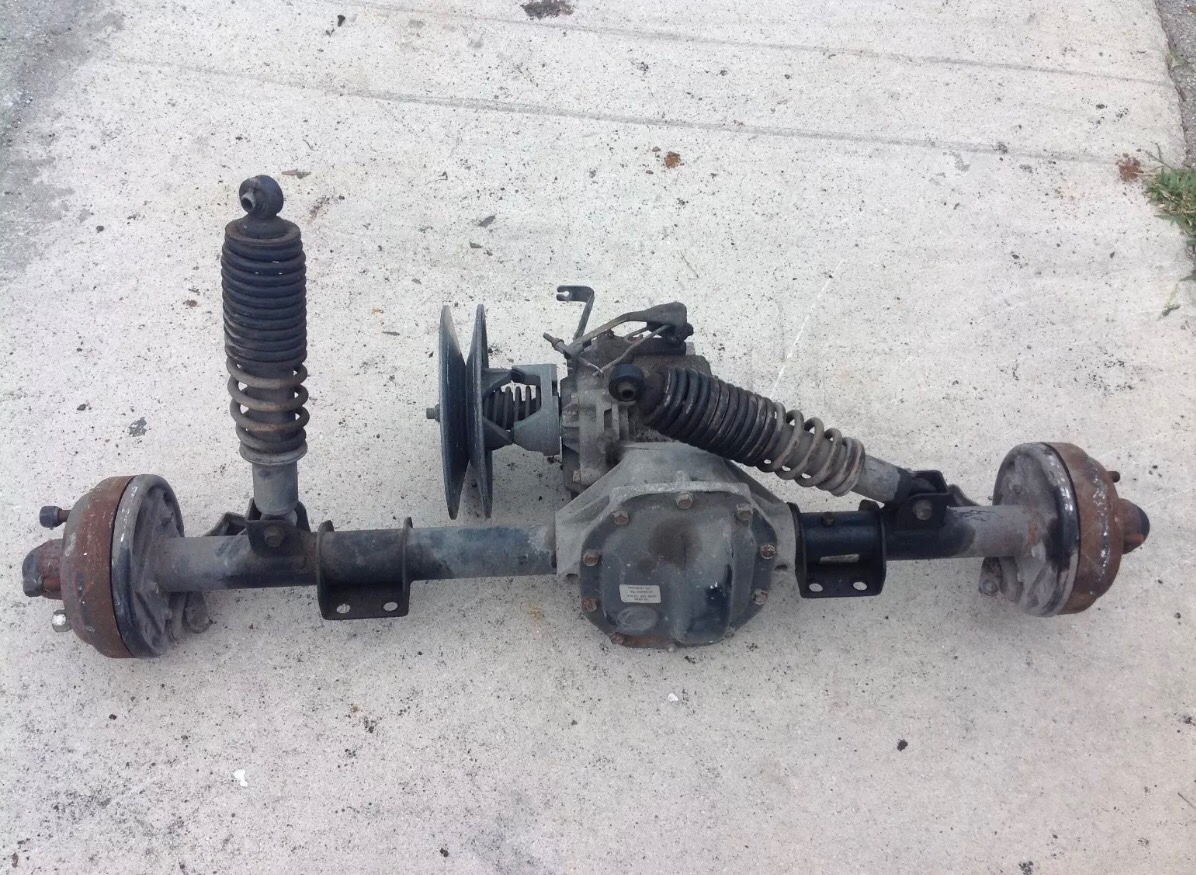

Tune-A-Fish© said:I wonder if you can find a rear end where you could run the motor sideways and chain drive to driveshaft.

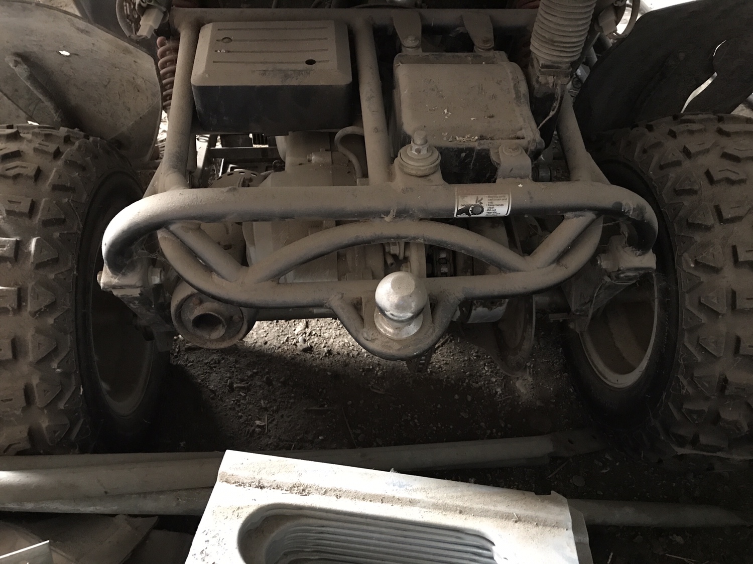

I would think so. I'd wager as heavy or heavier than the rest of the cart minus the motor. Most have an input shaft parallel to the axles, too. What deterred me from quads (or 3 wheelers) is wanting straight axle and a 41" width.farmer92 said:Those golf cart rear ends are pretty hefty compared to the rest of that cart though, no?

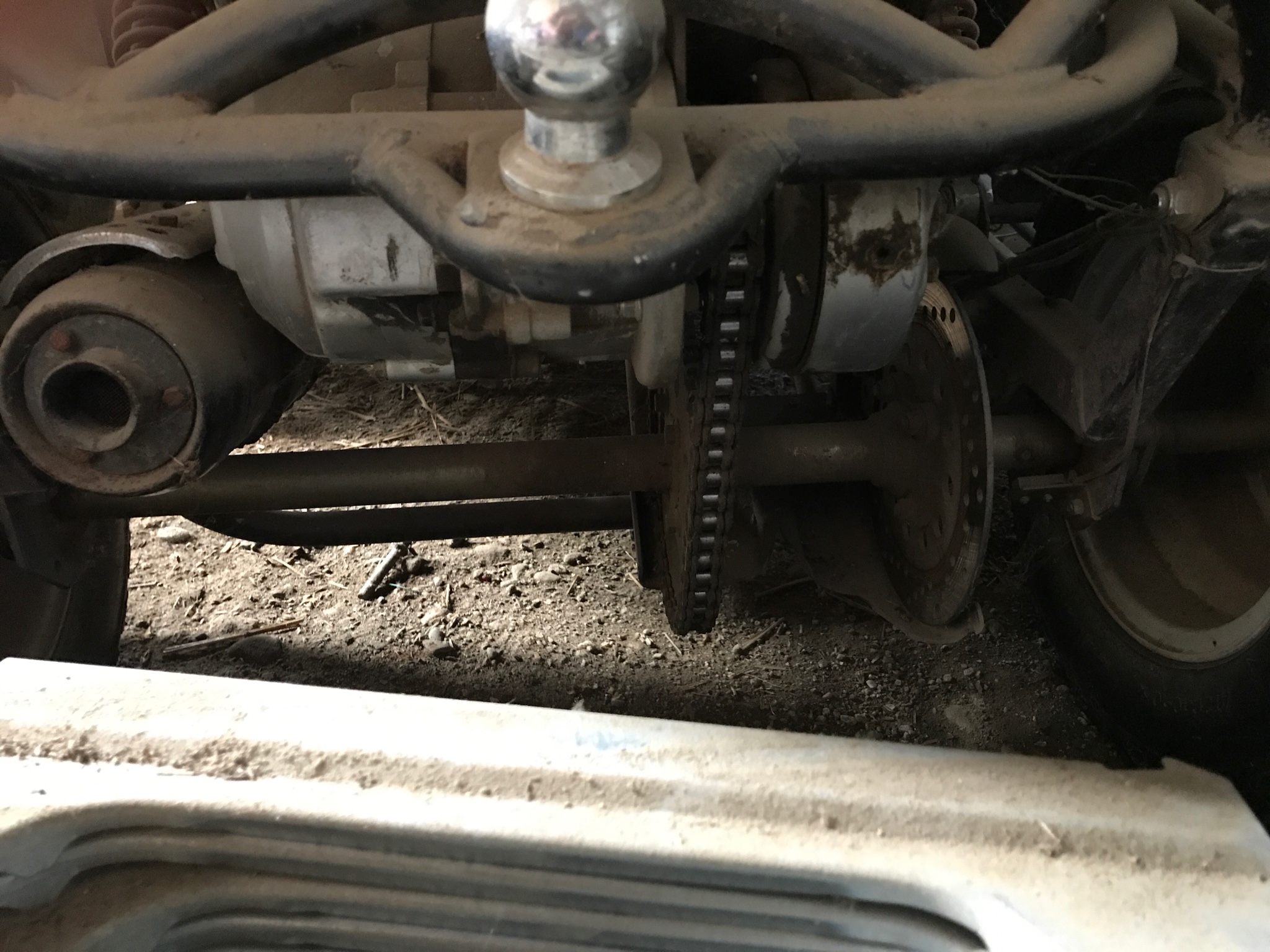

What's the width on that axle- hub to hub?farmer92 said:Sorry i it's hard to see there, but thats the set up on my Chinese shit buggy.
Hondalike scooter engine and cvt turns the foward/reverse selector, which links to the axle via chain drive.
Maybe you could run a jackshaft as last resort.
