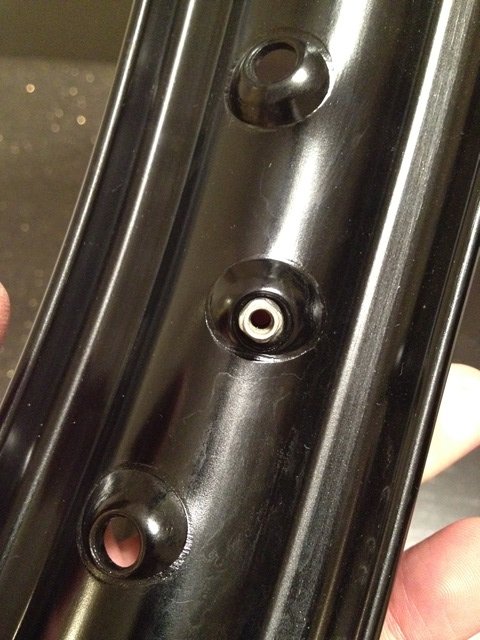

well, contacted Mikesxs and they confirmed that the holes are made out to 0.25" nipples. So, went ahead and ordered a set of 2.15x18 and 2.15x19 rims. Will report back on the fitment and any issues if there are any. Thanks everyone for their input!
Alright, here is the verdict. The rims have arrived! I measured the nipple holes and Mikesxs rims are 7.50mm. The holes vary a little but the largest one I measured was 7.55mm and the smallest one I measured was 7.32mm.
My stock CL175 WM1 1.60 rim nipple holes measured to 7.03-7.10mm.
I tried fitting the nipples into the mikesxs rims and they seem to sit pretty well. There is a tiny bit of wiggle room there, you can feel that extra 0.30mm but it looks and feels perfectly fine for me.
In the pictures you will see how the stock nipple fit the rim.
The stock nipple measured to 6.80mm at the base.
Hope this info helps out someone in the future.

here is how the stock set up looked like, stock nipples in stock rims.
