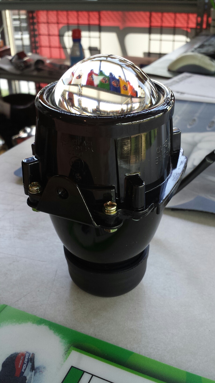

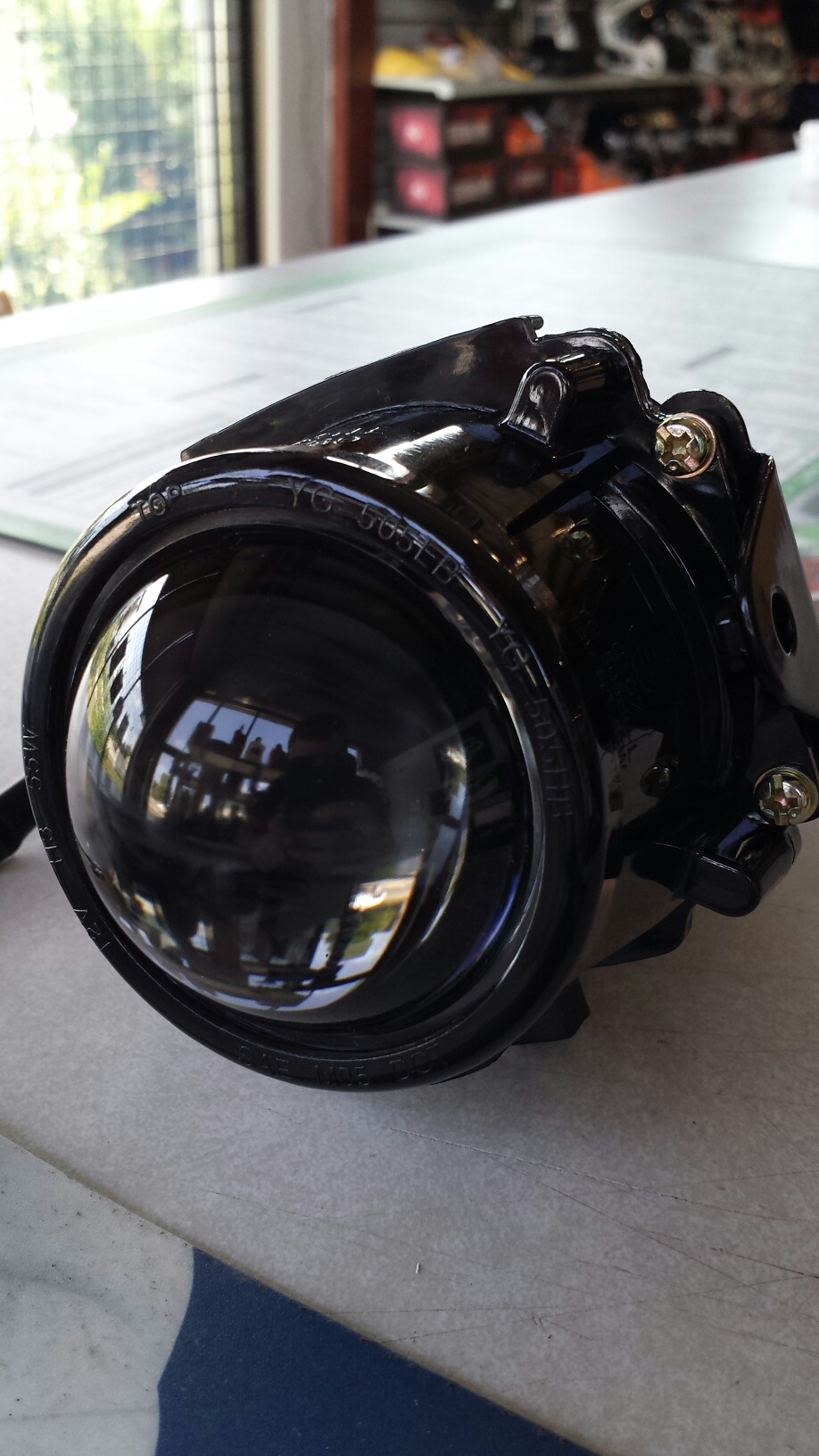

The shop I work at has had a few of the rigid industries setups come through. Unfortunately we didn't get to see one in action, but I have to say that the build quality was impressive. Everything looked and felt unbelievably solid. If the dually 2x2 came in a round version I would have included one in my build for sure. As far as the Madass headlight goes, It might benefit a buyer to find a dealership that sells the parts and just order it from them. Another guy at the shop here just ordered one Monday. It cost him $157 and that included both low and high beams, both side brackets, and shipping. He just received it last night it it looks really nice. The nice thing about the madass setup is that they ARE actually DOT approved, and the projector lenses are glass, so no melty melty. Another cool little bonus is that they have a city light built in to one of the lenses. They are 12V 55W H3 bulbs for the record.
Anyways. I snapped a few pictures for you guys to check out too...

Those are awesome!
