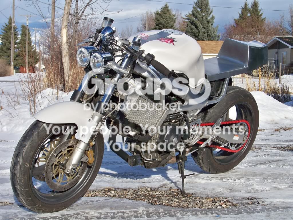

I wanna get some outside shot with the chain. It kind of gives a little color to the thing. I am thinking now about repainting the shock red to match the chain, but am not sure...what do you guys think?

I like that chain. Can't speak for painting the shock, but that's just me.

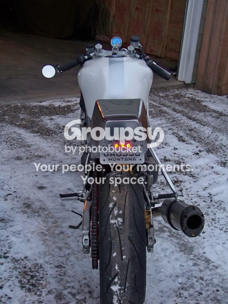

Itd be cool if in the future you could use a lcd screen or better (the future version) to display your license. Then at shows you could display some build specs or something fun. Like a home video or the movie "never been kissed". Whatever your into in the future
Re: Modern cafe, "Project Kool-Aid"...lots o' pics of the RADNESS!!
Oh the reflection in the aluminum inspired that. Nice bike!!
An LCD (or maybe even holographic) license would be really cool! Maybe some day it could happen... 8)

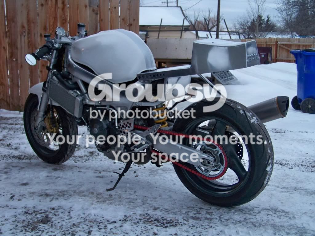

Well, I got the stinkin heater core done in about 6 hours, so I beat the book by 2. Everything went pretty well, but still not my favorite pastime. But that also means I got some bike time today! I took some pics as soon as I got home, since there was some sun then. Then I rolled it in the garage, and went to work. I cleaned up the front wiring, shortened harnesses, etc. Then I added a few trim pieces. I polished the muffler stay and started on the pipe. The pipe is going to take some work, and is hard to polish since it is a Ti skin. After all that, I bolted the gas tank on for final disassembly. Then I added some gas, charged the battery, and started the old girl for the first time in 2 MONTHS! Here are some pics of the progress, and a vid of the VTR running. The sound is kind of goofy; it seems that the camera pics up the high sounds too well. But you get the idea. All in all, a GREAT DAY!!!! ;D

sounds as good as it looks... always a THUMBS UP

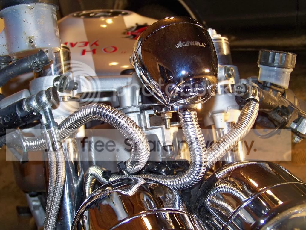

Can't see most of the work I have done real well, but you can see some. I really concentrated on the transition between the square front edge of the seat base and the round shape of the tank. I ended up radiusing the front lowere corners of the seat. Then I drilled speed holes in decreasing sizes to the rear of the battery tray, and added mesh to the insides of the speed holes. The diminishing holes help to give a little "flow" to the seat, and the round holes and radiused corners soften the squareness of the seat base. Overall, I think it ties together a little better. Beyond that I have been rewiring my LEDs. They originally had the resistors soldered directly to the LEDs, and these would break due to the brittleness. I sourced up some more resistors here, and soldered the resistor into a wire soldered to the LED. This gives a lot more flexibility, and should improve light life. Anyway, here are a couple pics of the project:
cleaned up front wiring
cause my LEDS and backlit Acewell are so cool!!
