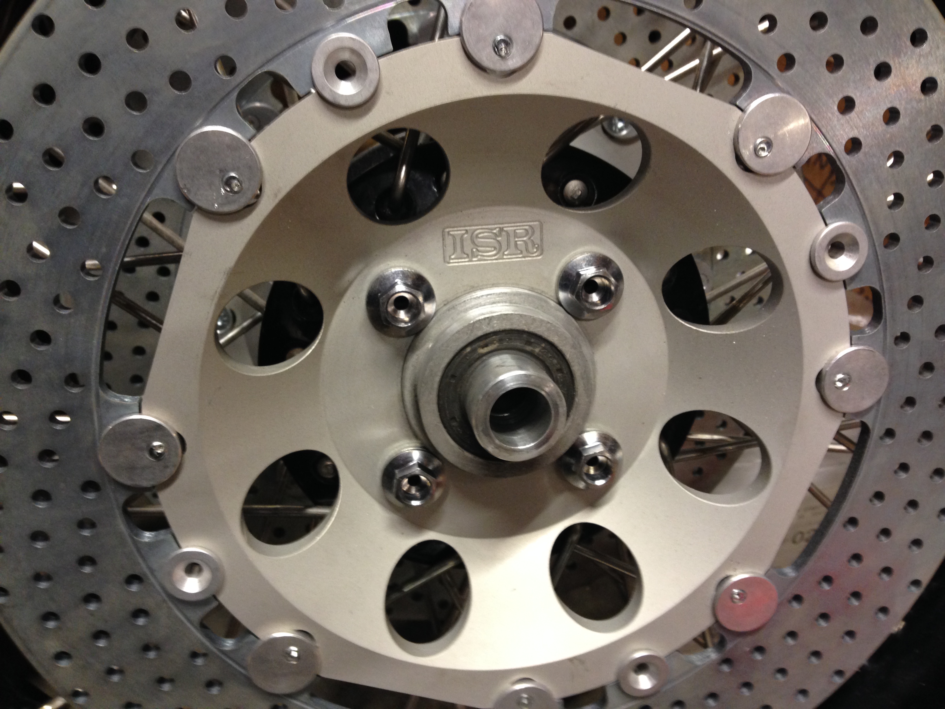

A member over at KZR recommended these bolts. they are gun drilled flange bolts from a first gen R1 caliper. Yamaha used them on many bikes over the years. the devil is in the details.

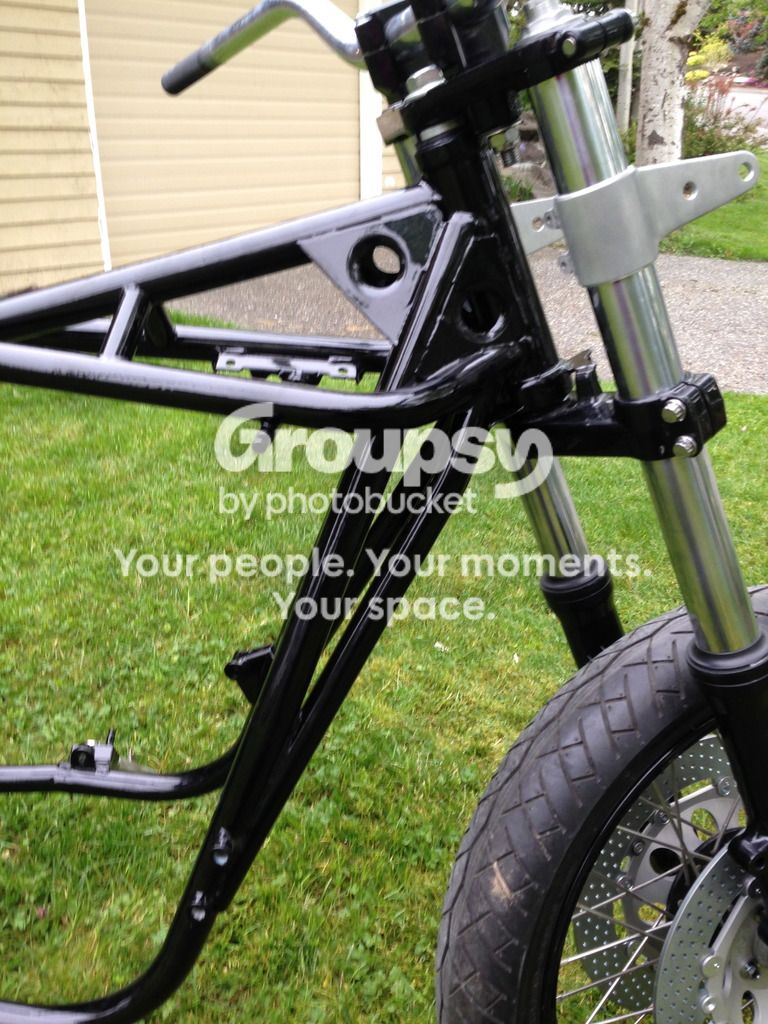

Some good news; I ended up powder coating the frame gloss black, and it was probably one of the smarter decisions i have made so far. White was just too overpowering for some of the other cool stuff going on, also a nightmare to keep clean. I also did my first bit of TIG welding on this and finished the foot for the kick stand. I still need to find a stainless ball bearing to weld on the end like the stock kickstand.
