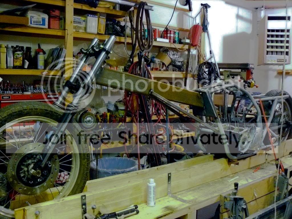

Been a while on this build. Decided to ignore CADD and just fecking build it. Modified GS100. 200 mph contender.
Crazy loves company.
I admire you building This, I hope it does take you up past 200mph. Any secrets going into the motor? any plans for a fairing?
Reach for it Brother I hope you make your dream come true.
...but DAMN that looks heavy as HELL and I am not seeing the benifit of so much iron.
Round tubing does is stronger in some regards, but our chief concern is for the up and down motion during high speed. At that speed we'd rather over engineer it than under. Bear in mind, we're venturing into uncharted waters in our books. In fact, we haven't found too many bikes that have stretched the front of the bike. Most of what we've come across have stretched swing arms and engine bay. As for the weight, it's not as heavy as you might think. I don't have the numbers at the moment as it's out at my dads place, but I recall us having this conversation, comparing the numbers and noting that the difference was minor. With the addition of a partial fairing (modified streamliner class) we should be able to get to or at least near to 200 mph.
