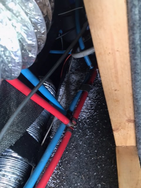

We discovered that it had been mouse invaded. The inside of the basement looked like there had been a blizzard in there! Little white flakes everywhere! Everything had to come out and be cleaned and back in behind the walls I discovered a block of Styrofoam that had been gnawed off on one end. Trapped a couple of the little bastards and got things cleaned up but even had to take the walls out of the basement area in order to get it all cleaned up.

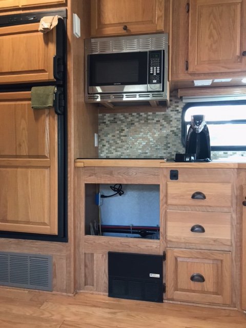

Now the fun begins! I mentioned before that we don't use the LP gas very much; occasionally turn on the furnace to take the chill off, but we heat and cook w/ electric so the gas stove was just taking up space, space in an area where every inch is precious. Here's the Before:
And here are some of the During:
I got some red oak boards and a friend is going to make a pair of matching doors that'll cover that opening and Prime Day provided a sliding stainless bin thing for pots n pans that'll be mounted in there.

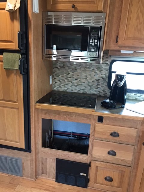

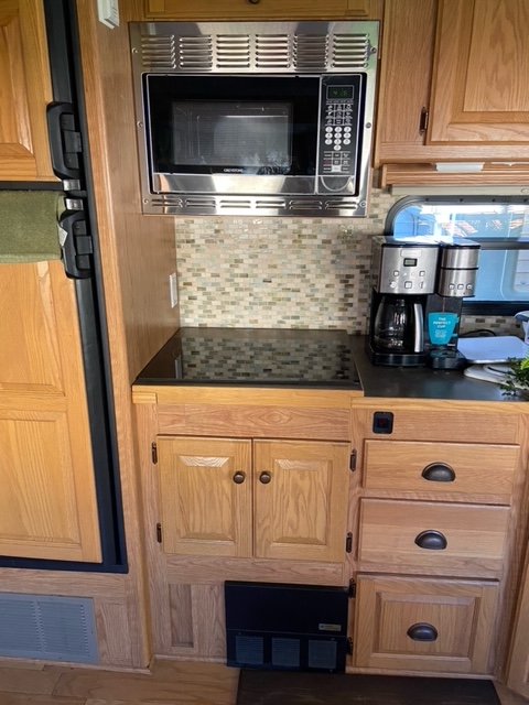

AND finally... the project on the trailer kitchen is finally done! I knew it was going to take my cabinet maker friend a while to get to get to my doors (and it did) but they are finally done and he did a fantastic job. Mrs Ridesolo did the stain and varnish and I got them hung this afternoon. To refresh, first is the before:
And here is the after. The microwave has been replaced by a microwave/convection oven. We removed the LP gas range and oven and got an electric induction cooktop.
Added a slider drawer for the pots n pans and the toaster.
As a surprise for Mrs Ridesolo I had my friend build a third door to replace the tambour door that we always thought looked out of place, didn't work well, and never liked. The thing was intended to stash the hose and tools for the central vacuum system and we don't like the thing and rarely use it. I took out the roll up and fitted a matching door. Before:
And after:

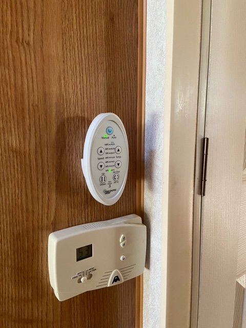

I mentioned Exhaust Fans above... The industry standard for most roof vents and fans is a 14" X 14" format. I believe that even the roof AC units, while they are larger than that, use an opening that's 14X14. This trailer has one AC unit and three roof vents. The one in the bathroom is just a standard vent w/ a single speed exhaust fan. It's pretty noisy but it's only occasionally needed so as long as it works I don;t need to do anything w/ it. The bedroom fan is a Fantastic Vent unit that was original from the manufacturer. I believe I'm going to have to eventually put a replacement motor into it but for now it works great. It's connected to a thermostat unit that can be set to turn it on and off and open and close it. There's also a rain sensor outside that closes the lid and shuts it off if it starts raining. It can also be set for in or out airflow.
The living room vent was only a screened vent that cranked open and closed and, because of the height of the ceiling in that area, could only be operated w/ a long handle; a major PITA, AND if we left it open and it rained there would be puddles to clean up. I started searching for a Fantastic Vent to install there and learned they are surprisingly expensive! I kept searching and eventually found a place selling them at what I considered to be a more reasonable price. I had some pix that I took while doing the switch-out up on the roof but they're gone now. It wasn't a difficult process, just time consuming, carefully peel off the old sealant w/o cutting the rubber roof membrane, take out the umpteen screws holding the unit in place, pull the unit out of the bed of sealant holding it in place, then clean up all of the old sealant. To put in the new one you wire up to the 12vdc power (I got that ready ahead of time), then lay down a new bed of the Dicor sealant, put another umpteen screws around then rim, then liberally apply sealant around the entire edge and over every screw head; this easily uses up an entire calking gun-sized tube of Dicor.
This new one is really nice! It's got a wireless remote that controls everything and also functions as the thermostat. There are a total of 20 fan speeds in manual mode as well as thermostat control and, of course the outside rain sensor. The fan motor is much quieter than the older unit and the open and close speed is amazing. All-in-all, a very nice unit and well worth what I paid for it.

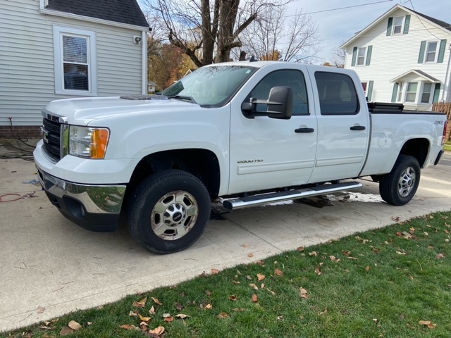

Three days before leaving we had a major event! Completely by chance we came across a new tow vehicle. We hadn't been actively searching but have been keeping our eyes open for a more heavy duty truck. Completely by chance we discovered one for sale out side of town and checked it out. Its a 2011 GMC Sierra 2500HD, 6.0L gas with <53,000 miles on the clock. Original owners and "good people," they took very good care of it; the interior is like new and the exterior has a couple of very minor issues. The clear coat on the OEM aluminum wheels has given up the ghost so I'll either have to find a place to recondition them or get new wheels. It's had professional and regular maintenance and has new tires and brakes. The only bad news is that I got it such a short time before time to leave that there wasn't time to get the 5th wheel hitch mounted in it. So, it'll spend it's winter sitting in the driveway rather than enjoying the nicer weather on the Mississippi Gulf Coast.

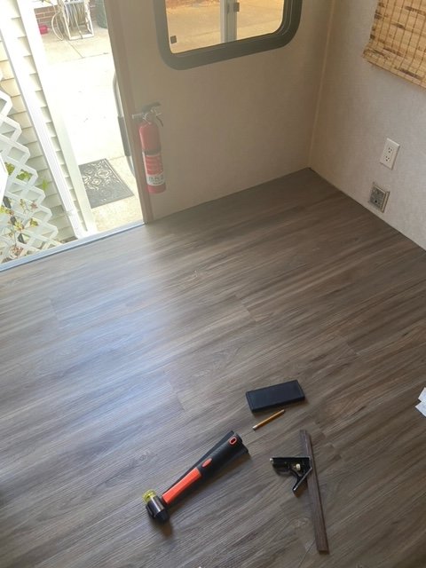

Well, for various reasons, largely because we have to replace Mrs Ridesolo's car soon, we decided not to go the motorhome route for another year or two and decided to put more into the Titanium. The lady of the house wanted new flooring, new lighting, and new furniture. A search at a local Habitat for Humaniaty ReStore gave us about 200sf of vinyl plank flooring from a high-end manufacturer for about $1sf so the carpet and wood flooring, both pretty well worn out, came out and I got OJT on installing vinyl plank flooring. Of course YouTube helped.
