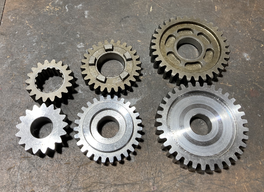

i rang the gear man yesterday to see if he'd got anywhere with the gears, and he'd rough machined the blanks. he sent them to me to have a look at, but really i don't know wtf i'm looking at in terms of whether or not they'll cause any issues. the idea is to add a tooth to 1st driven and 6th driven and take a tooth off 2nd drive - that way it'll have a lower first, less of a gap between first and second and taller sixth. first and sixth are large enough, but the second gear drive side is only 18 teeth, and going down to 17 makes it a bit more extreme.
but they seem to be ok. i figure there's only one way to know, so might as well give it a whirl. i'll send them back with the shafts so they can do the final machining and then it's another step closer to getting it into one bit.

That looks REALLY expensive.
From what I've learned about gears over the years, looks like a modified developed tooth form?
Because you have fixed centres it isn't possible to add a tooth to one side without reducing count on the other meshing gear so it's doubtful any of the teeth are a standard profile (either DP or Module)
Probably with modern computer generated stuff it's way quicker and simpler than it was 20~30 years ago but cutters still need the generated profiles (although with CAD, CAM and CNC not such a major deal as it was)
In the last pic, a lower pressure angle of 30 degrees?
The important thing is the centre distanced between various shafts
depends what you call expensive i guess. he did quote me, but i've forgotten how much it was now, a few hundred each maybe. i don't really see it as that relevant. the cost is long forgotten when the result is right.
the gear man did explain it all to me, and he says some of the profiles are already heavily corrected - the little pinion gear is nowhere near a std form i think he was saying. but i trust he knows what he's doing, that's what he does.
....Because you have fixed centres it isn't possible to add a tooth to one side without reducing count on the other meshing gear so it's doubtful any of the teeth are a standard profile (either DP or Module)
While that is generally true, it is quite common to have different combined tooth counts across a shaft with variances of up to 3 teeth different. Let's say the combined totals is 52t, that means they can cut 51 or 53 as long as the diameters are close enough. On the GT750 Suzuki change one gear by 1 tooth and did not change the matching gear. It's a gear cutting trick that I would guess that Brad's guy knows how to do.
It's easy to end up with too much backlash or too little clearance, but a good gear guy should be able to make it work.
And yes, having gears machined or even repaired is not cheap for most of our budgets. On some bikes like the GS series Suzukis it's possible to swap gears in from different models or to mix and match gears on stock shafts but it still requires shafts and sometimes bearings have to be machined to make it work. For that Ducati I have no idea what the options are, but if anyone does it's Brad.
